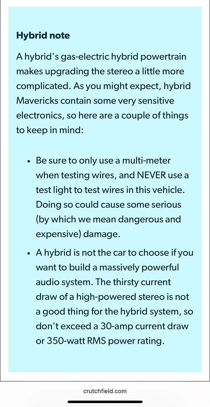

Well. This has come up before. One source is Crutchfield, and they say something to that effect in multiple places.
I’m not saying they’re correct, just that there is precedent…
So if they spout the wrong thing multiple times it must be right? The Ford service manual quotes the max output of the DC-DC converter as 265 amps. The Ford Vehicle Modifiers Guide suggests typical vehicle load of 95-110 amps. So there's about 150 amps (or over 1850 watts) of output available.
