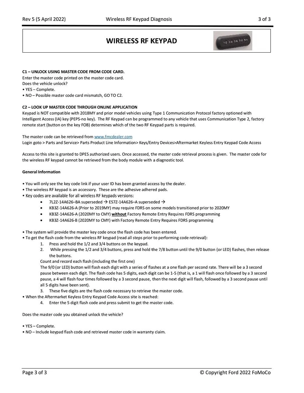

So I guess the key code printed on the instructions didn't work......bummer. Sorry if I came off a little sharp that wasn't my intention. Hopefully you can get this figured out. I wish I could help you more but it seems like this will be on the dealer with FDRS access to get it figured out for you.
I found the resolution. this seems to be working thus far...
Ford Maverick 2025 securicode keypad issue 1000033170
anyone have access to fmc dealer by any chance? I got my flash code.

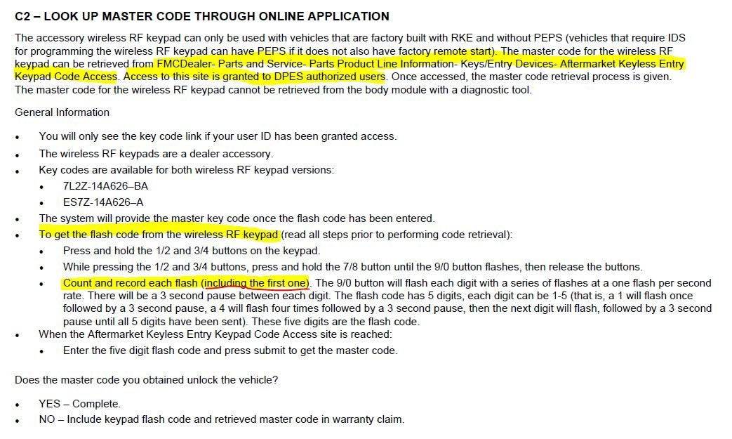

The OP doesn't have the master code which is step one in the instructions you posted.
Read further, if NO proceed to C2 which is retrieving the master code.

At least with the flash code the selling dealer should be able to get the code for you. Of course that won't be until Monday, but at least your efforts will help get it straightened out.

Just by having an FMCDealer login doesn't give you access to vehicle key codes. There's a certain procedure used to get that information. When I worked at a Ford dealer the parts manager was the one who was authorized to do it.
good to know. wonder if parts is open on Sundays

now that makes sense. you don't want just anyone in the dealership able to essentially reset a key.
