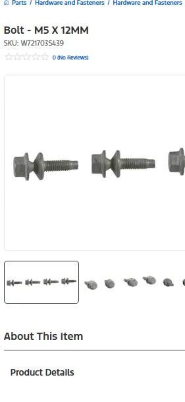

@DS_Ohio you nailed it, here is a picture of the bolts they use and of course the round part is what’s left after the install and they head is broke off after they torque them.
That's diabolical! I'm having the dealer, install my perimeter security system for less than $70. It's on order now.

@Robot-Wrangler Id be curious how they deal with the security bolt and gateway plug. I got the cable for Forscan in the other day and I’m just waiting on the perimeter plus module to get here tomorrow.

The dealer is waiting on the part and will call me when they can schedule an appt to install. I'm guessing a tapered nut extractor would be their weapon of choice. I'll ask the tech when I bring in my truck.

Do you have any tips on how to remove the security screw?
