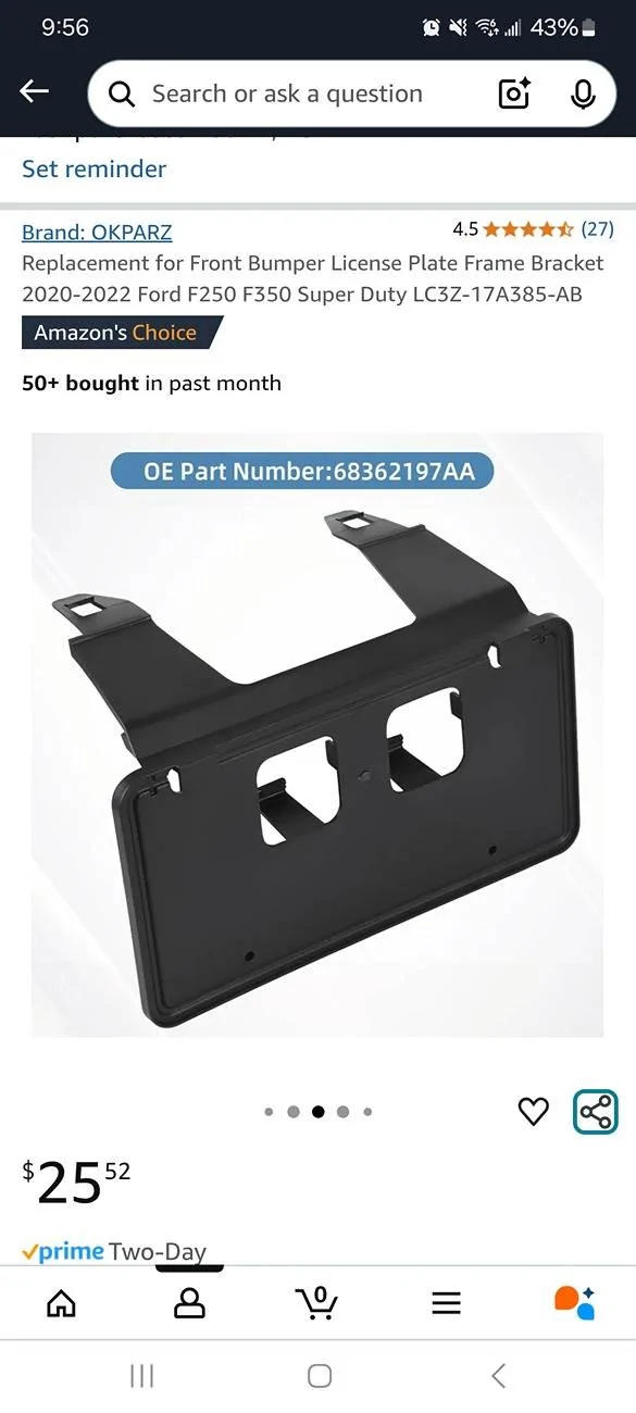

dhill59, what brand bracket is that? Mabett, or something else? Thanks.
It’s the factory bracket held on by heavy duty zip ties.

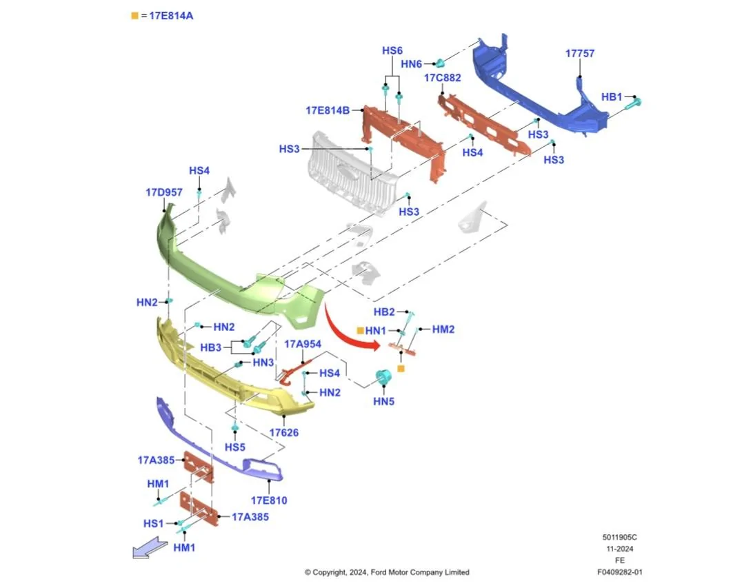

Ahh, I see. Thanks. I did find the Ford exploded view of how their bracket (17A385) is supposed to be mounted, but it looks like it attaches to the inner fascia (17D957), not the outer (17626). As long as your easy solution doesn't interfere with the front camera, I'm inclined to do the same.

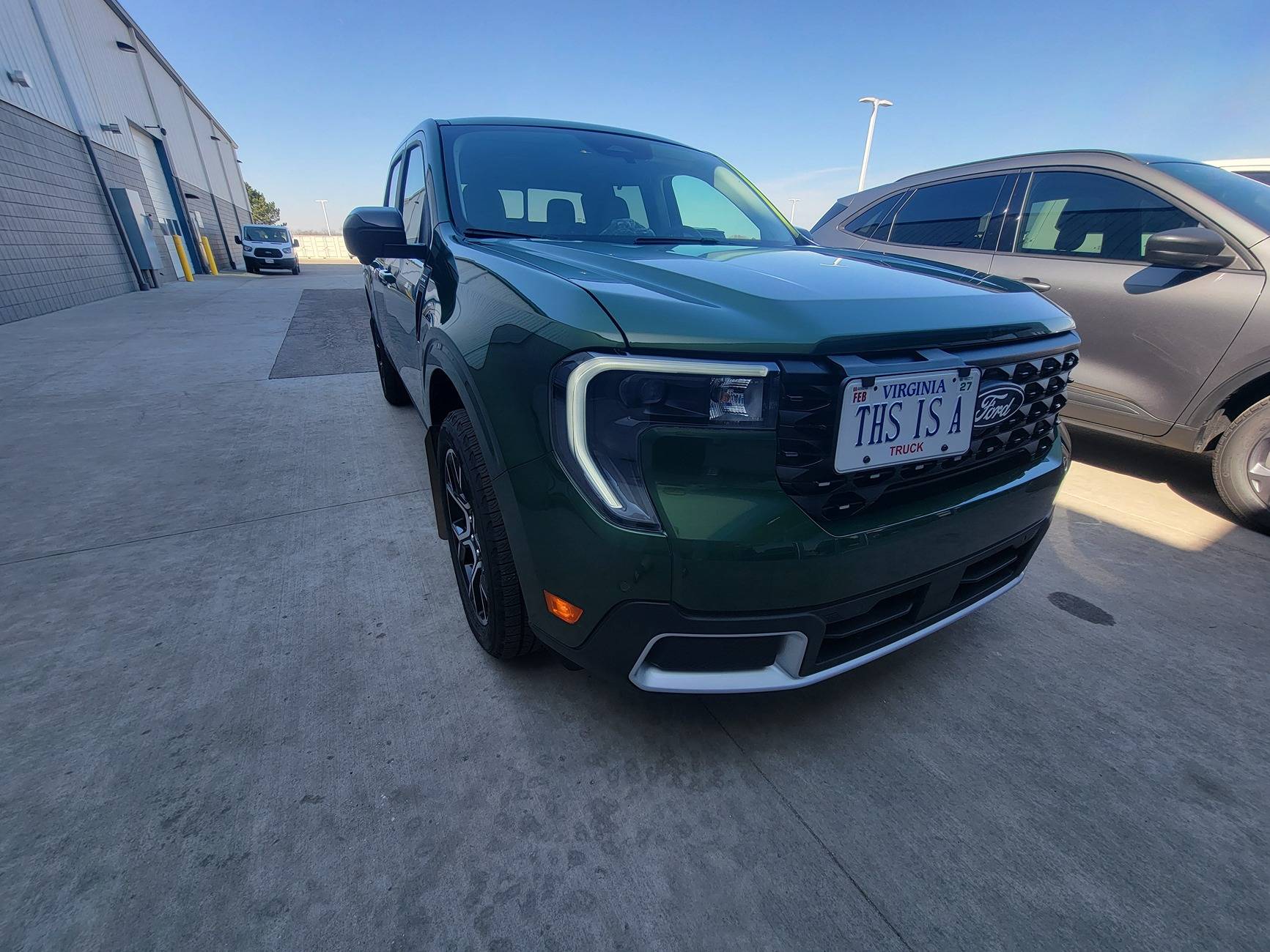

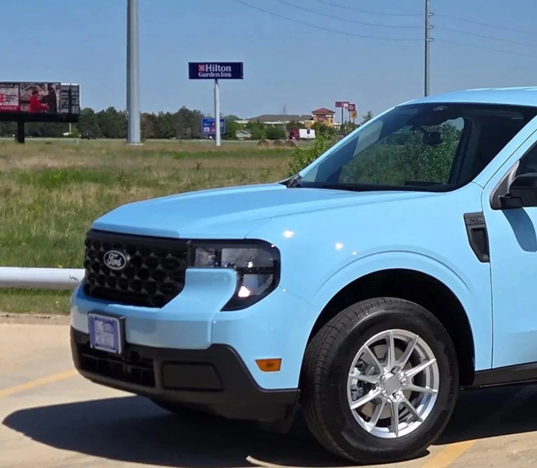

My son was pulled over here in Texas for no front plate. He now has it on the dash where you can see it through the front windshield. My wife was also stopped as she had on a plate cover that changed the color of the front plate. Also in the Lariat mounting to anywhere other than in the middle of bumper where Ford indicates will interfere with collision and adaptive cruise control sensors.

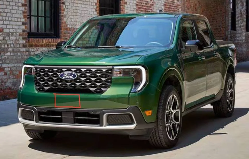

This appears to be the four designated location for the front license plate on a 2025-26.
