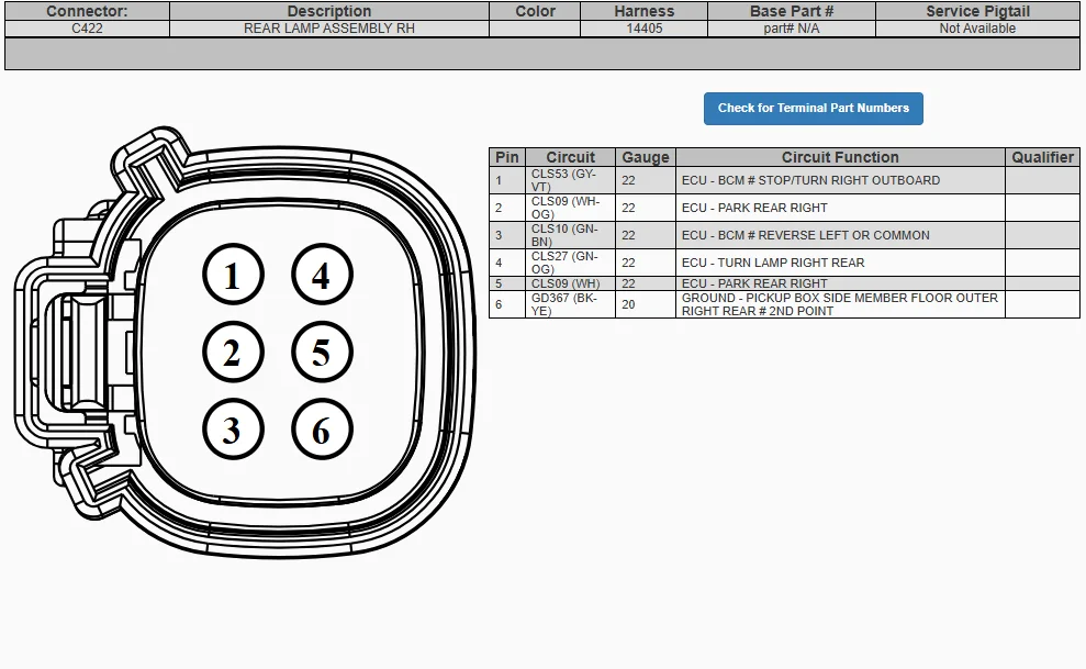

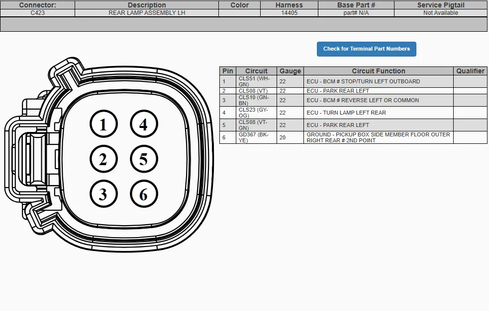

Does anyone have access to the pinout diagrams for the various 25/26 models? I know that the housing keying is different on XL/XLT and Lobo High 702A, compared to 22-24, but I haven't been able to determine if they've moved any of the wires to different pin locations. I know that Lobo 702A uses a 6th wire (pin #4) that was not used before, just trying to confirm the other locations. I've got a harness in-bound with the type B keying, that I may offer to someone if they want to try it for a tailgate light bar.

Here ya go
Ford Maverick 2025/26 Tail Light pinout schematic 1770672976260-ut
Ford Maverick 2025/26 Tail Light pinout schematic 1770673044345-c7
