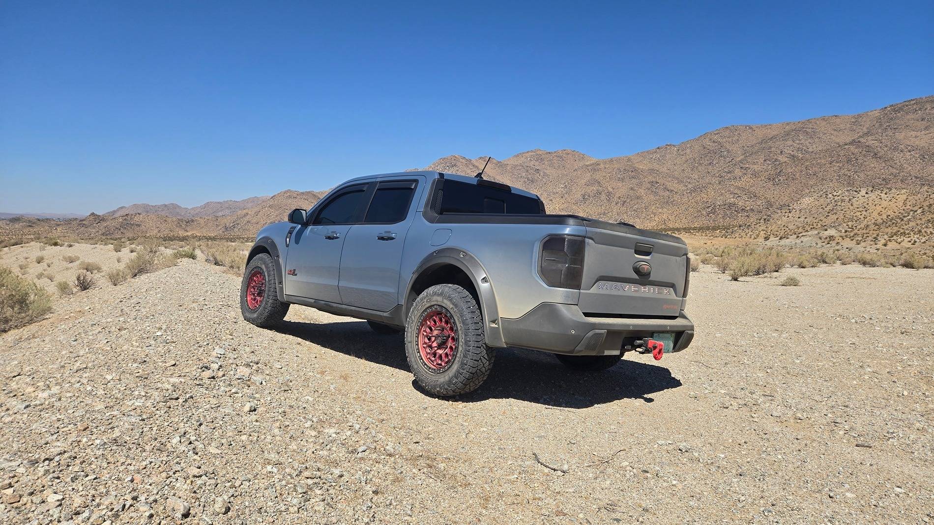

Looks great and will stand out in the crowd. It's nice that you get drivability benefits to go with the looks.

Thank you! It sees dirt almost every single day so the benefits were well worth it!

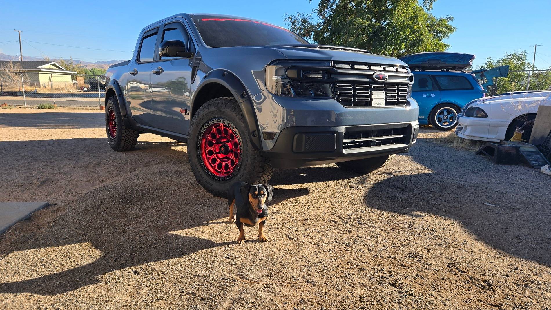

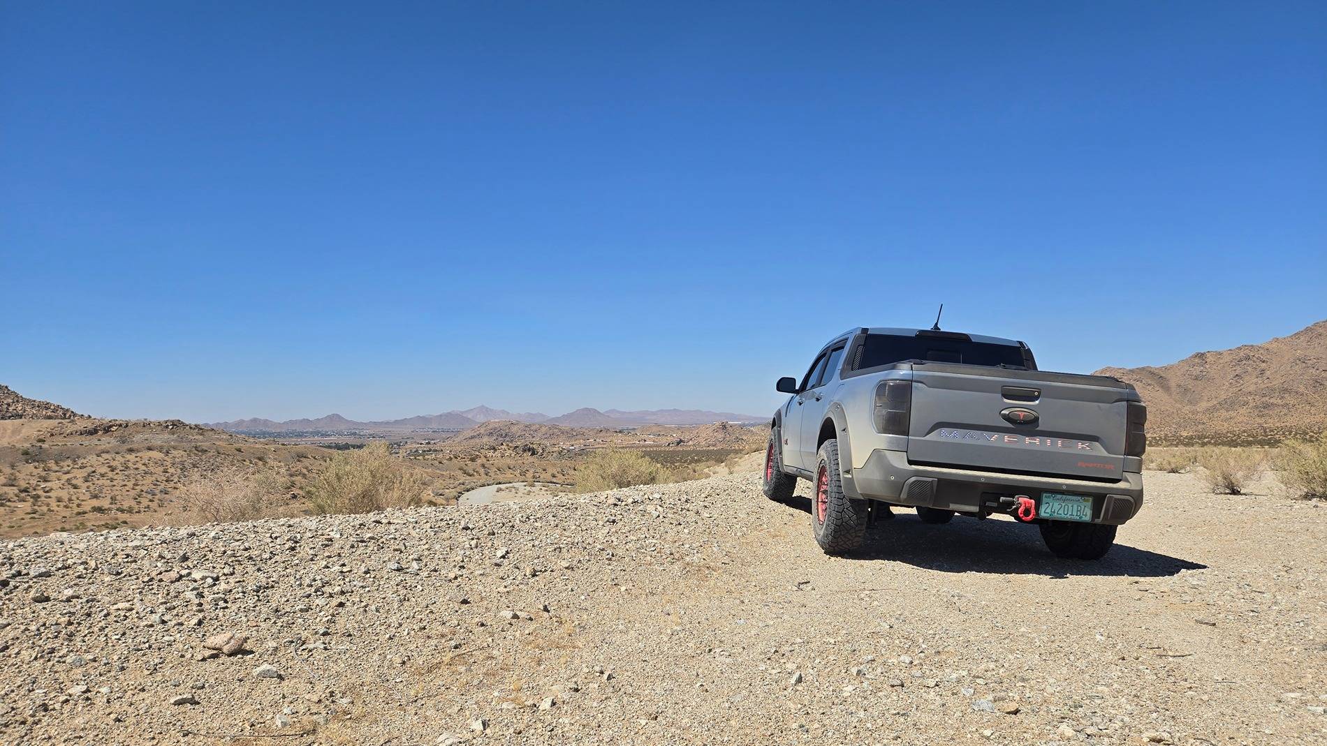

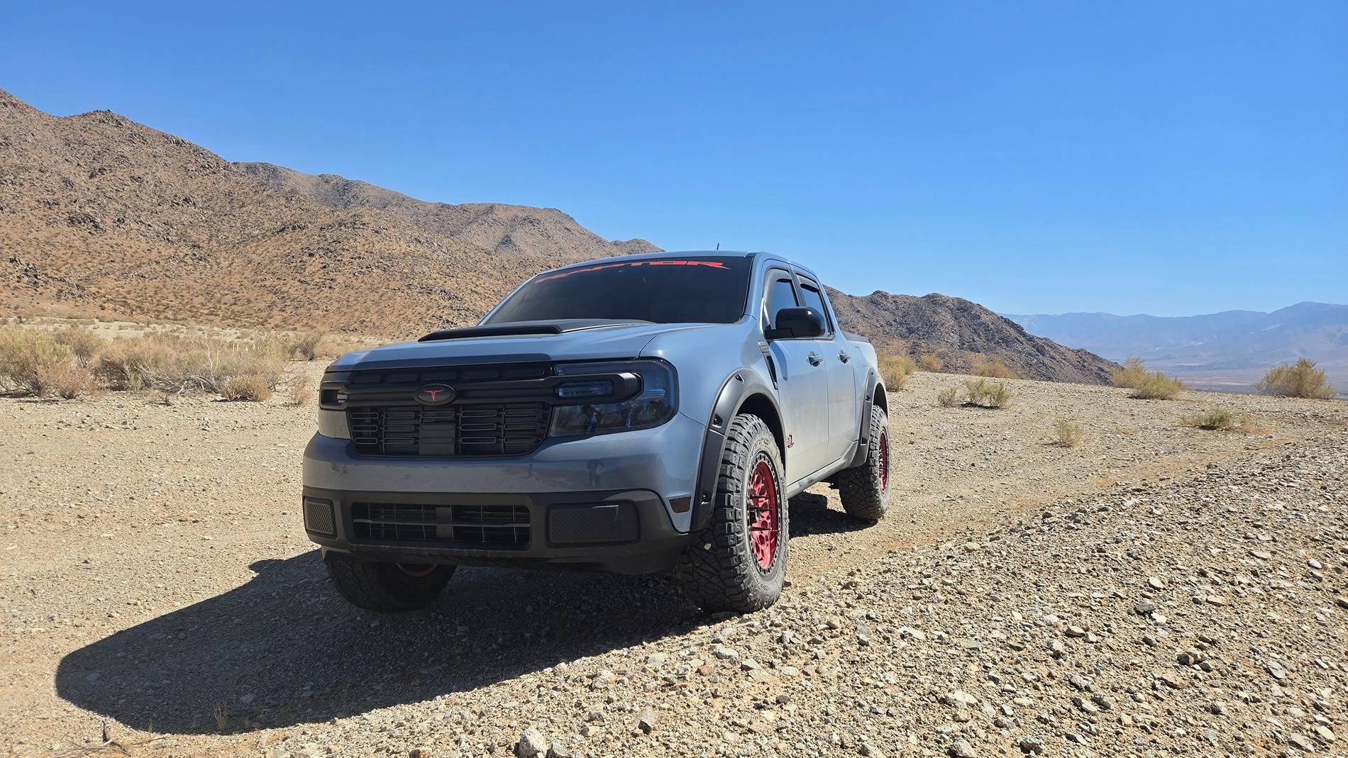

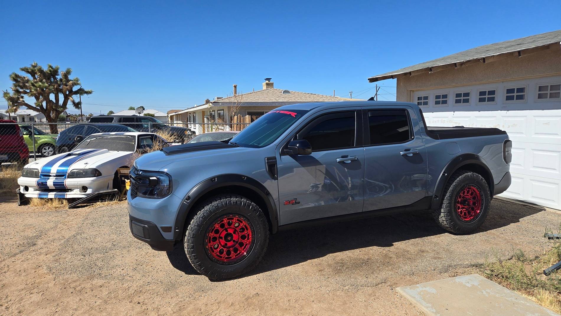

2024 Maverick Lariat hybrid Azure Gray Metallic (Nikki)
- 2 Inch Level Lift Kit (FWD/Hybrid)
-Fittipaldi Offroad FT101 18x9 +18mm, 5x5.5 Candy Red Wheels
-255/70 R18 Nitto Ridge Grappler Hybrid Tires (32 inch)
- WheelsAdaptersUSA Hubcentric 5x4.25 to 5x5.5 (17mm front, 32mm rear)
- True Spike Valve Stem Caps and 4.5 in black Spike Lug Nuts m14x1.5
-Bushwacker Fender Flares
- Ford Air Design Satin Black Hood Scoop
-Smoked Tail/Head Lights/ 3rd Brake Light/ Side Markers
-Ceramic Tint 45% windsheild, 15% front windows, 5% rears and back window
-Flowkottu Retractable Hard Tonneau Cover
-Autmatch 2 Inch Shackle Hitch Reciever w/ Lock
-EGR In Channel Vent Visors Matte Black

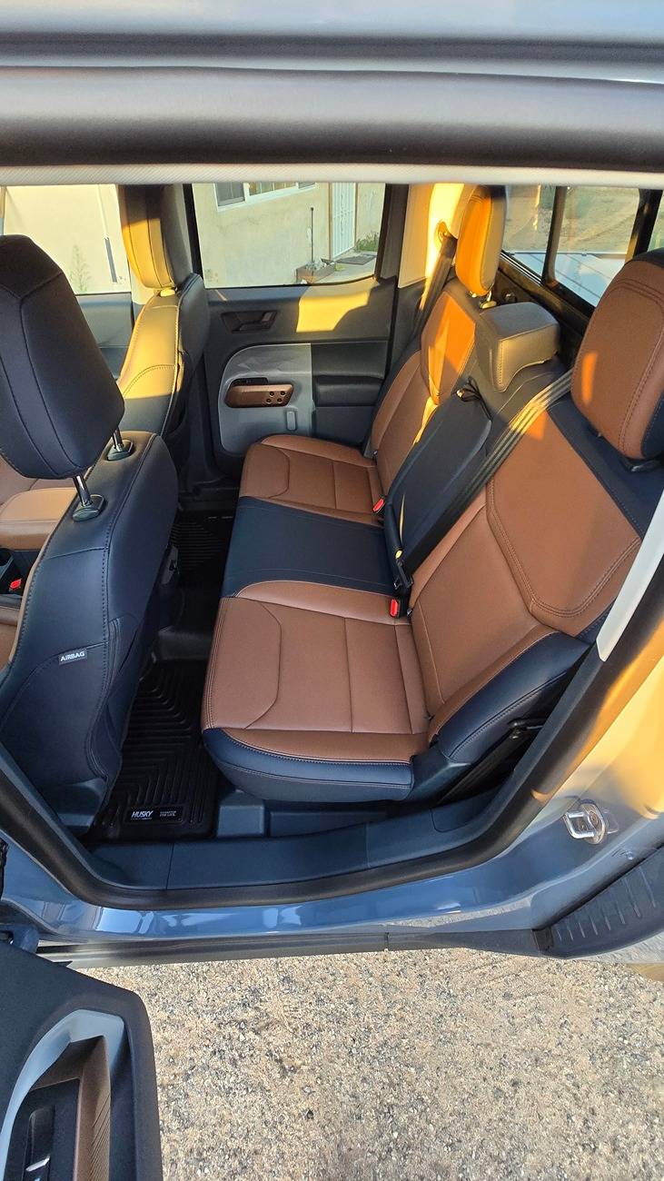

-Husky Liners Weatherbeater Floor Mats
-Pigenius Form Fit Window Shade
-Tufskins American Flag Tailgate Letter Inserts
-Tufskins Maverick Door Sill Protectors
-Grille/Bage blackout
-Maverick Badge Swap
-Bedside Decal
-6.2L Emblems
-Raptor Window Banner
-Luxury Dog Seat w/ Straps
All Mods Installed Within First 30 Days of Ownership
On the way
-Zencarbonfiber Custom Flat Top/Flat Bottom Reflective Copper Carbon Fiber Steering Wheel/ Suede Trim
-3 foot Smoked Light Up Buggy Whip and Flag
-Buggy Whip Tailgate Mount
-Ford Performance Red Hood Scoop Decals
-Raptor Tailgate Emblem/ Bedside decals
Going to buy
-Satin Black Roof/Side Mirror Wrap @Menacewrapped
-Roof/Windsheild Pre runner Style Light Bar
-JCR Off Road Hood Mounted Ditch Lights
-Diode Dynamics Elite Fog Light Kit Yellow
Want to do
-Prerunner Style Front Bumper with Winch and Bash Bar
-Pre Runner Style Rear Bumper
-Rock Sliders
***Front Wheel Studs, Front Pinch Welds and Inside lip on Front Bumper NEED to be Trimmed or it WILL Rub/Wheels Wont Fit***
***MPG went from 35 stock to 30 modded. 5 MPG loss***
Total Mods are Right Around 8k with the Going To Buy List.

I have zero complaints so far. If you position the mounts properly the bedrooms are fully operable. No tricks or difficulties on my end. And I prefer the way this one is raised up a little vs the other one but that was personal preference. Overall super happy with it.
