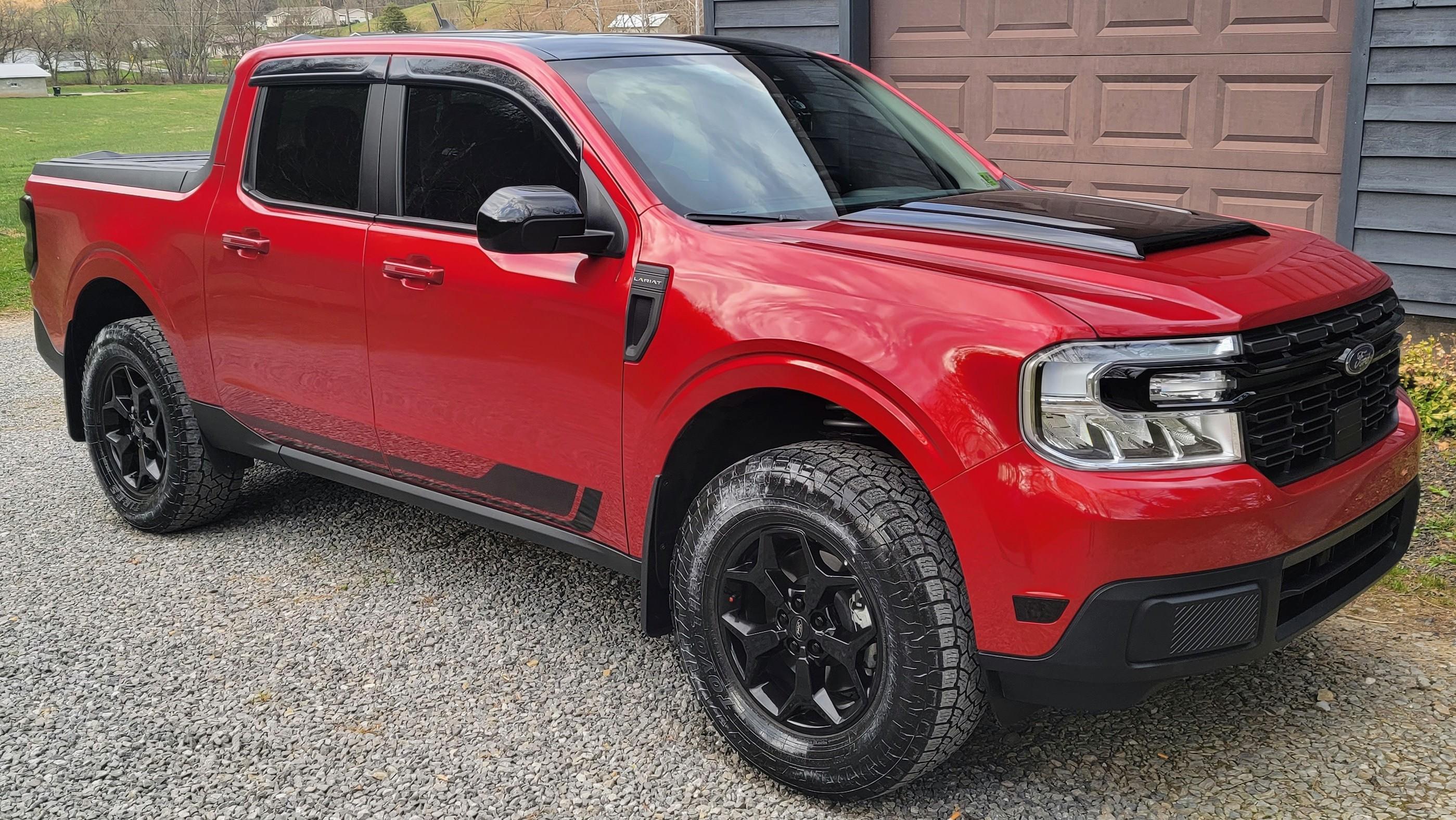

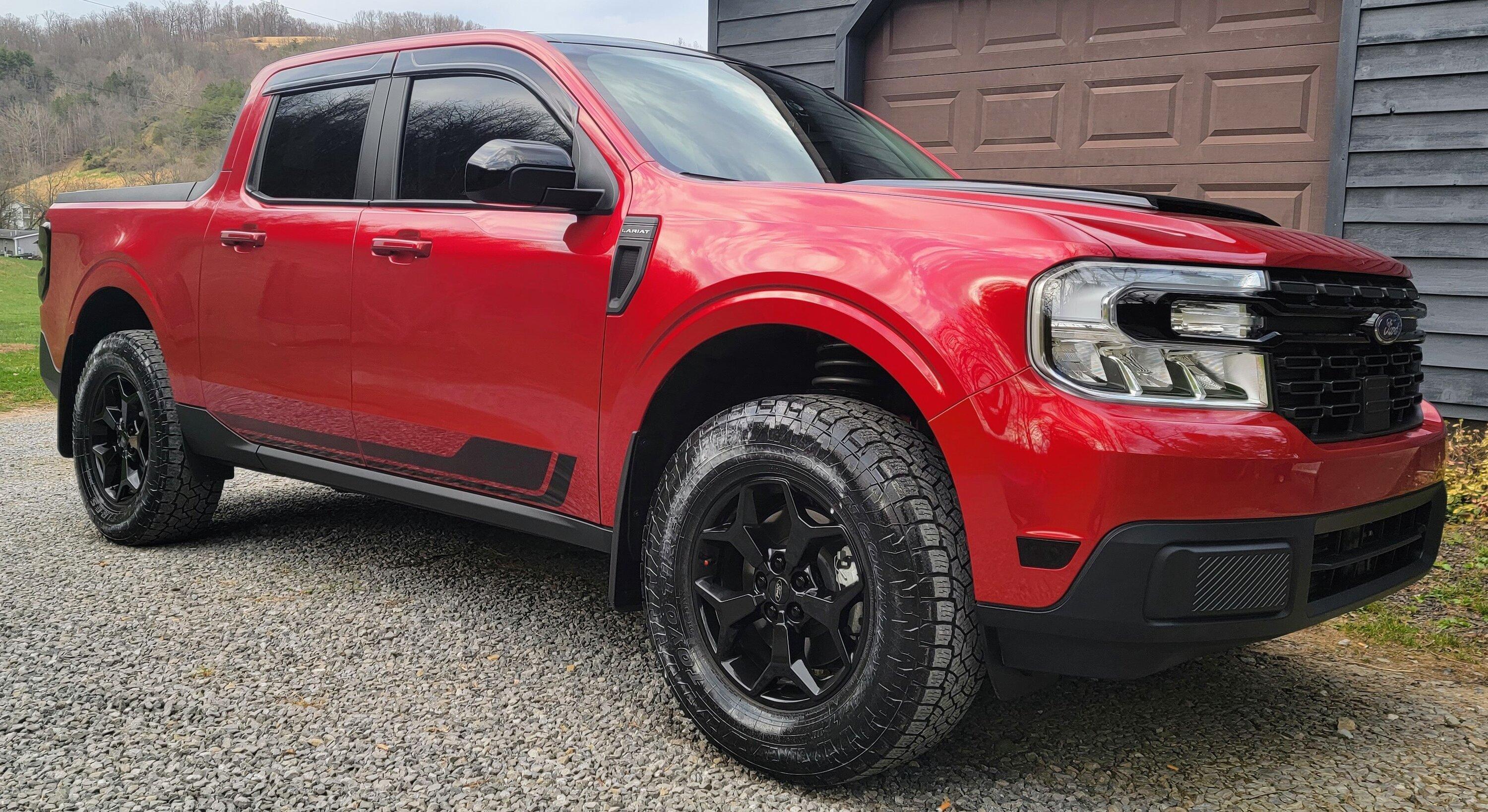

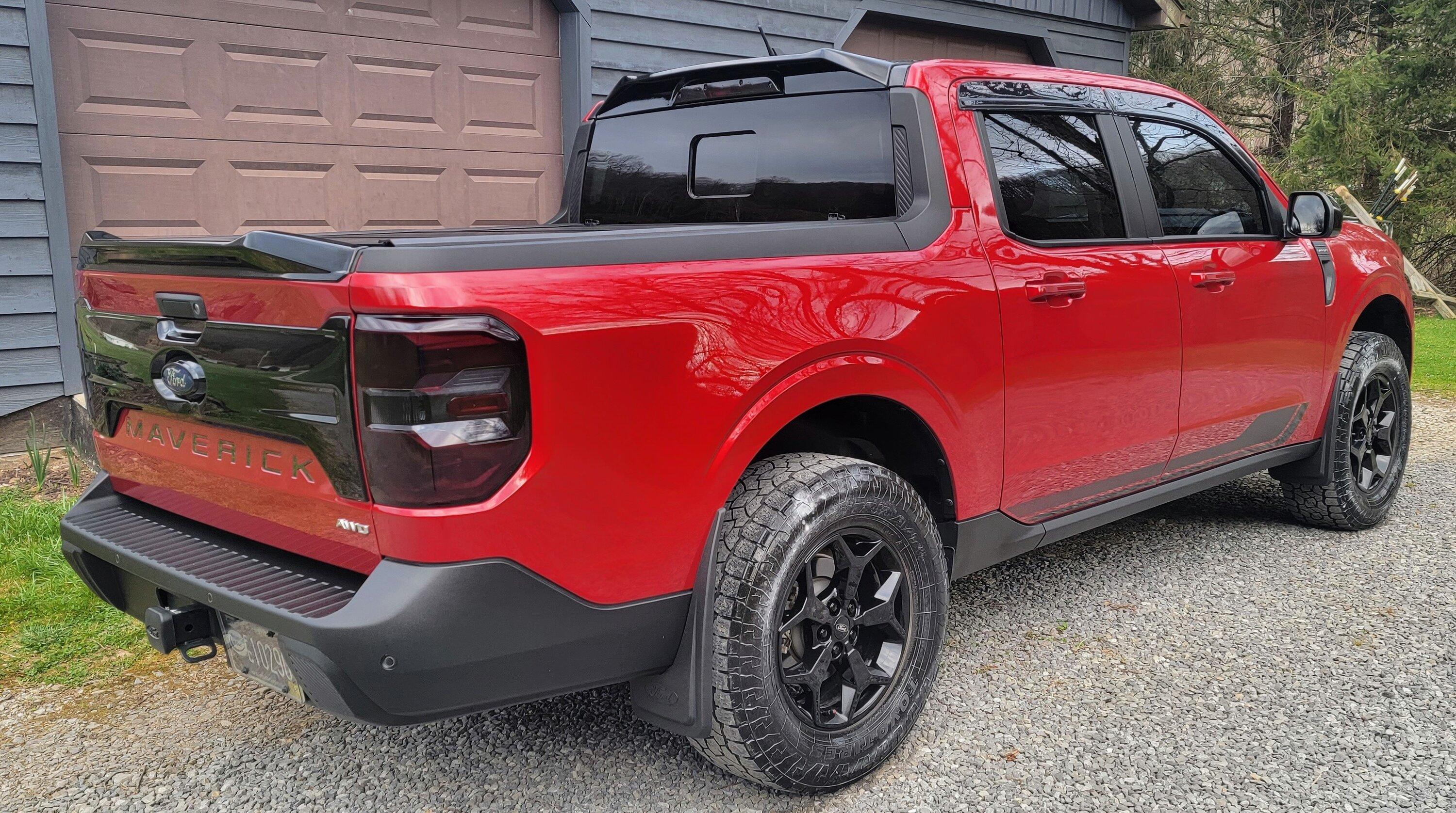

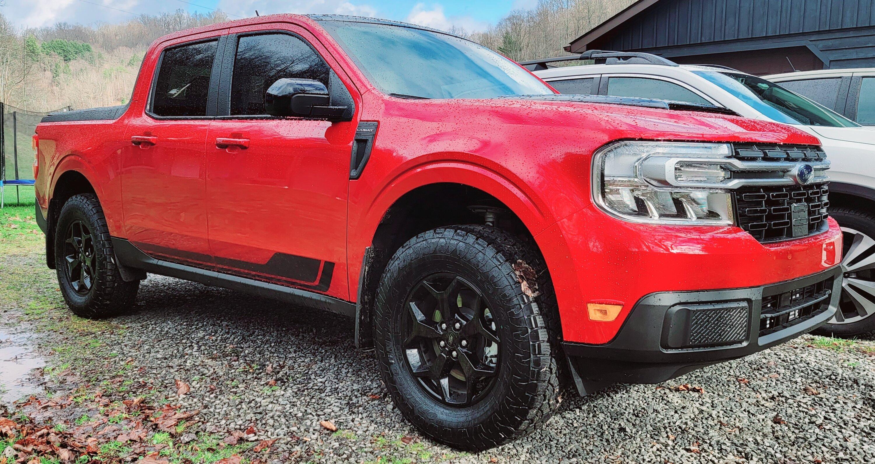

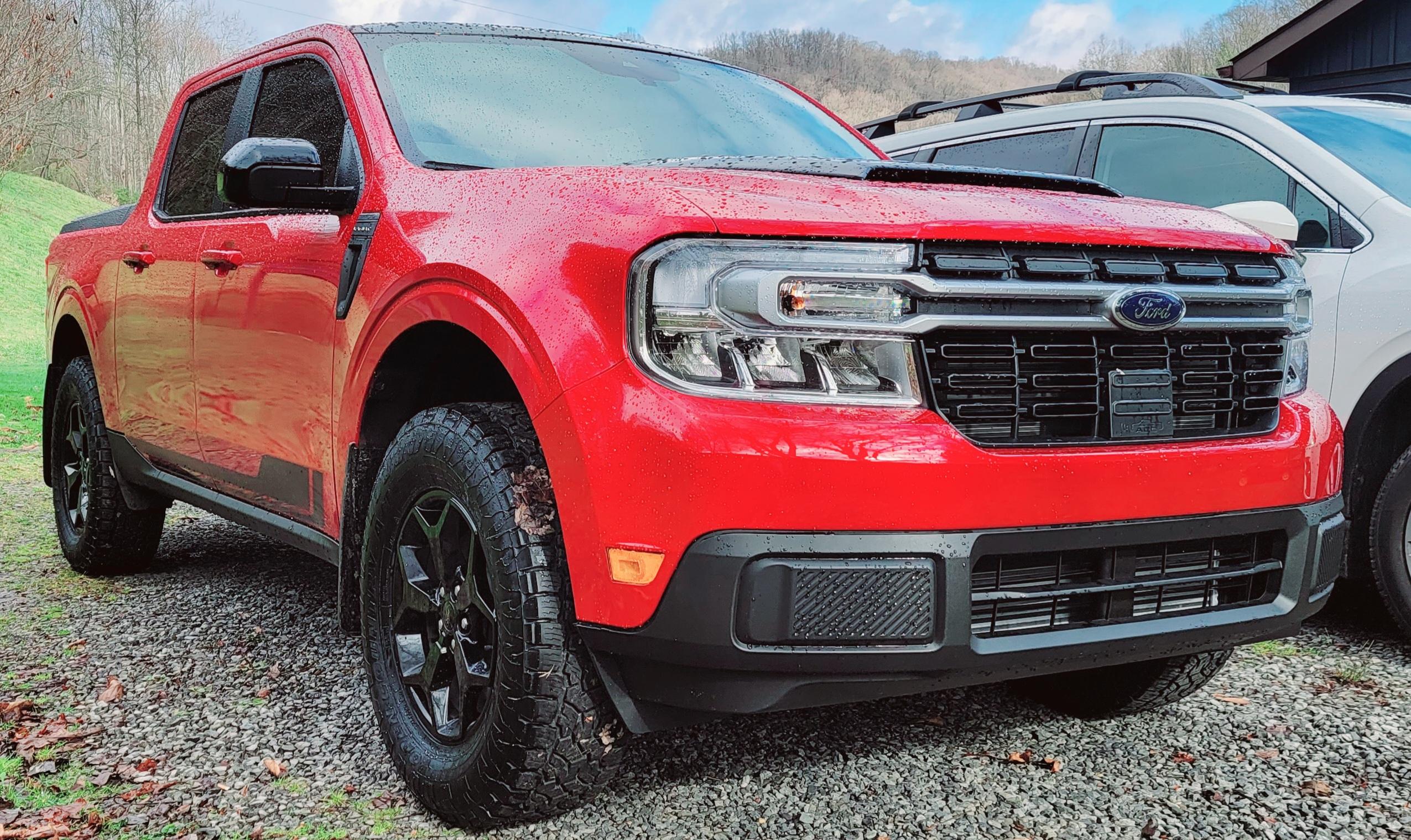

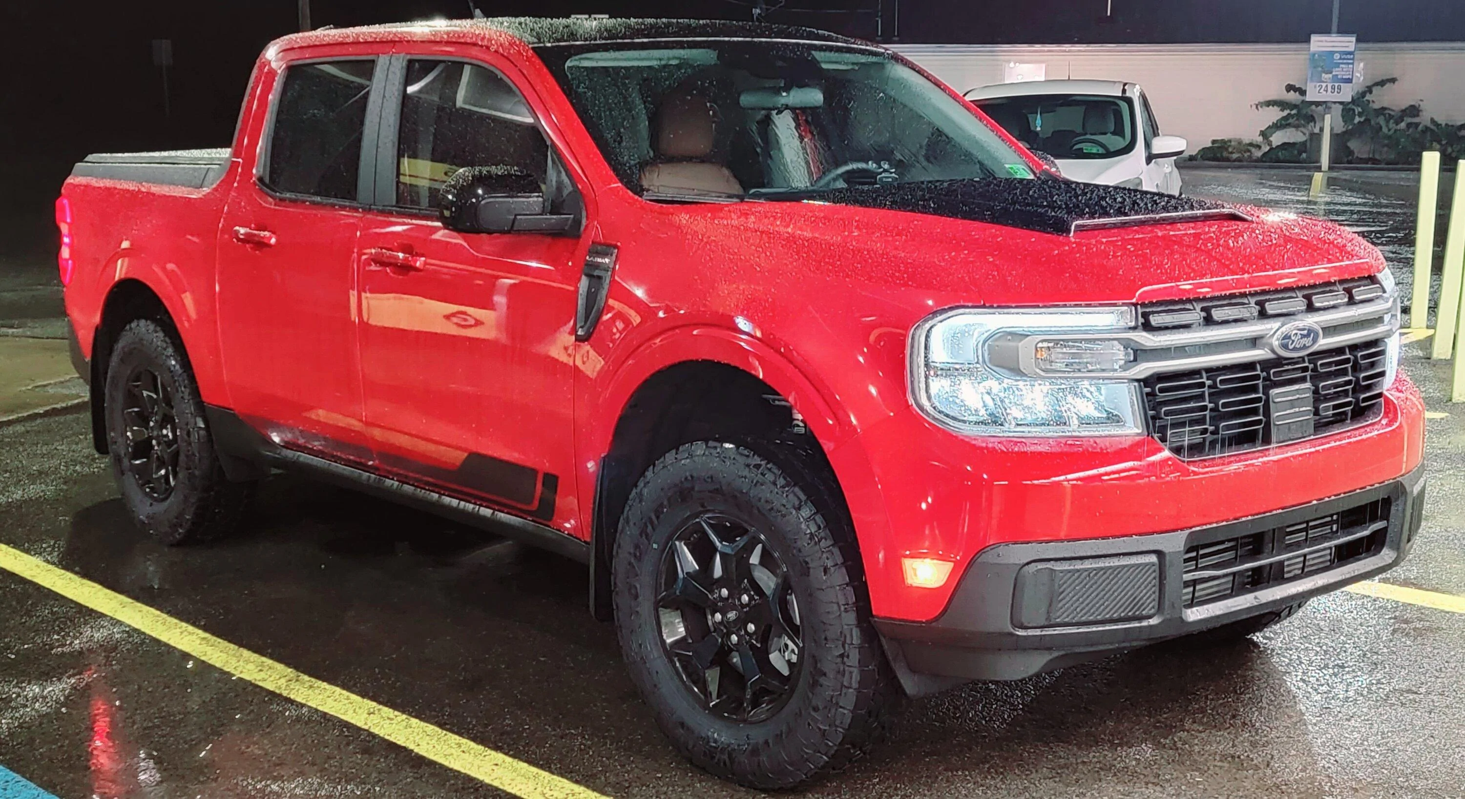

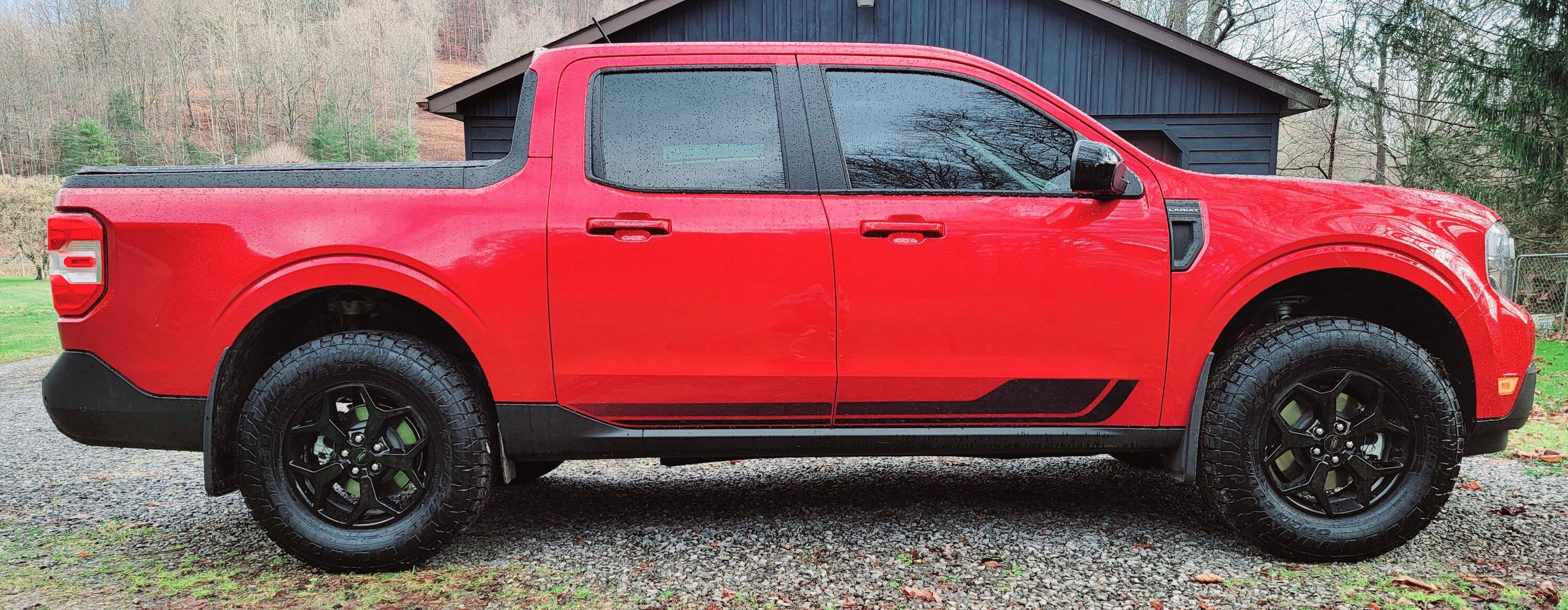

2" Lift with 255/70r17 on First Edition Maverick Lariat.
It was rubbing on the unibody seam where they spot welded it together but I bent it over with a 8lb sledge and now there's slight rubbing on the felt liners at full turn but nothing you can't get away with. Nothing like beating on a truck with a sledge hammer that I've owned for less than a month with only 800 miles on it. I work at a ford dealership and had it up on the rack after hours Friday night beating on it and techs were walking by saying that's some redneck s*** and I live in West Virginia. It's only a temporary fix to a permanent problem, I'm going to have someone more skilled than me cut the seam off and weld it back together flush in the near future for a neater more professional finish.Looks awesome, any wheel rub?
