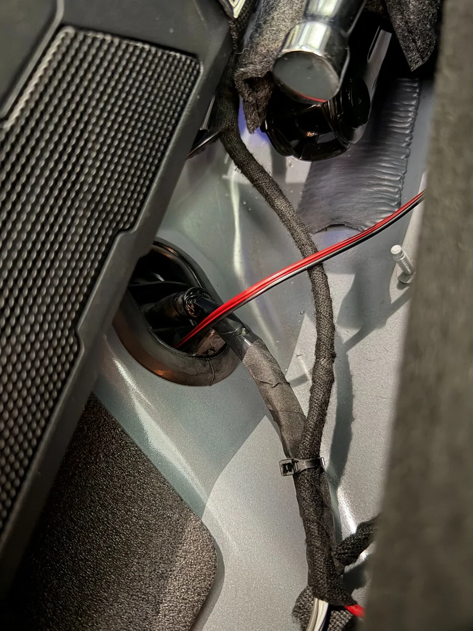

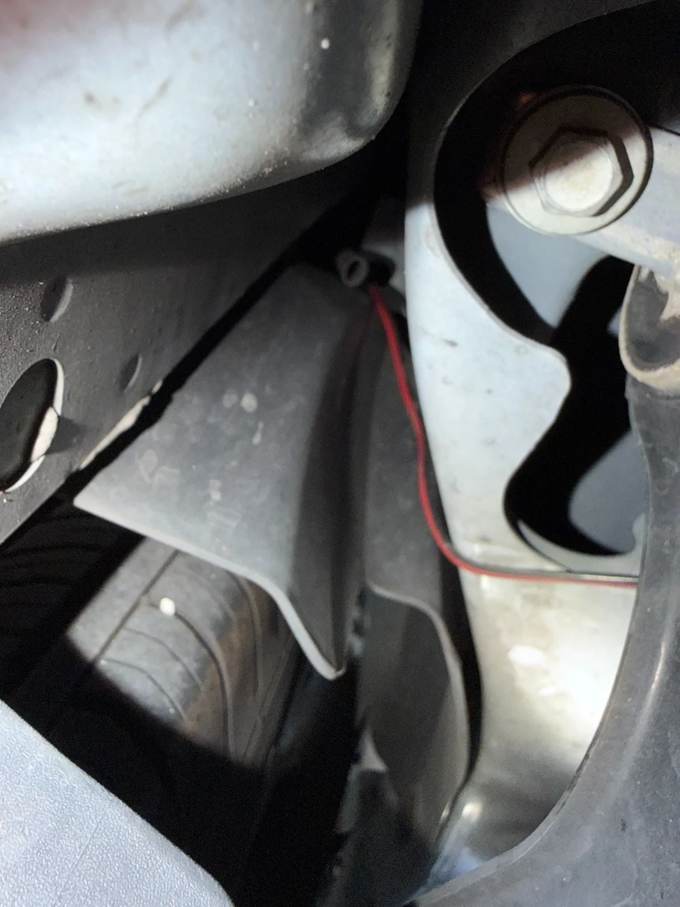

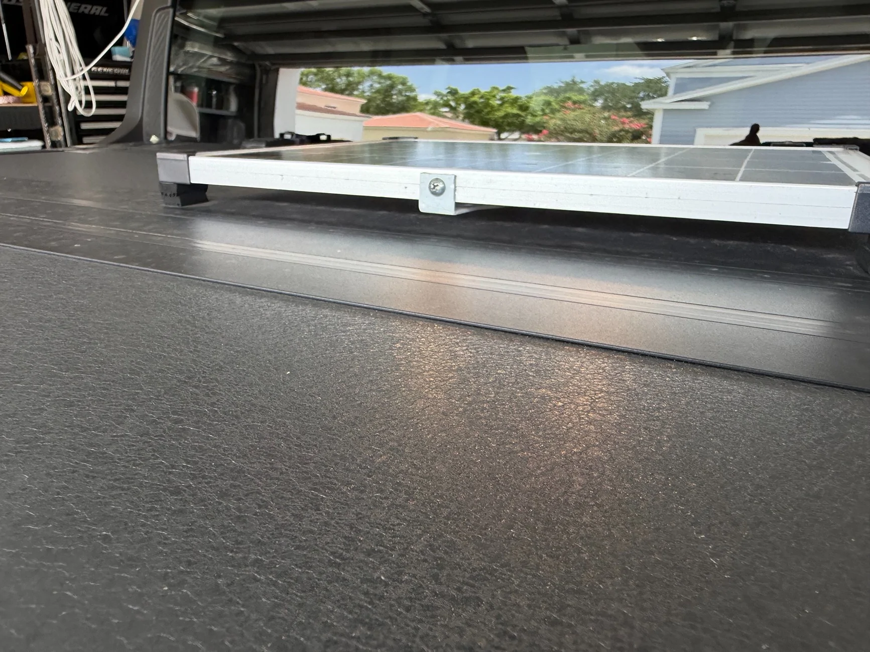

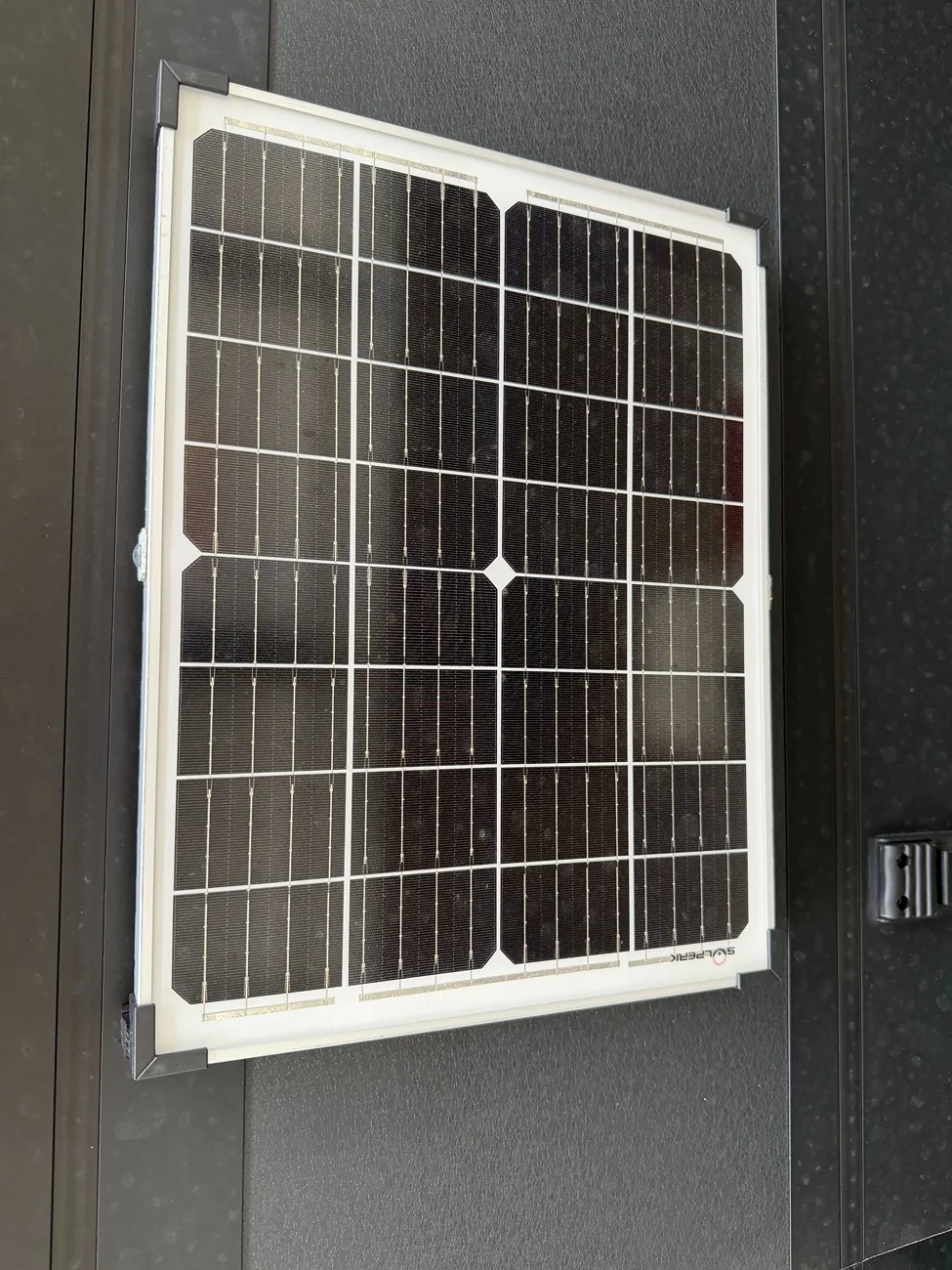

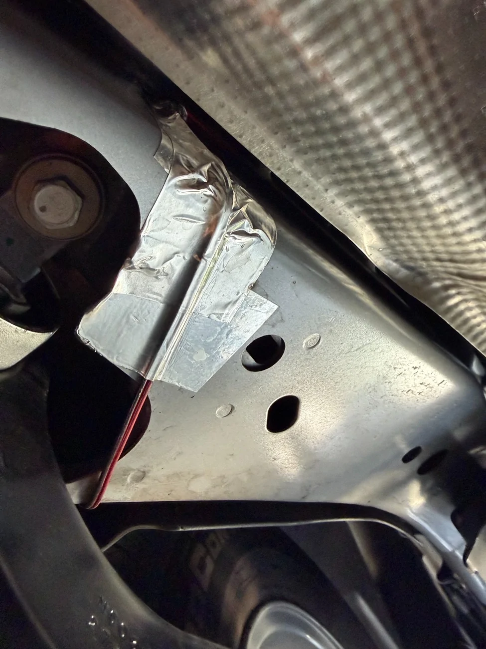

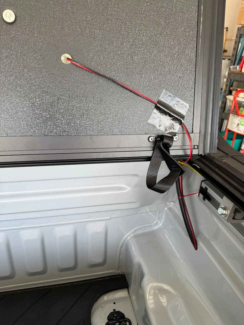

I got a 30W solar panel from Amazon that stops charging automatically when the battery is full. This particular model has a metal frame and metal bracket with a single point installation hole. I installed the panel on my tonneau cover with some rubber gaskets and drilled a second hole for the wire. I used silicone caulk to seal the wire hole. I routed the wire through the drain hole in the side of the bed. I used some metal airduct tape to tidy up the wire around the bottom and to prevent any chafing.

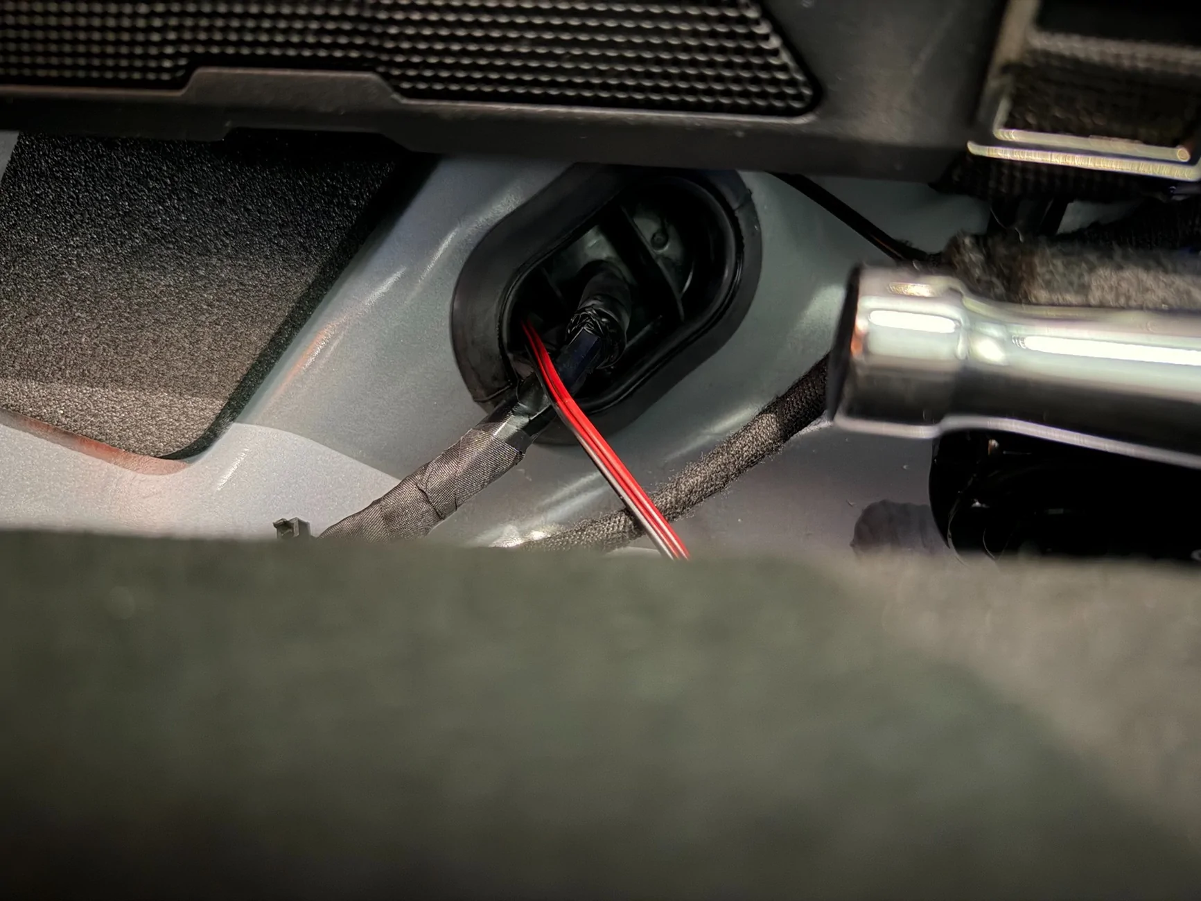

Then I removed the rubber gasket behind the seat and fished the wire through that opening and re-seated the rubber gasket. I connect the wire to the pos battery pole and the grounding post beside the battery.
I use Car Scanner to monitor the battery status, and this works perfectly for me and my battery is at about 90% after a day in the sun, again Florida...

Here are some pictures of the installation.
Hope this helps if anyone wants to go the same route.
