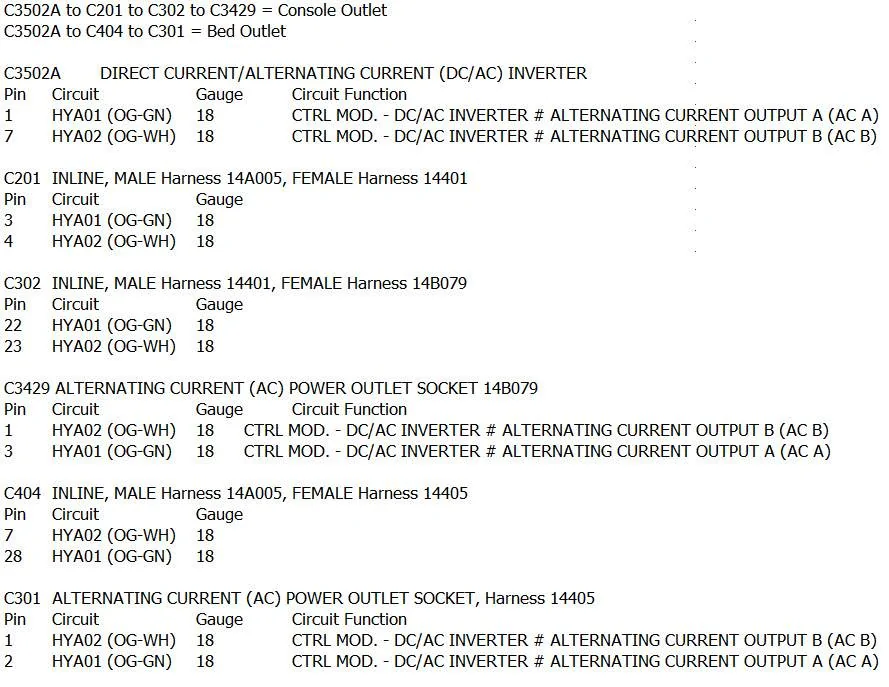

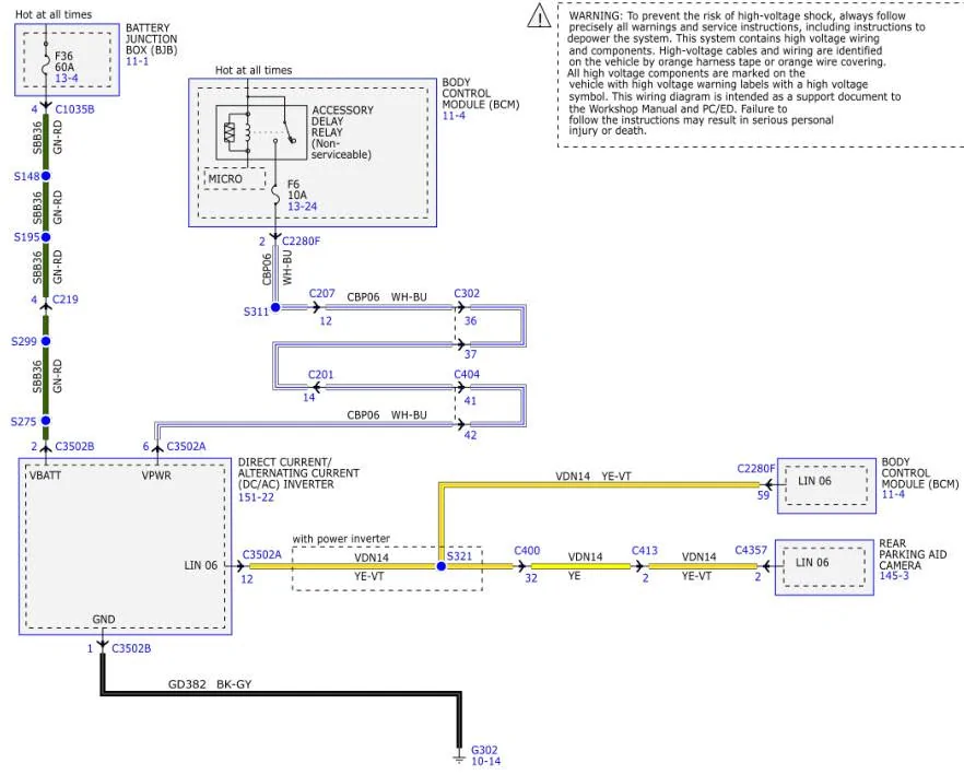

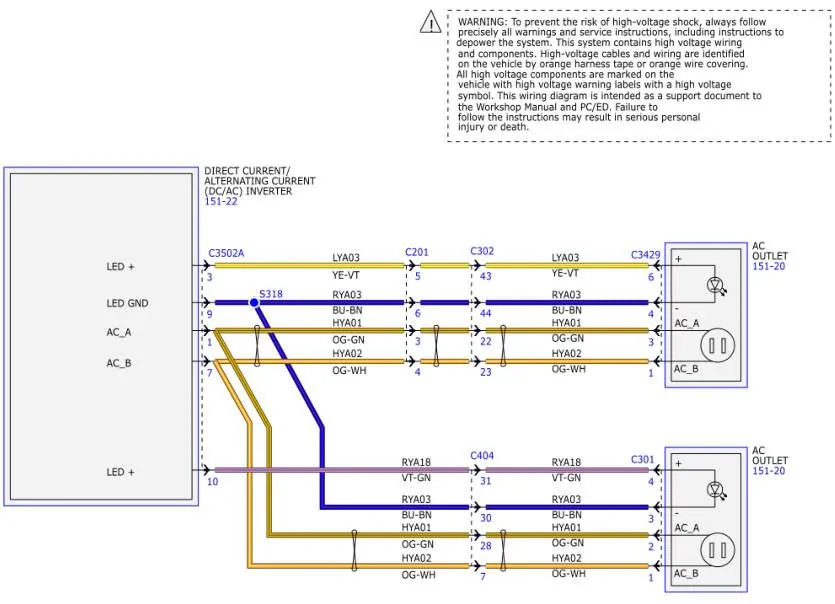

Ford Maverick 110v overload OEM Inverter DC Power Wiring Ford Maverick 110v overload OEM Inverter AC Power Wiring Ford Maverick 110v overload OEM 400W Inverter - 110VAC Connectors Wiring
