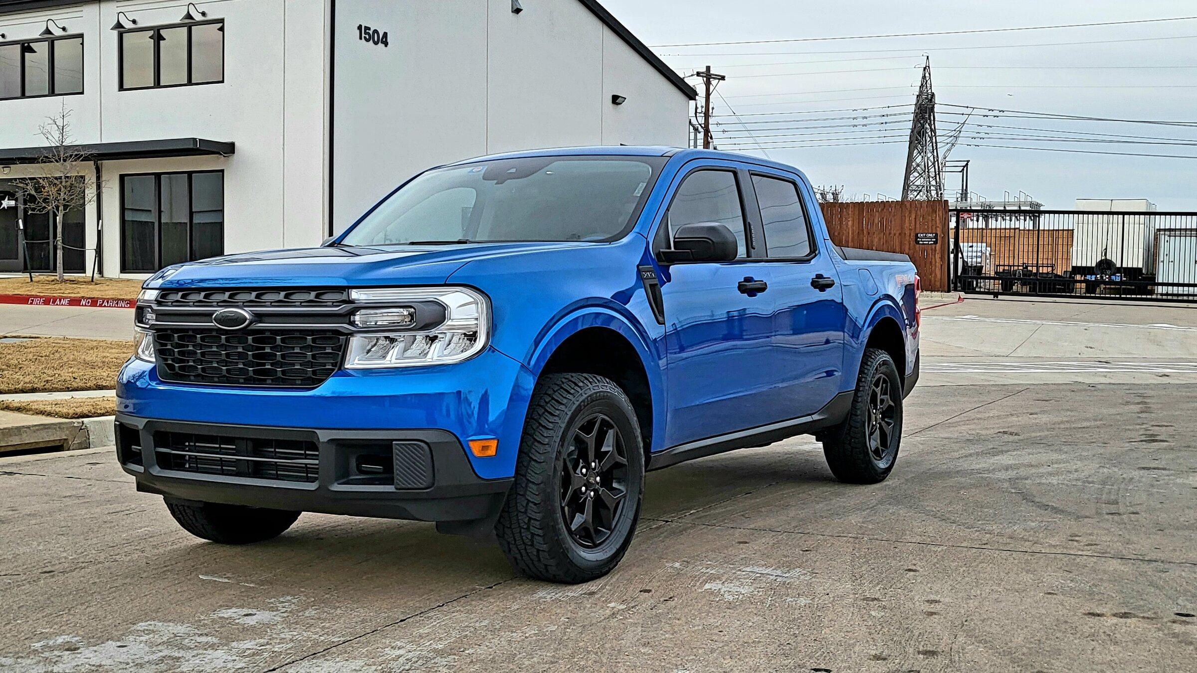

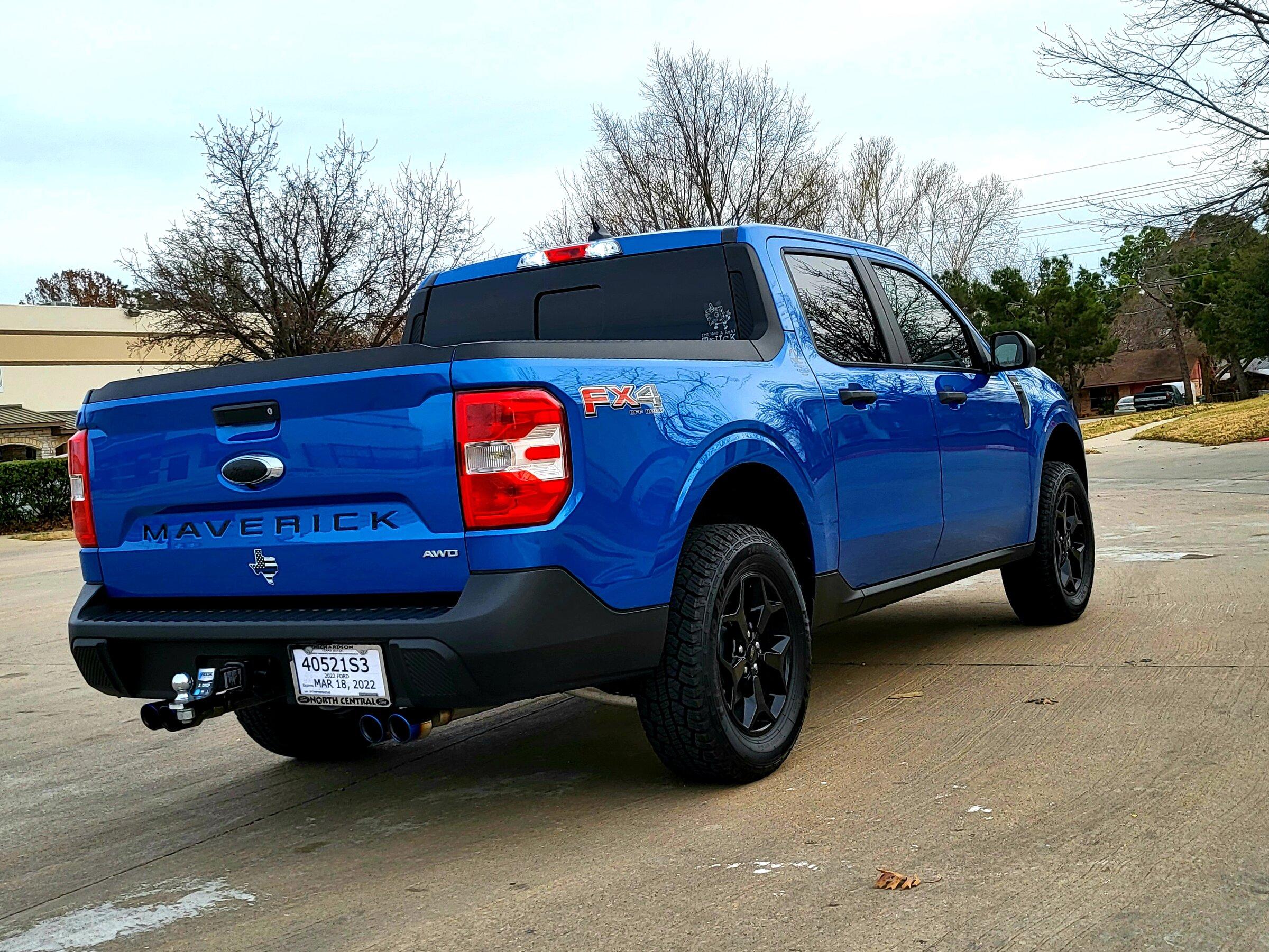

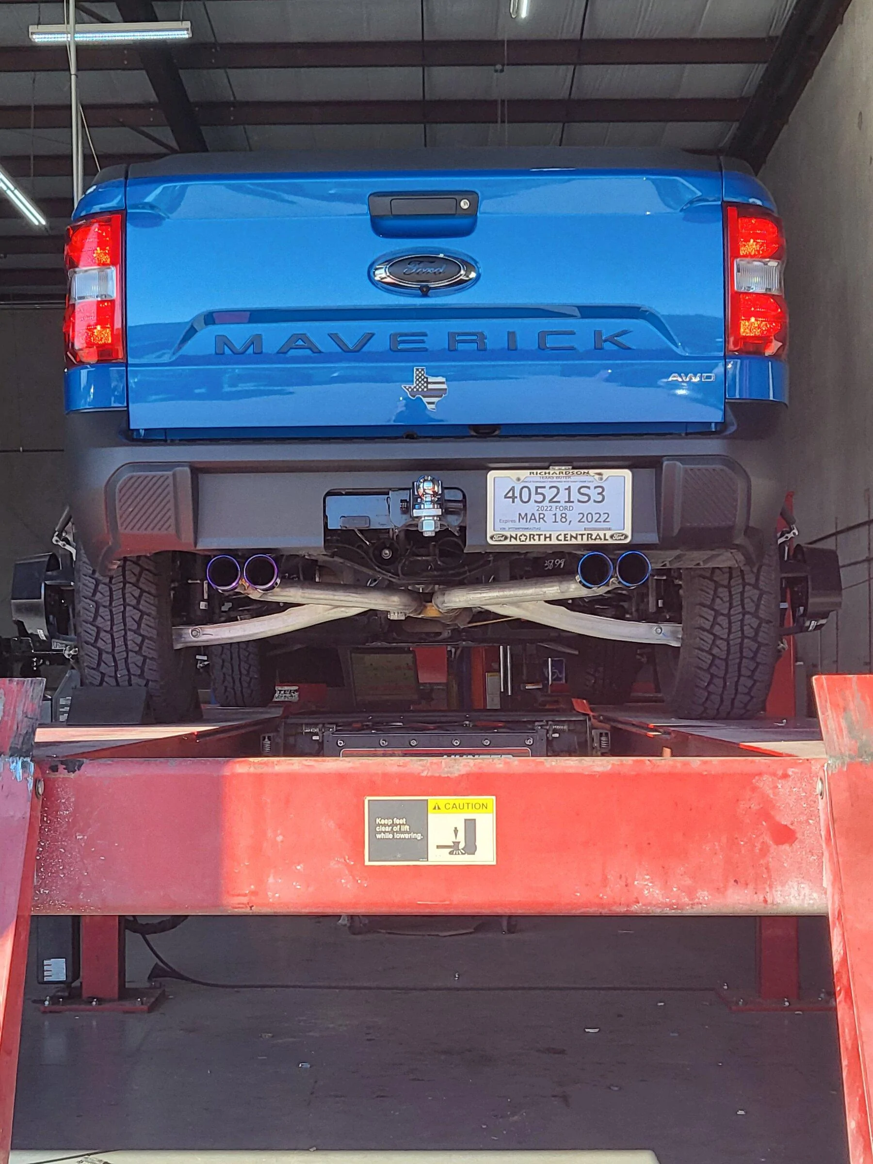

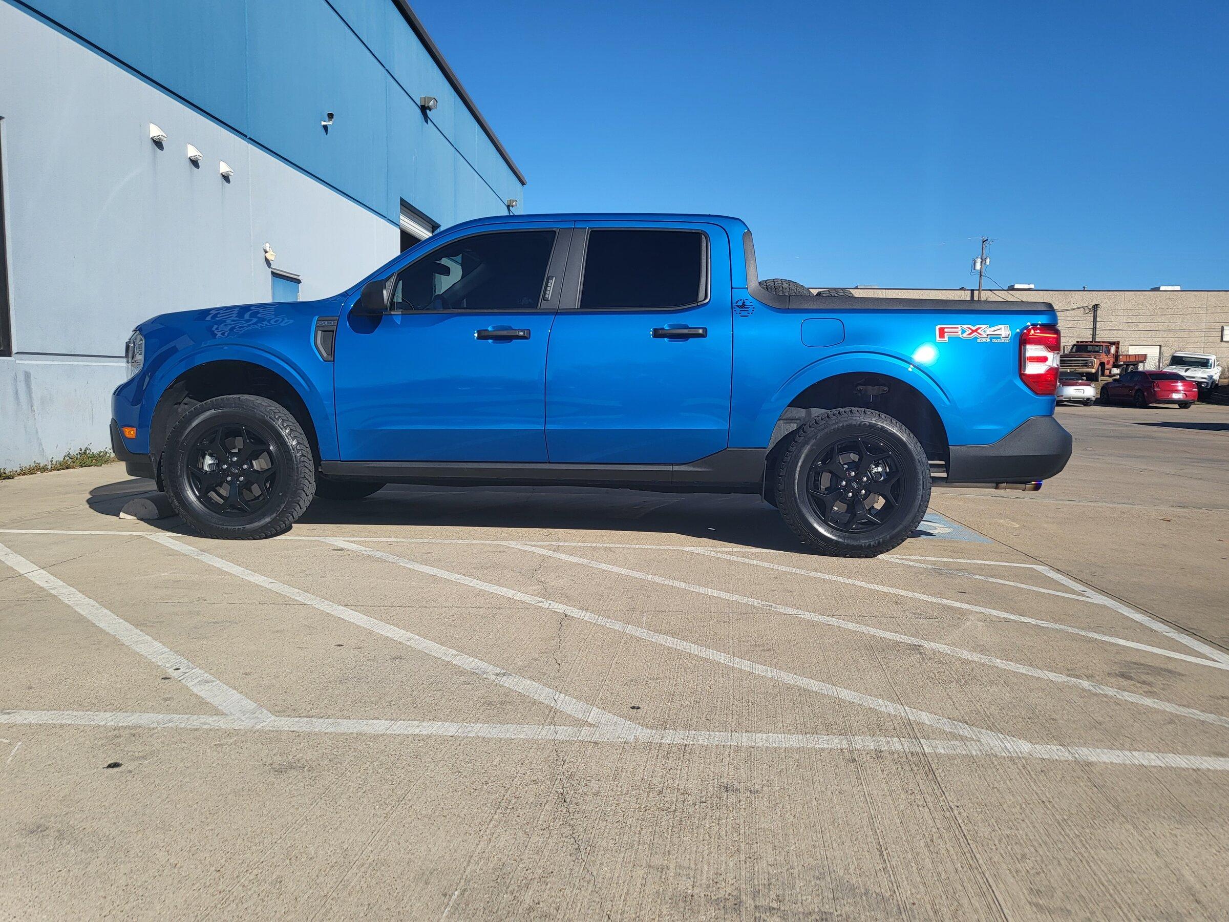

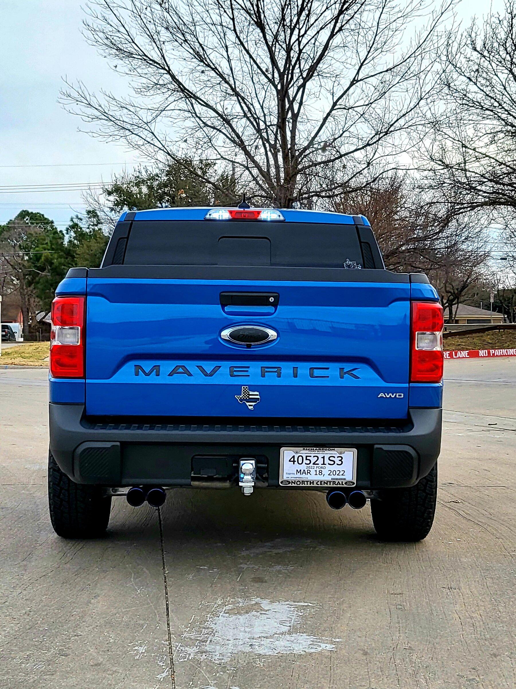

Did a custom 2.5 inch lift and custom exhaust.
Exhaust details:
Custom 2.5 pipe from the cat back replaced resonator with Borla s-type custom y-pipe with quad tips

Details on the 2.5" lift???

details on exhaust please

Quad tips First.....Nice man. 👍🏽

is the rear wheel not centred in the wheel well on all the lifts for this truck? Have seen this before where rear wheel appears off. Perhaps a function of the unibody construction. Seems to be evident on Ridgelines as well

2.5 lift looks to be to much for my taste. 1.5's look best imo.
This isn't due to the unibody. This is due to the short length of the longitudinal control arm. Picture where the forward pivot point of the roughly 2' long arm is and you'll recognize that the wheel will of course move along that arc as it drops out (a lift kit just pushes it down along that arc).
If you centered the rear wheel when lifted, while retaining the short control arm length, then the tire would contact the rear of the wheel well upon suspension compression.
One could potentially create a long arm kit to solve this (would move the forward pivot point farther forward, consequently creating a wider arc (straighter wheel travel)).
