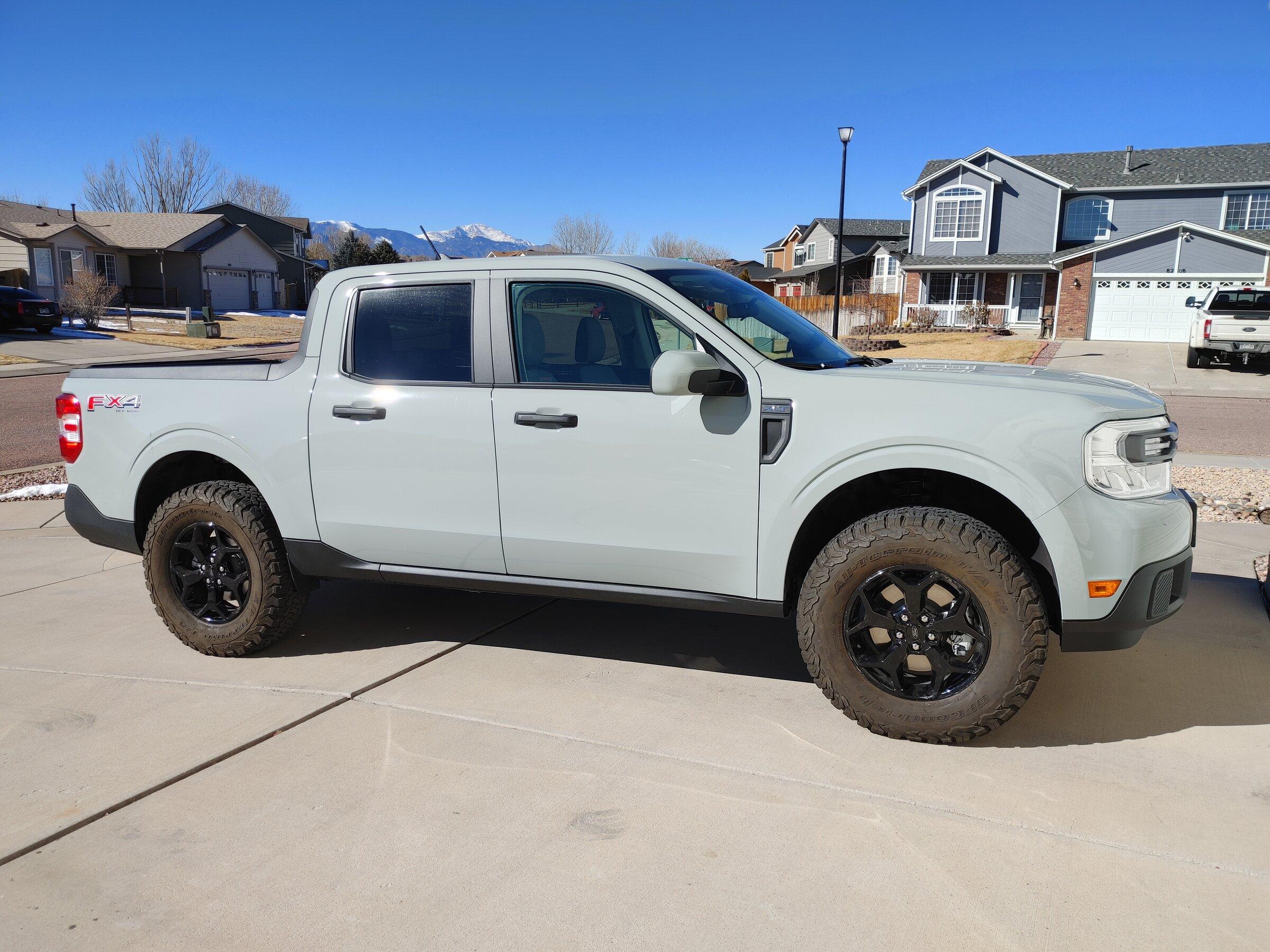

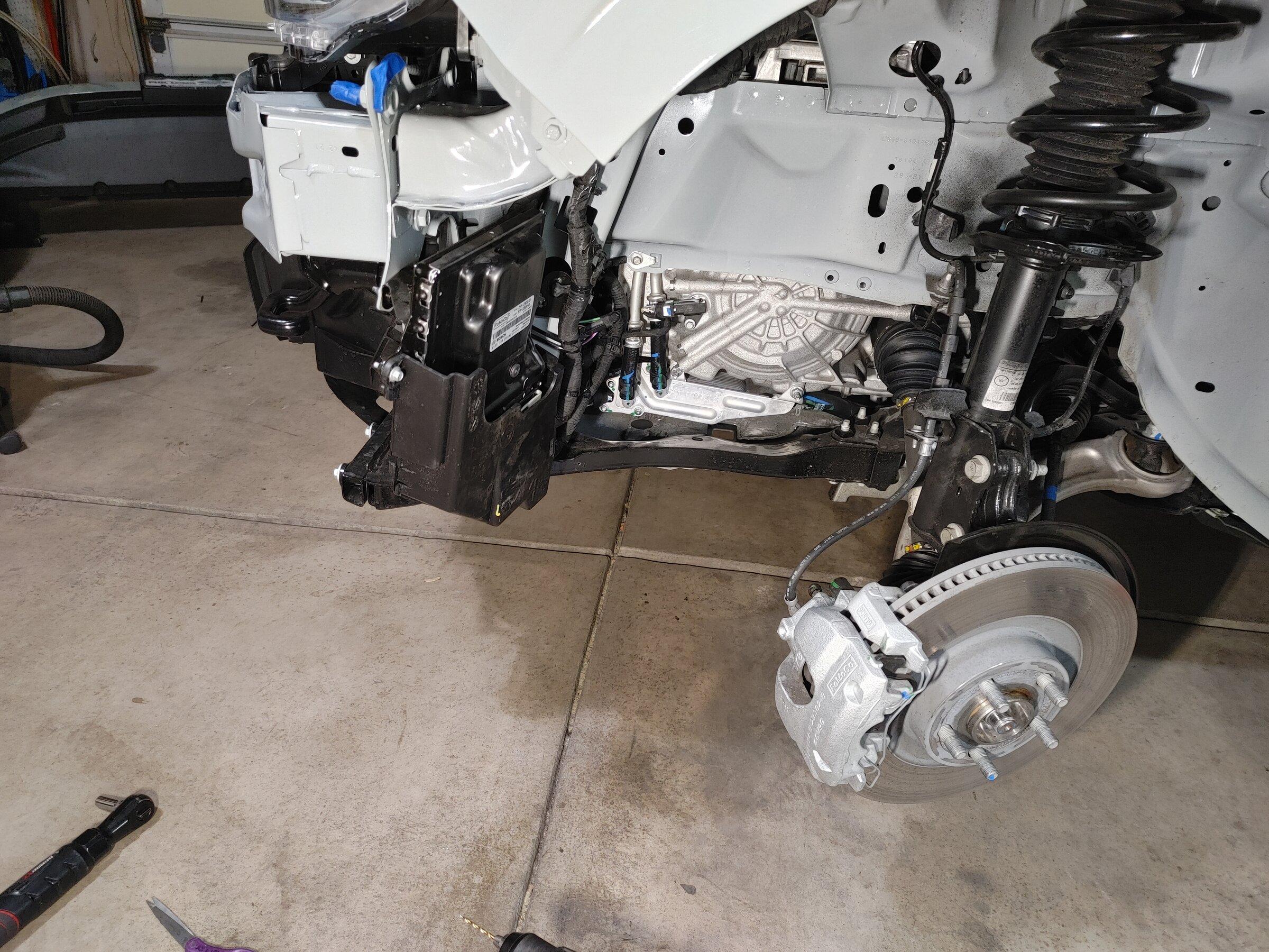

Any thoughts on something slightly smaller squeezing in like a 245/75 or a 255/70 or 31x10.50r17? Im all about trimming and welding, I cut up everything I own, my wife is a lil nervous about it.
The fender liner sticks out up to an inch in some places. If you could find a 255/70R17 that would probably give you enough clearance to not have to mess with the ECU like I did.

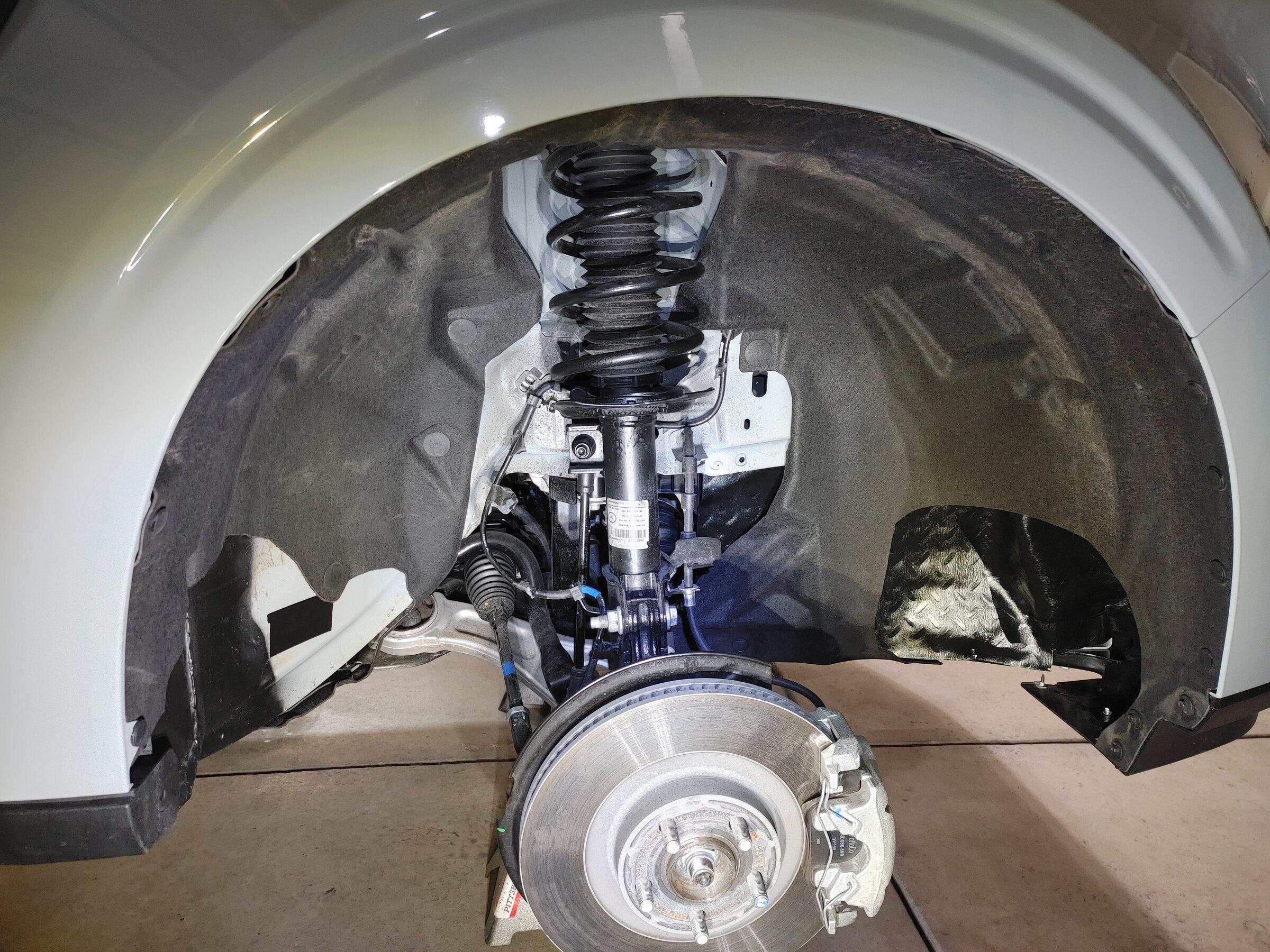

Ohh I liked some of the ECU stuff. I DO NOT like it being so low and right by the tire?? I even told my wife look this guy used the same mats we have on our floor to protect the computer! I will probably do lots of small little moves and mods to various things, I just dont think my wife will allow any welding on it until we have it mostly paid off :ROFLMAO:. I think it could be reasonable platform to do alot of serious 4wd mods eventually. But your truck looks awesome.

Thanks man! My wife was like wtf too when I had the front bumper off lol.

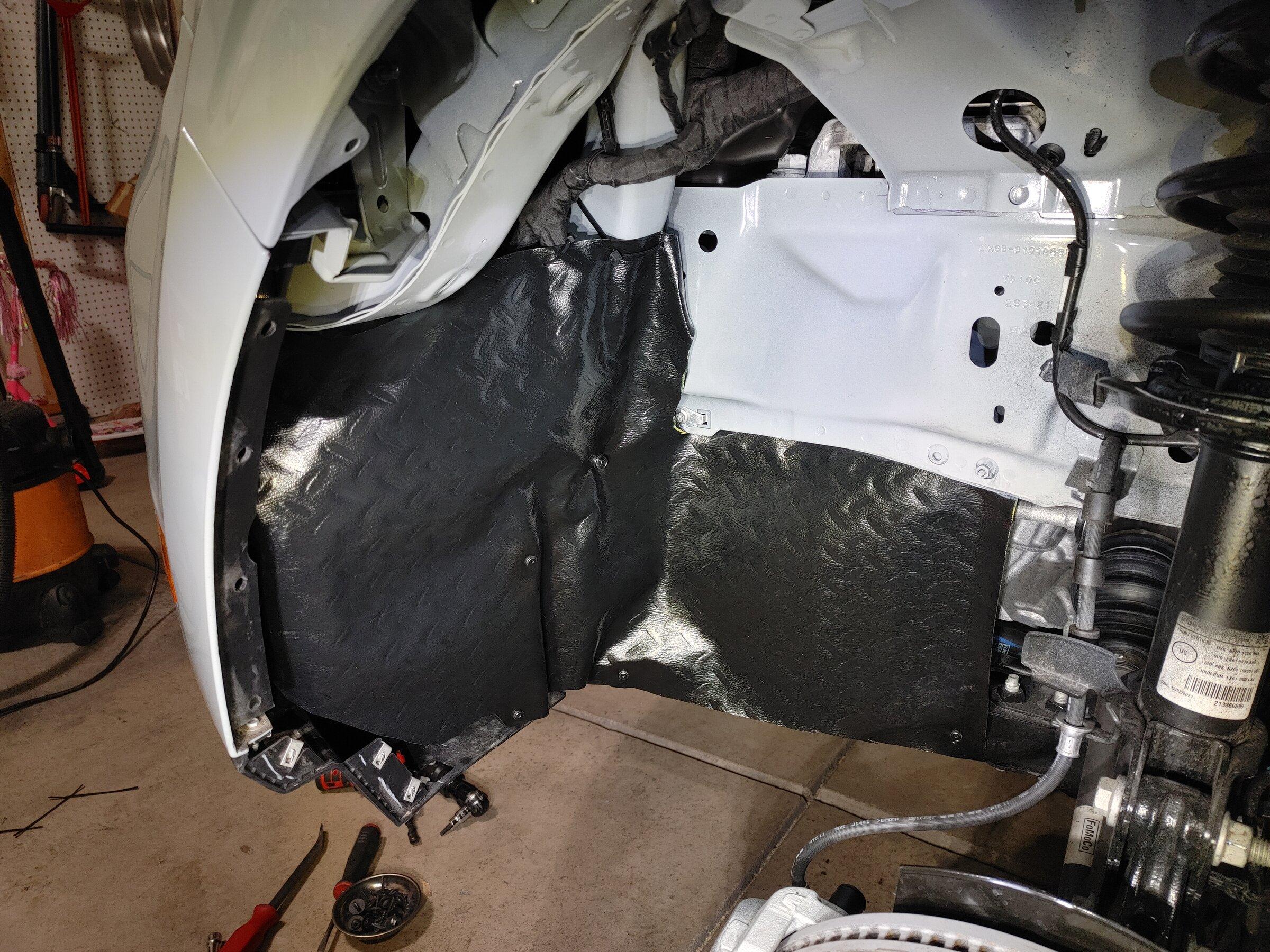

Is that mat adhesive backed, where did you source it, or how is it adhered?

Nope. Just rubber floor mat from local hardware store. I used rivets in most places to secure it. Tried to use existing holes if I could. Once I find some wheels I like I'll probably make something more permanent for the fender liners.
