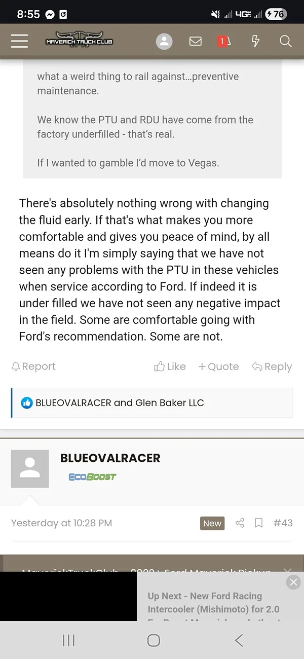

Ford Maverick +1 to low factory fluid fills Screenshot_20260123_085544_Chrom

This screenshot is from a Ford research and development employee. Change your RDU fluid at 150,000 miles per fords recommendation and save your money.
The cost of gear oil is ~$17 a qt for top-shelf, so less than $10 worth of oil each change for a ~$800 unit. Thanks but no thanks.
Oh and chances are I have more experience and education than that person who works for ford and is looking out for the company's best interest, not yours. My interests lay in what cost me money. You do you boo.
