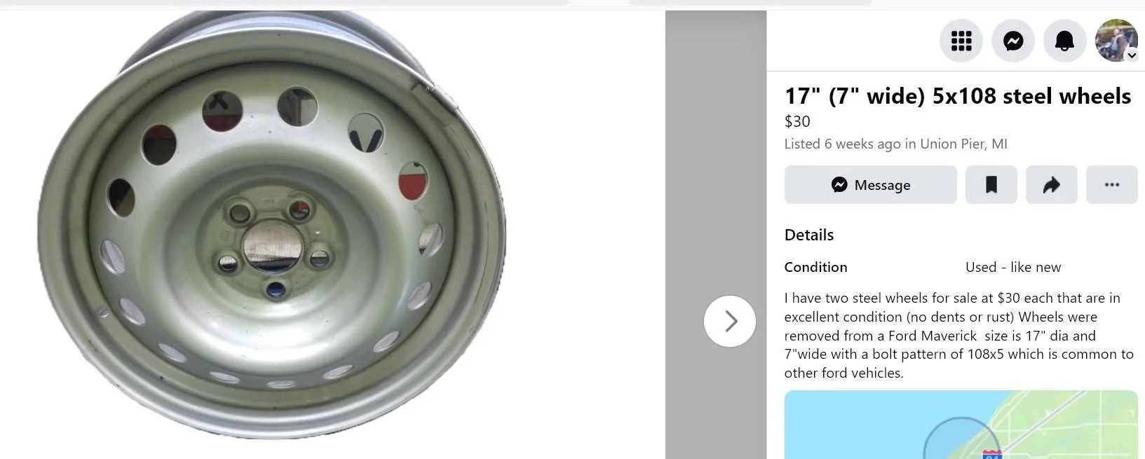

1/2-way there,,,,,

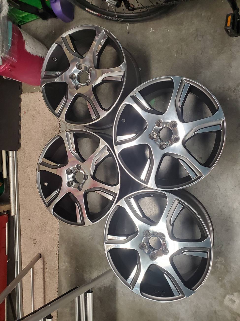

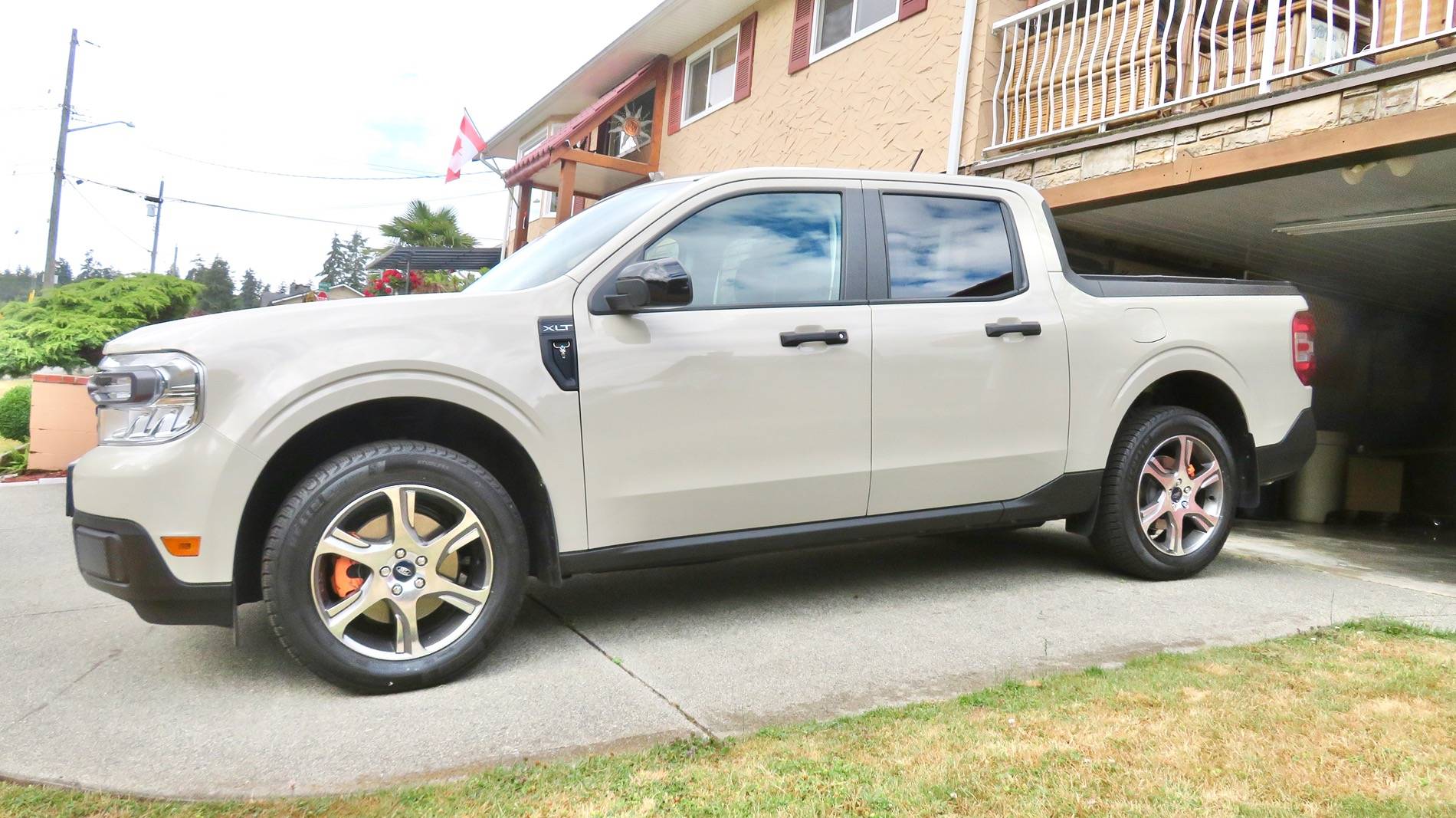

Check the wrecking yards for used VOLVO (SUV/wagon) wheels, 17" or 18 ". Likely around $100-$150. these fit perfectly with stock spec size tires and require no spacers or different lug nuts. Make sure to buy decent quality TPS monitors and the truck will recognize them automatically.
