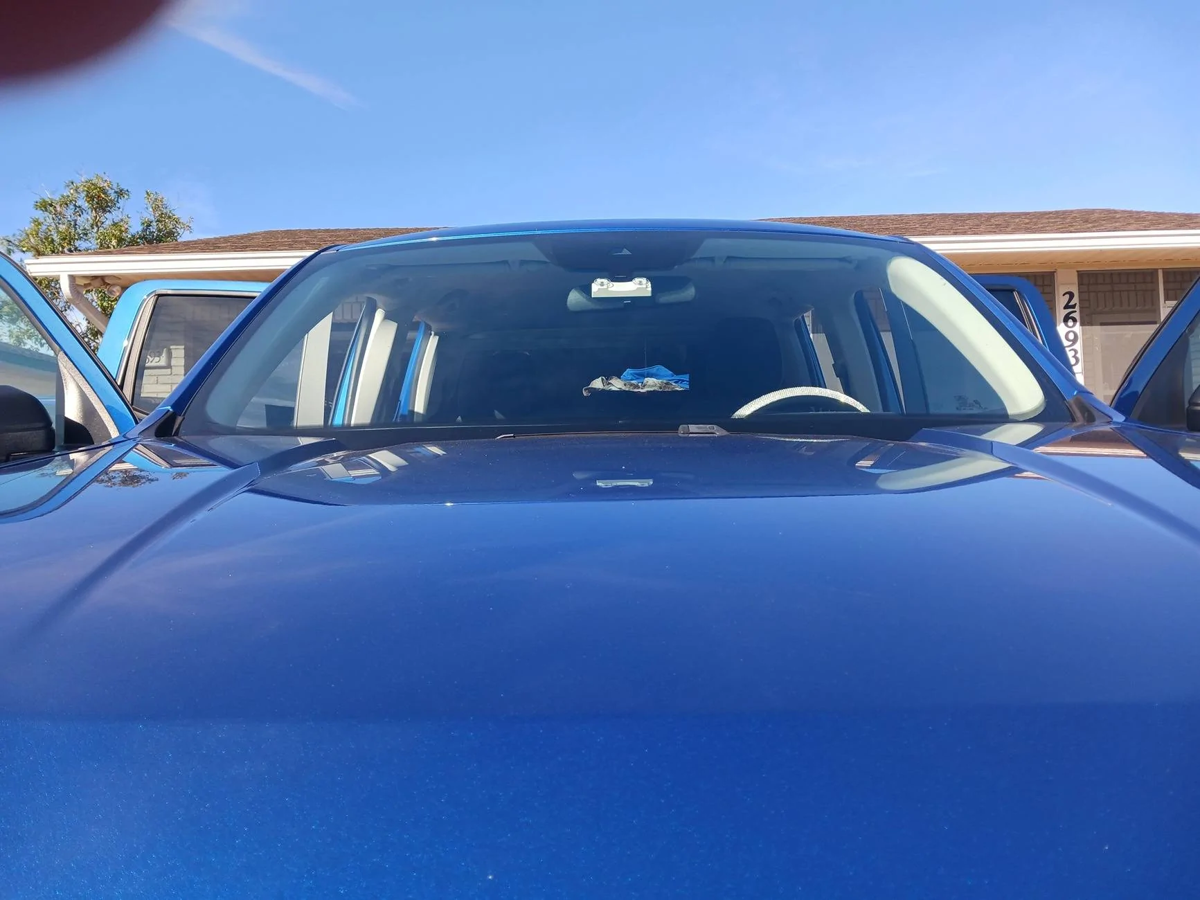

Looks great.
How well does it hide in the parked position?
I may do the same.

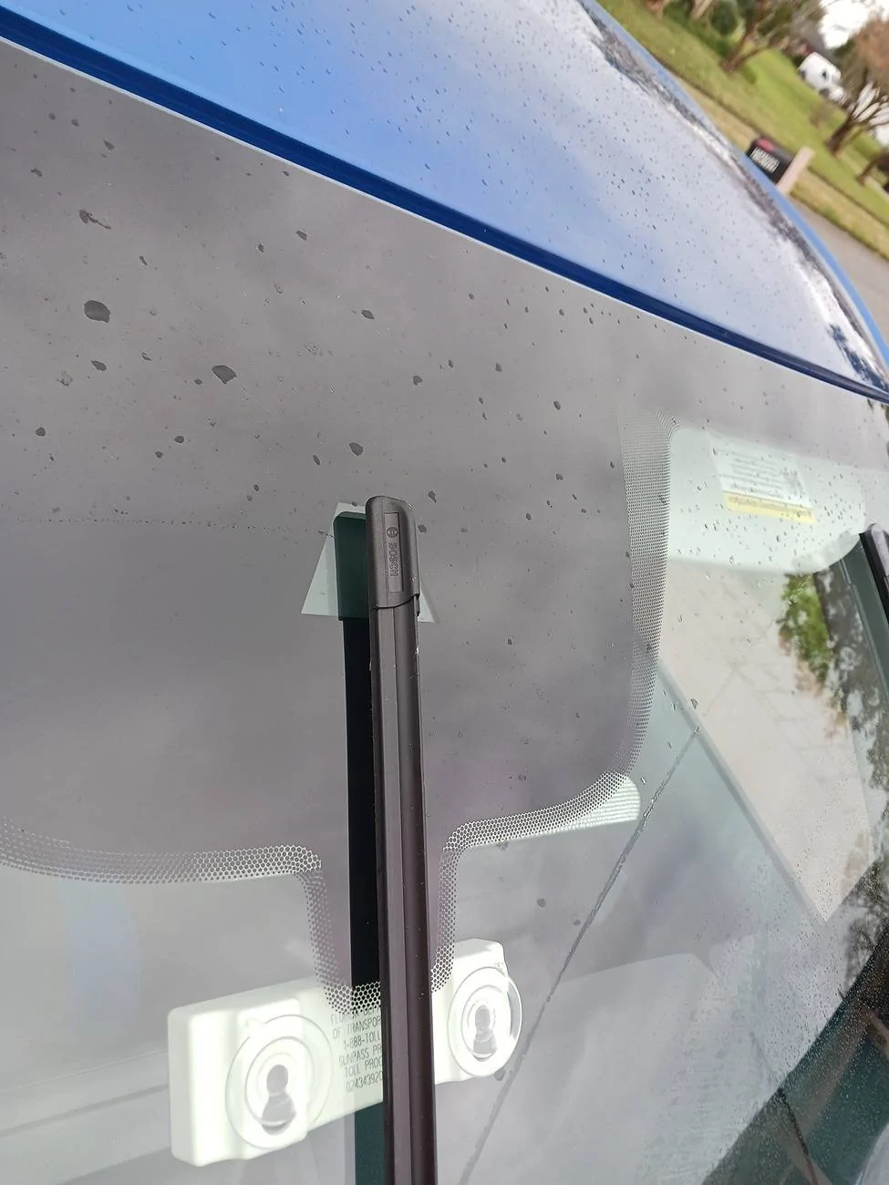

We had heavy wet snow in N E Ohio about a month ago and it pushed the passenger wiper blade under the weather stripping. I had to pry the blade out from under the stripping. I wish they had the old hard plastic stops to keep the blade from moving farther than it does.

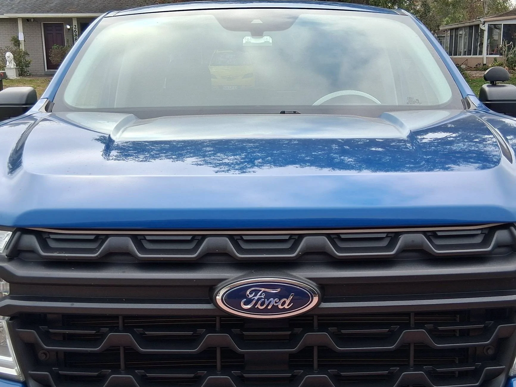

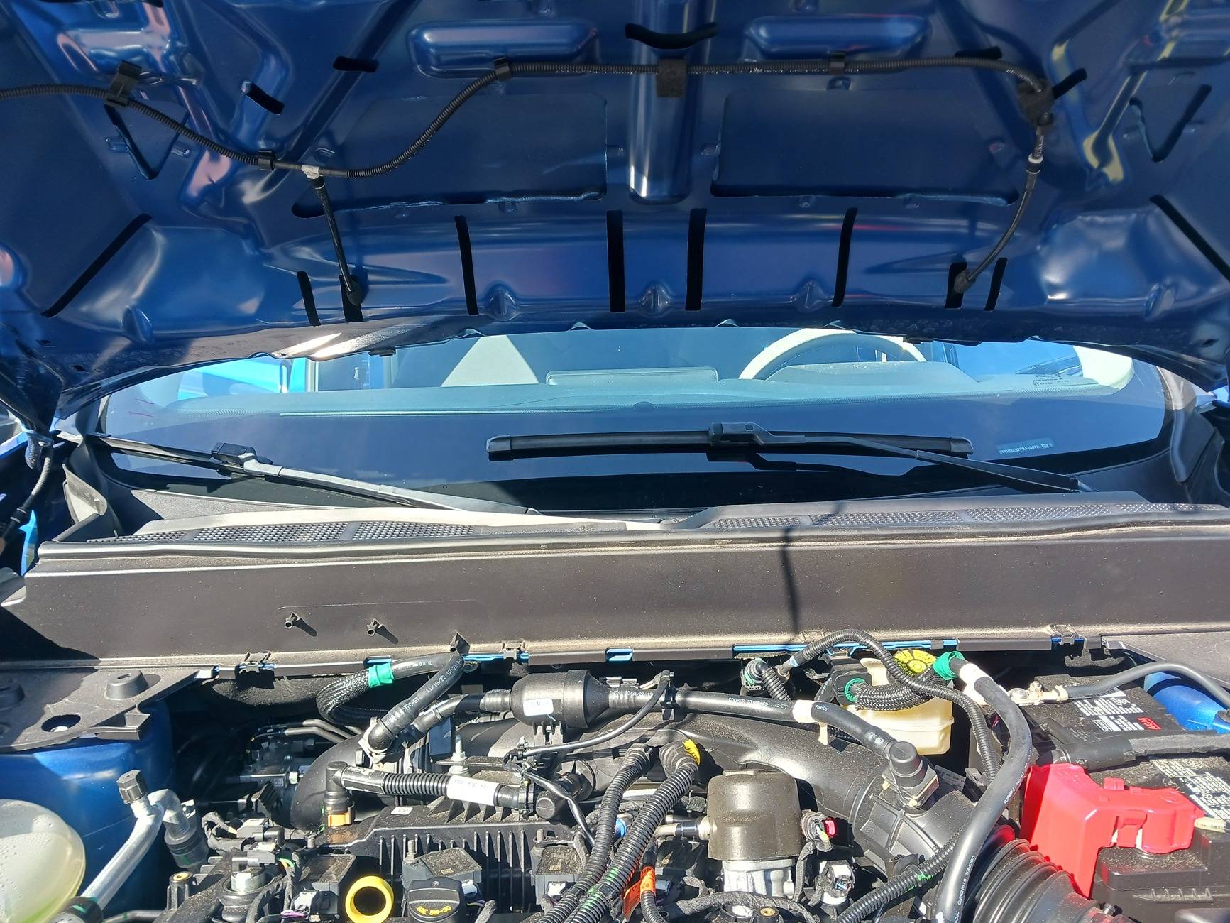

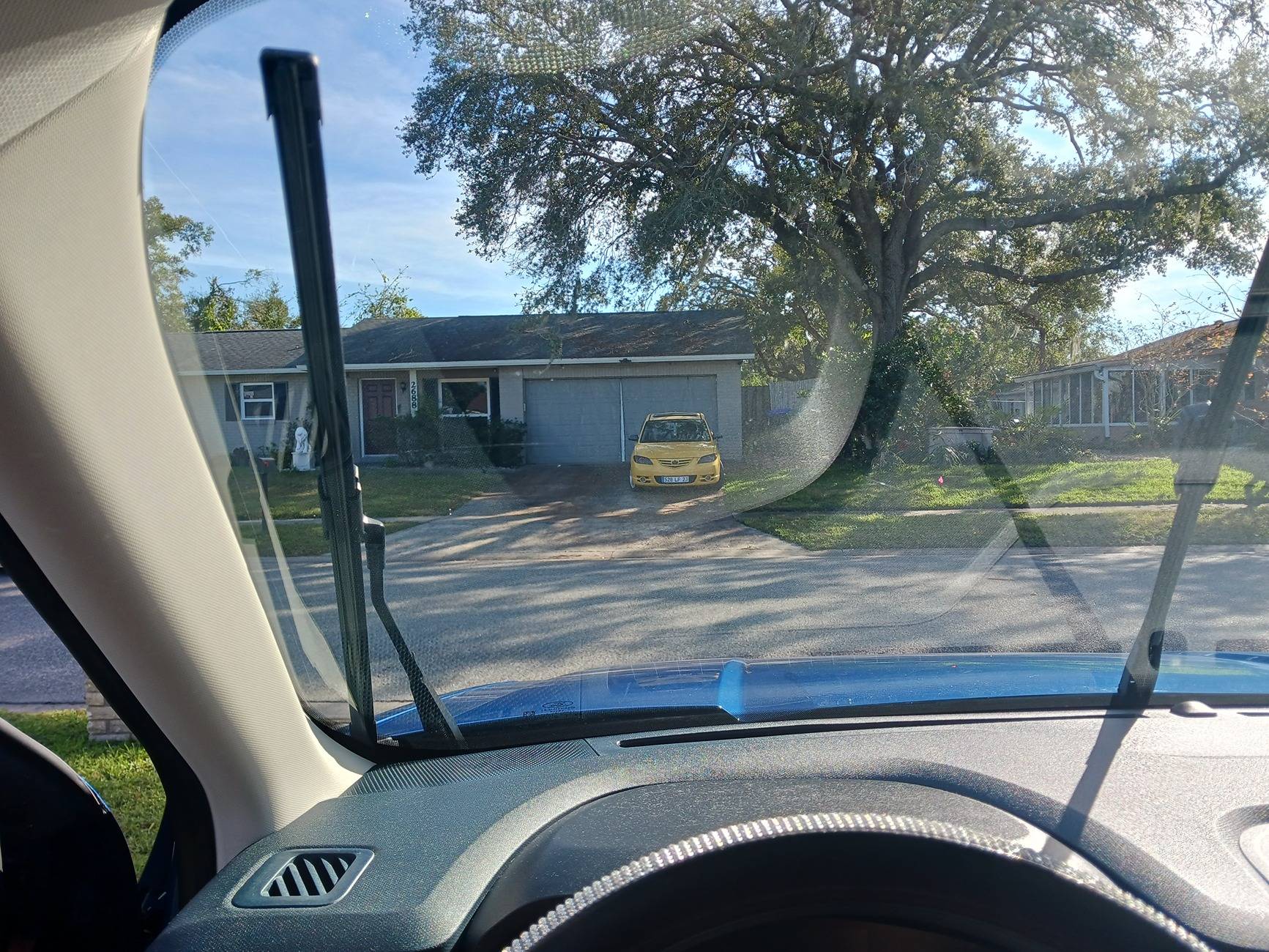

Move down on spline ,both sides , and it hides wipers lnto the hood cavity. Drivers wiper about 1" to post on bottom and 2" from post on top. Workable for me . 23" blade on drivers side ,20" on
pass. 20" blage catches camera fine.
