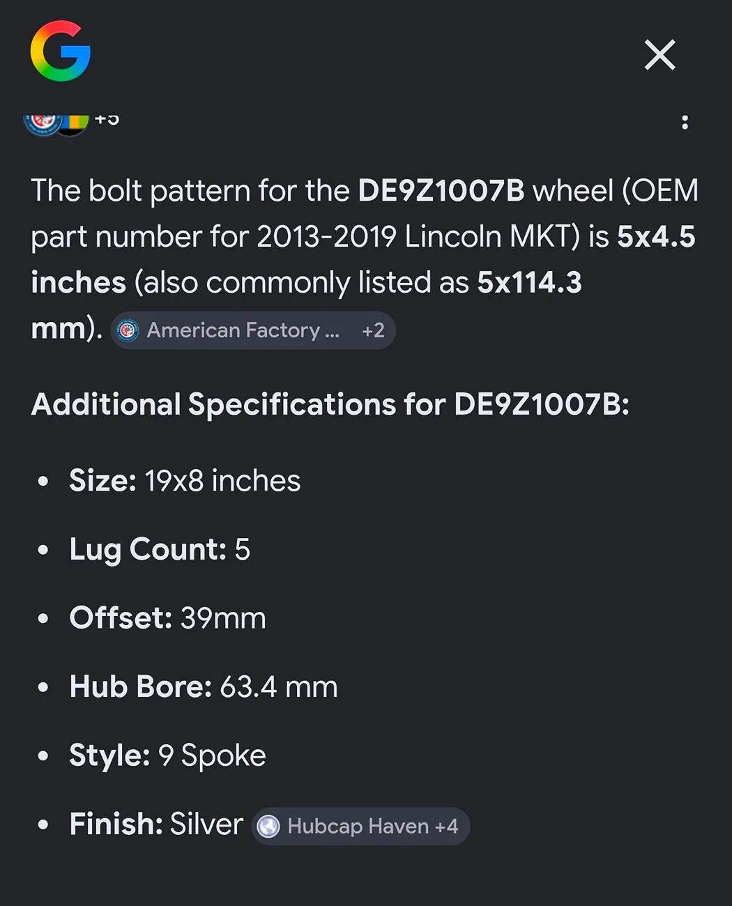

Yes, see picture.
Why would you provide incorrect information to the OP when the question has already been correctly answered (with proof)? Your Google picture further confirms those wheels will not work on a Maverick.
NO, THOSE WHEELS WILL NOT BOLT ONTO A MAVERICK. SEE MY POST #3

Because they fit our 2025 Maverick.
Ummm, no they don't unless you've changed all the hubs and bolt pattern on the Maverick.
Did you change all the hubs and bolt pattern on your 2025 Maverick truck?
The 2025 Ford Maverick features a 5x108mm (also known as 5x4.25-inch) wheel bolt pattern across all trims, with a 63.4mm hub bore.
The DE9Z1007B wheel, commonly used as a 19x8-inch OEM alloy rim for 2013-2019 Lincoln MKT models, features a 5x114.3mm (also known as 5x4.5 inch) bolt pattern.
