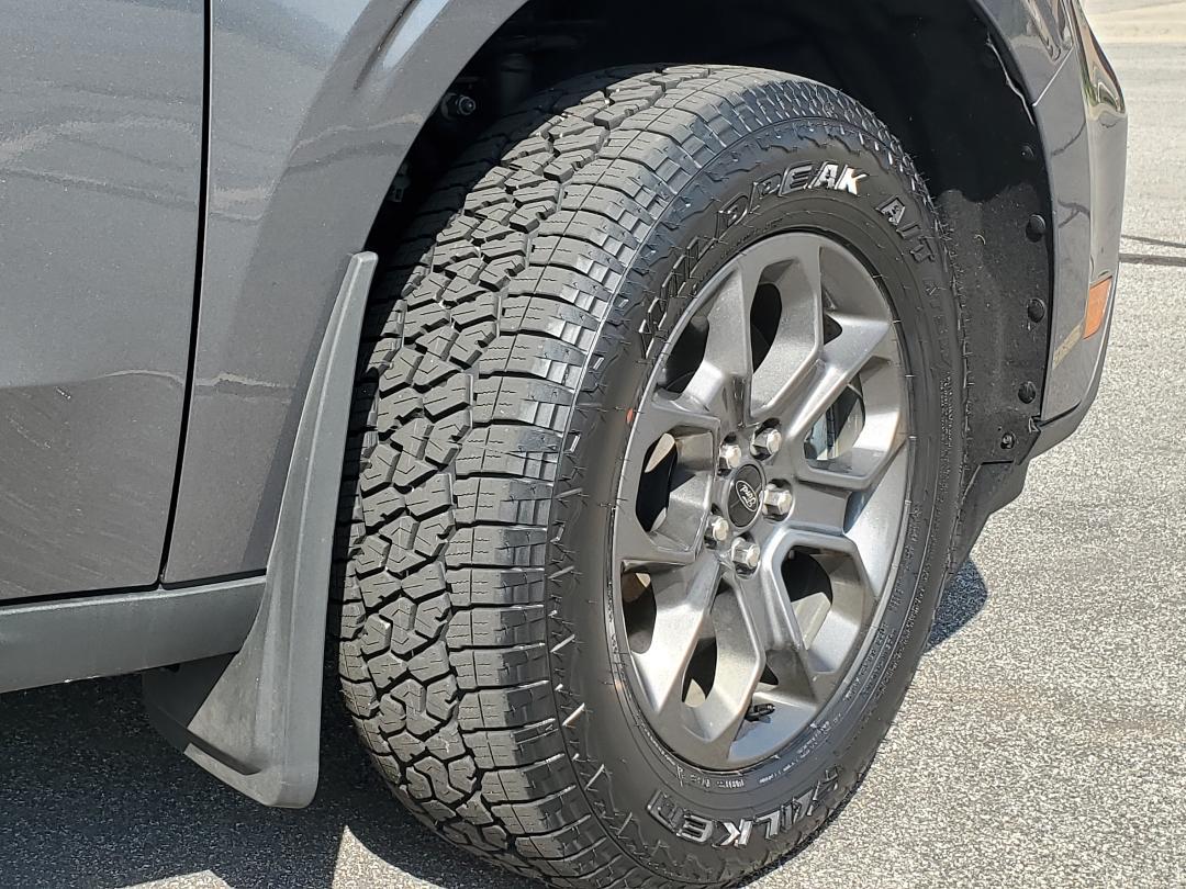

In case anyone wondered, here is the 235s installed on a maverick. Still lacks that aggressive tread

I intentionally got the lighter 235s, as I didn’t want a super heavy tire on my hybrid, but they still provide an upgrade in grip, durability, and snow rating. They handle way better than the spec Continentals as well, less sidewall flex.

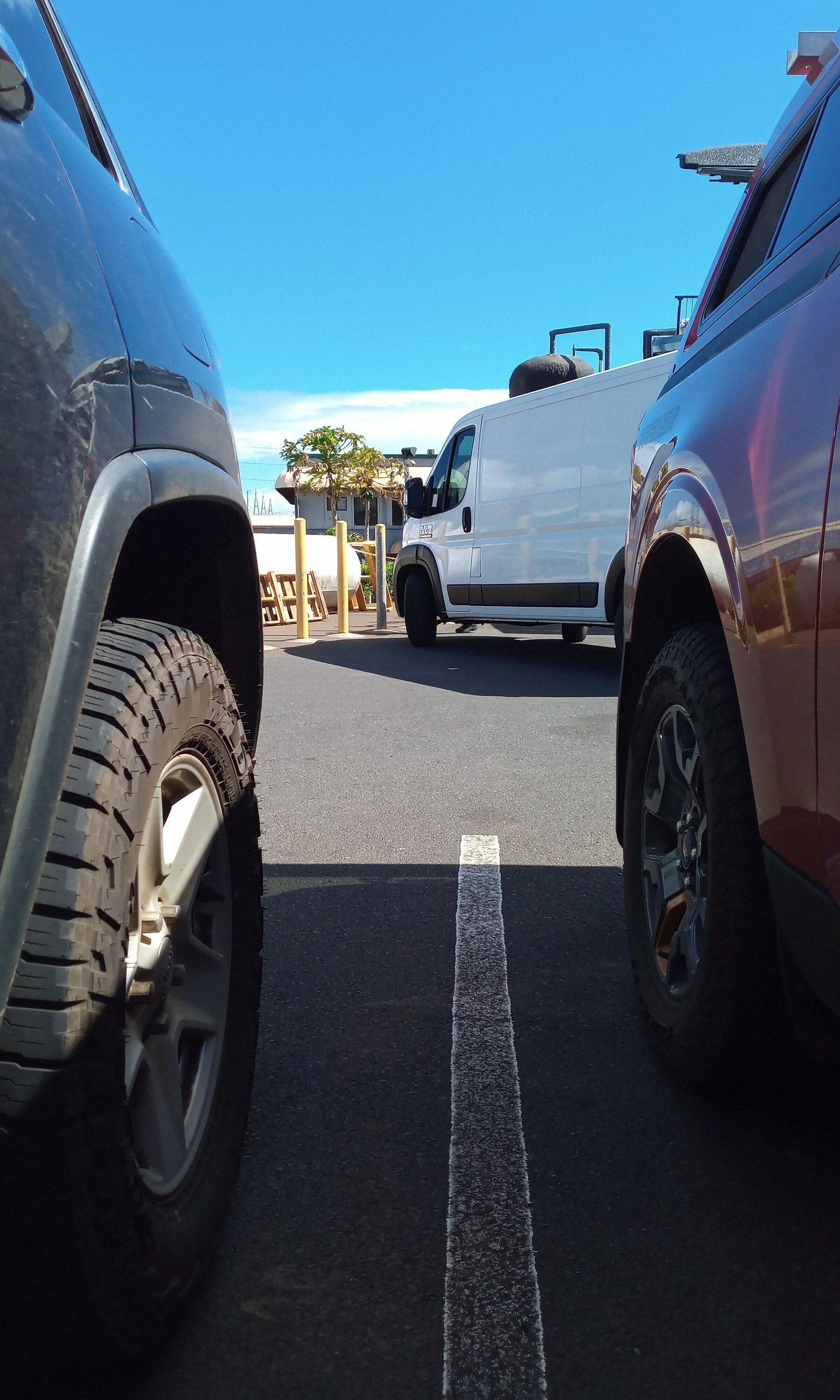

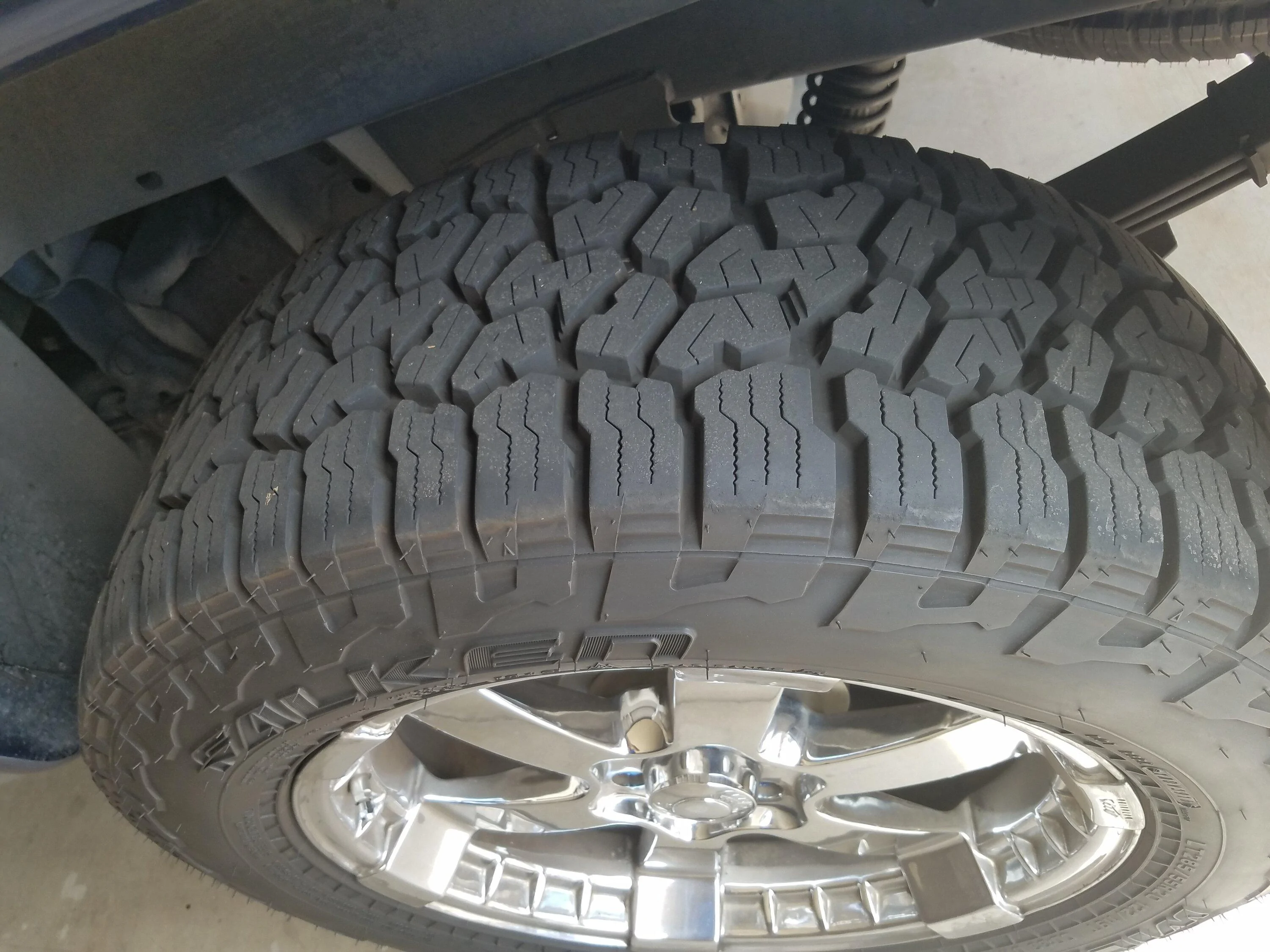

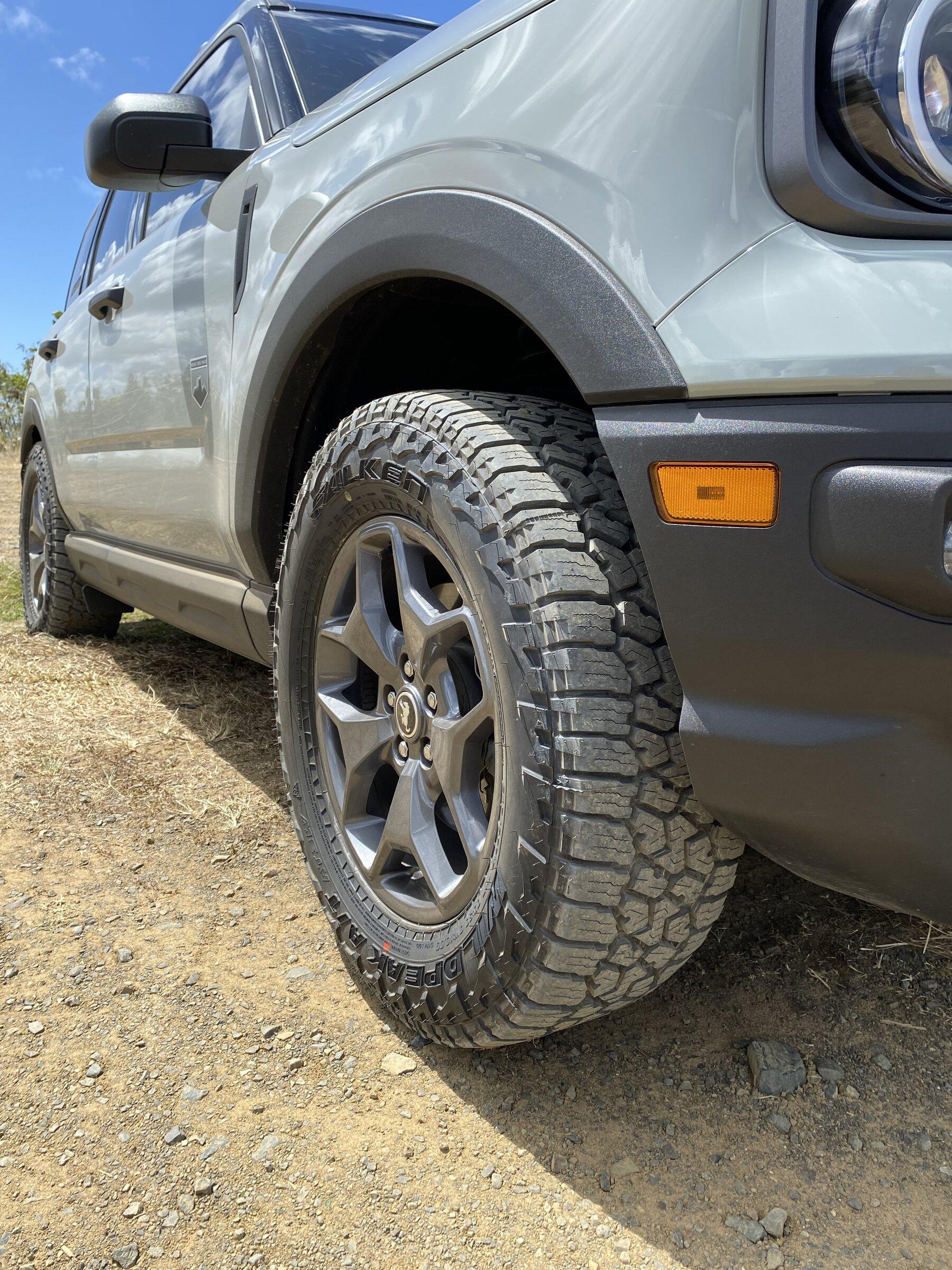

Yep it is the difference between OEM and regular and also the size available to space out the tread effectively.
My in laws have 245/70r16s and 265/65r17s on their jeeps no pics of the 245s but I have side by side of mine and the 265s.
The tread size is clearly larger with greater voids. This applies to the sidewall protection too.
There is 4.8 extra inches of circumference between theses 2 that alot of room for extra voids and lug width.
This is the size I am planning on when our stockers wear out.

But are the Trails watered down in the 235/65 size also. Small tire is a small tire. Only so much room to work. In the pics i posted there is 40% more zig zags in the sipes on the outside lug. I guess 40% more of the time it works every time.

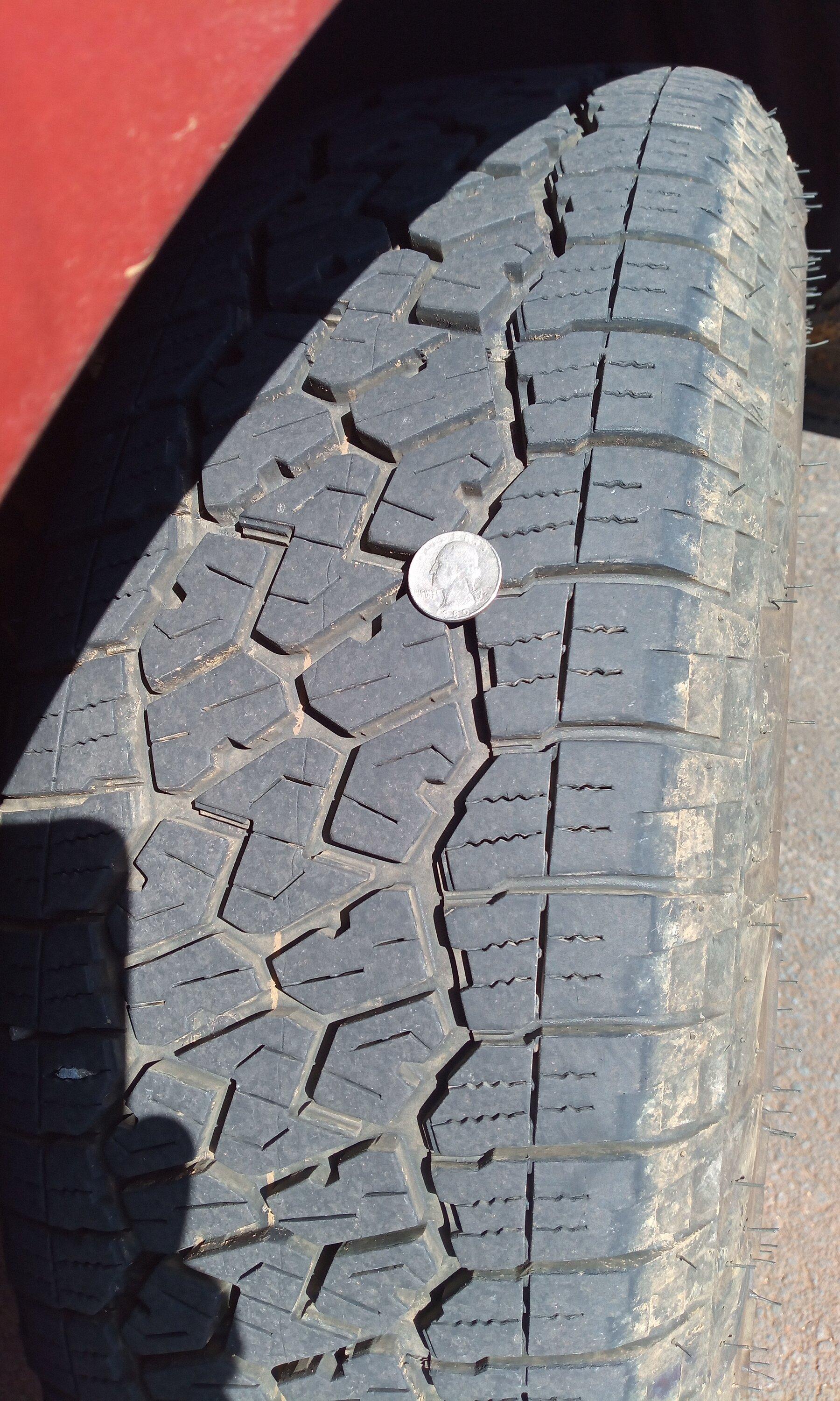

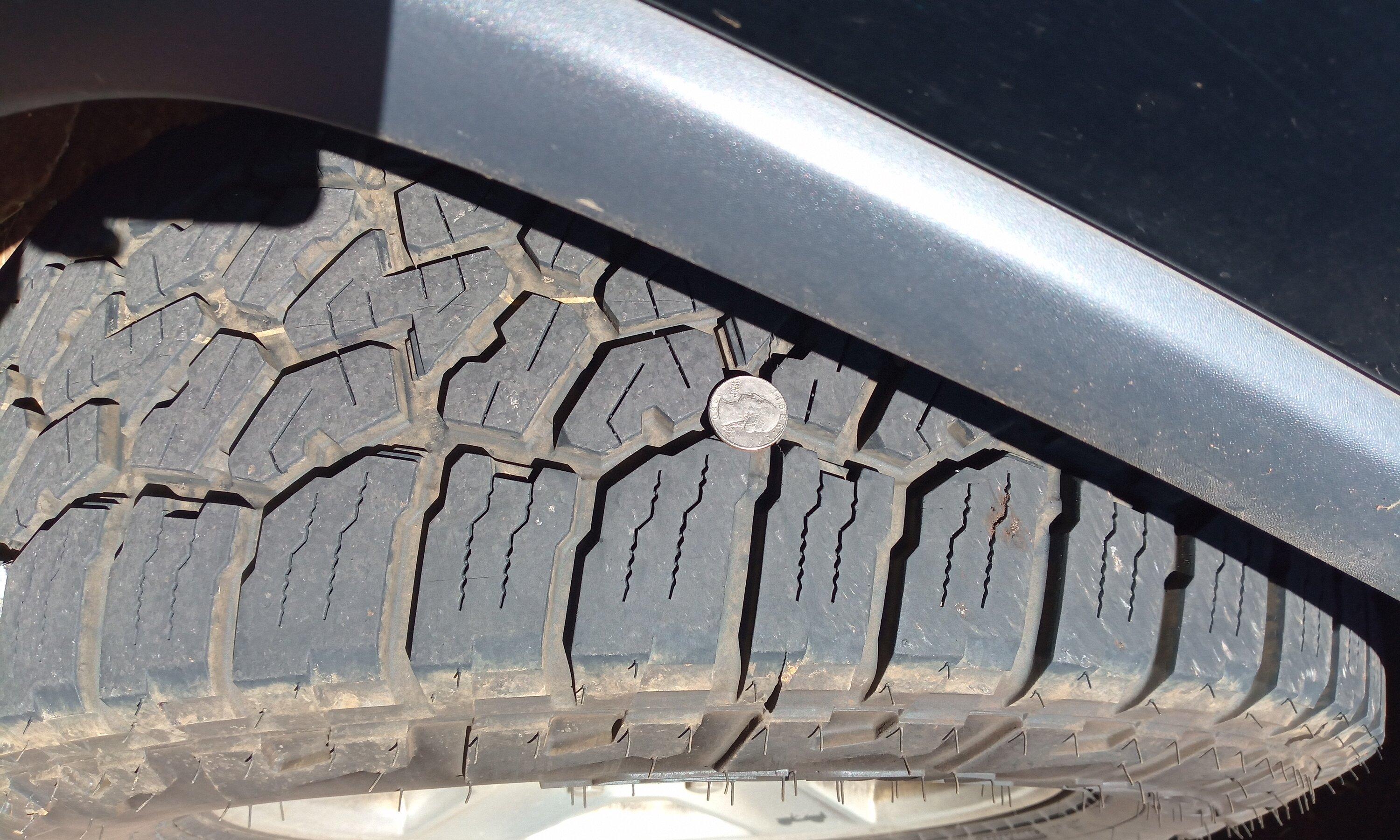

Make sure you are comparing the same rating, Like P metric or LT. LT are much heavier duty, weigh more, and have much deeper tread.
