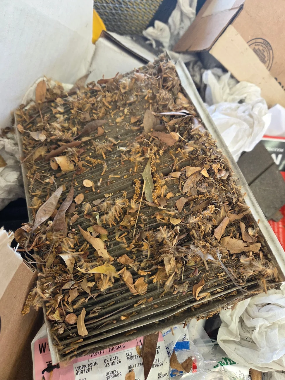

I’ll give you one perfectly good reason to keep your cabin air filter clean. It prevents debris from entering your A/Cs core enclosure. It doesn’t take much to clog that condensation drain, unless you like damp moldy carpet and wet feet.
