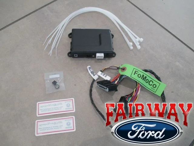

Hi would you happen to have a picture of the VSS module and where it’s located at please.I need to hookup an antenna wire to it. Thanks
It looks like this.
Where it's located depends on who installed it, as you can put it wherever. Most likely up under the dash somewhere near the OBD2 port. Not sure if/how you can hook an antenna to it.
