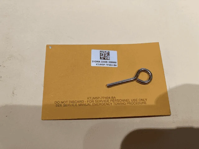

I'm guessing there used to be a manual shift lever and cable that's not on newer Mavericks.
My guess is the Manual Park Release is disengaging the park pawl.
Good guess, I would agree.
I've seen weird small plastic covers near the gear shifter on Subarus and Hondas to insert a key to disengage park if the car is dead...

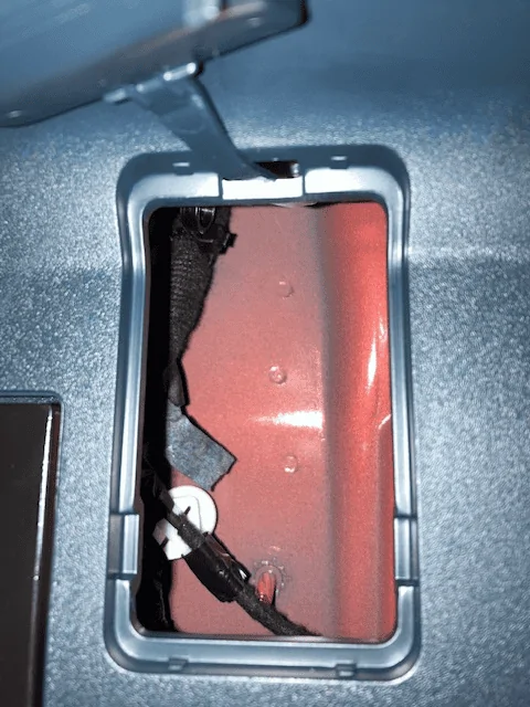

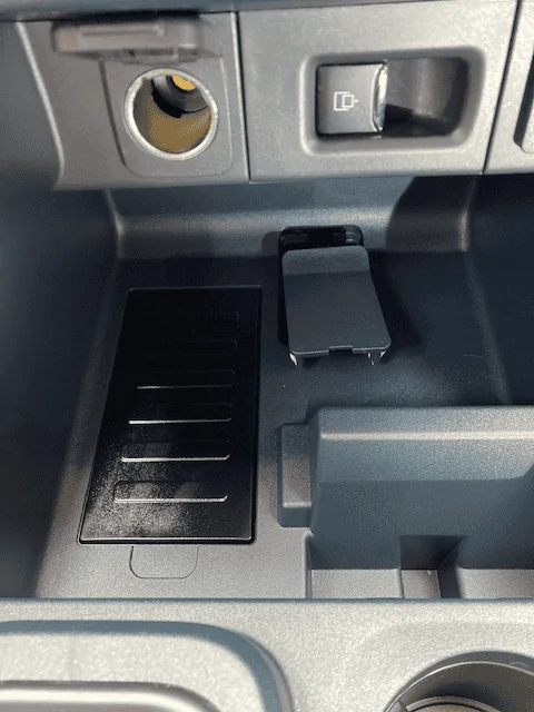

I have the same issue with a 2022 ford maverick lariat AWD GAS version. It came with the same key thing mentioned here and as it says in owners manual that I have a strap in center console and there is nothing there. Asked dealership to verify and they agreed no strap just a wiring harness. It's been months now and no one from dealership or Ford HQ has given me an answer/ solution to emergency tow with all 4 wheels off the ground and use the key supplied to do the Manual park release.
