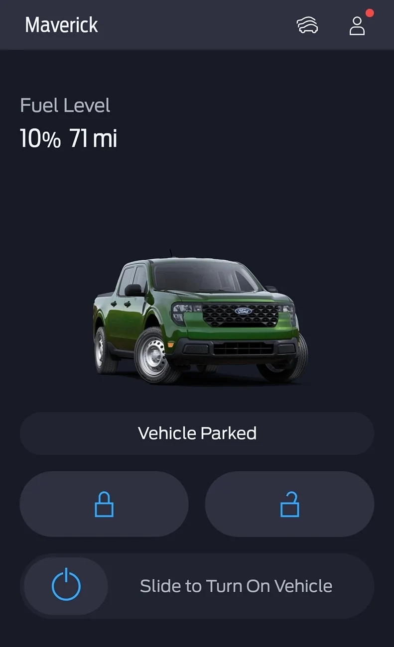

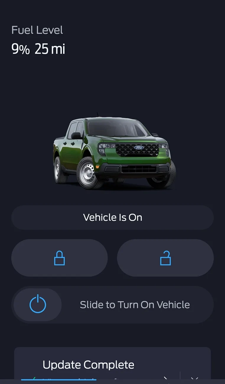

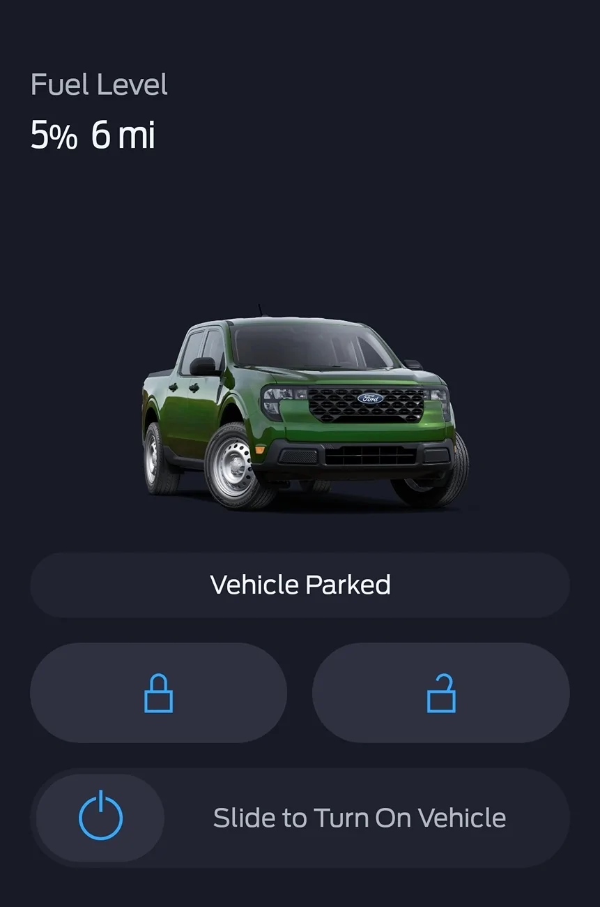

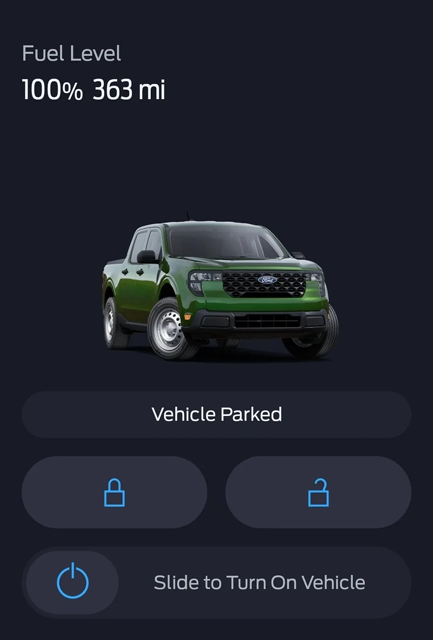

Not sure what to make of this!
Drove 9 miles since the first pic.
First pic was before the OTA update.
Second Pic was after, before driving in the morning.
Third pic after driving 9 miles total to work and back. WTF?

First pic would indicate 710 miles on a tank.
Second would be 278 miles on a tank.
Third would be 120 miles per tank.
Strangest thing I've ever seen on my trucks.

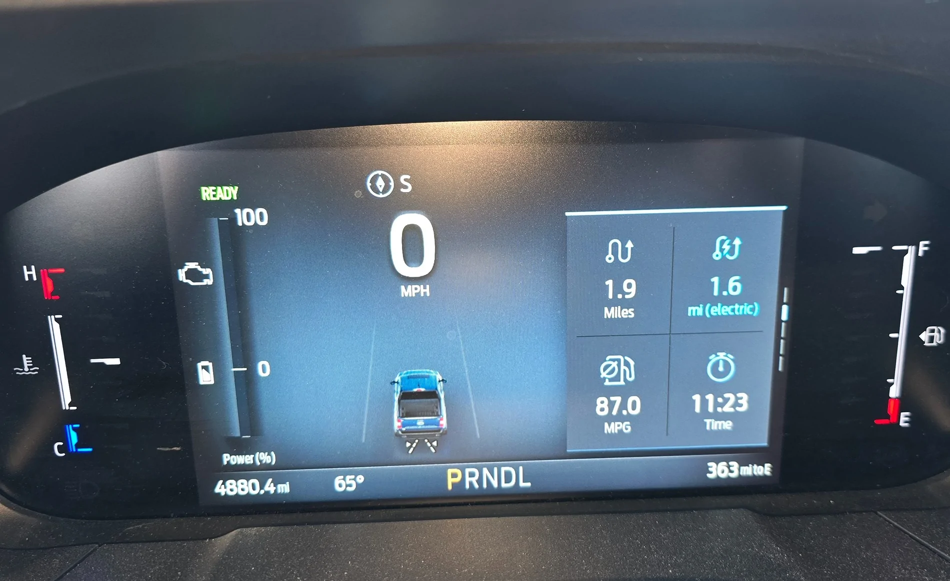

Update: changed the oil, and gassed up. Drove 544 miles on 13.2 gallons. So it appears it is showing empty quicker with this new calibration. That and it probably needs to relearn. Drove 1.9 miles home after fill up, and going through the drive through. Truck now shows 363 miles to empty (after going 544 miles on the last tank) and registered 87 mpg on that short trip home. Truck feels smoother and easier to keep in EV mode. Hopefully this tank is even better, but with colder weather coming, I doubt it. My last tank lasted me 7 weeks, mostly

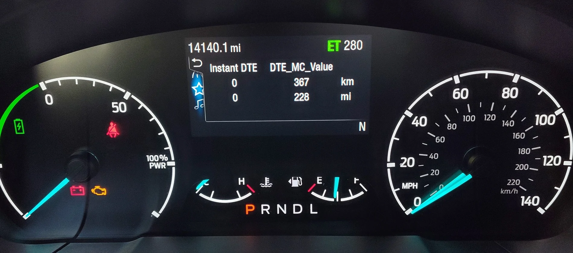

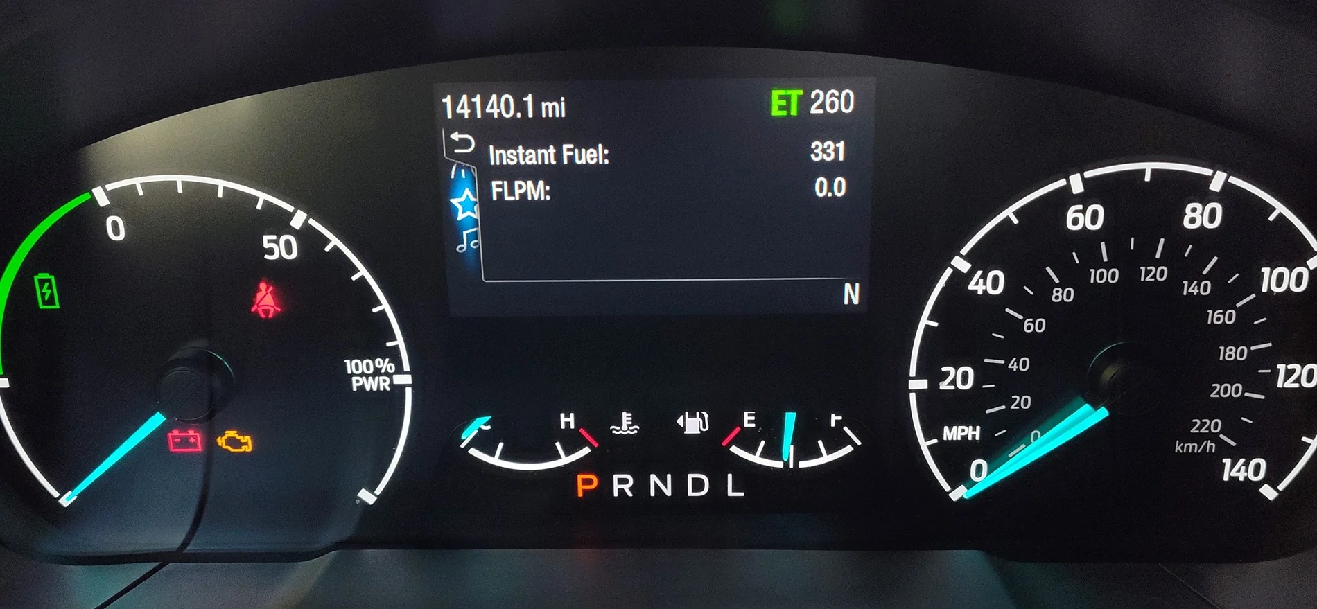

The engineering menu, if any 25MY drivers want to see before and after, has the figure it's using for DTE shown.
Actually maybe, a couple values regarding DTE.
This is the Press and hold the Enter button right side of steering wheel.
Turn key to On (maybe Acc mode works too). So for push-button start, no brakey.
Wait holding Enter button until the green ET shows up hopefully not hidden by popups - so buckle all the belts!
Instant Fuel - last mpg value seen, or what is shown if your Trip option shows it & not EV mode.
FLPM - Fuel Level Percent of Maximum (insert your decimal for correct reading if 4 digits)
if you get a figure, mine was not started, just in On key position. So needed to start.
DTE_MC_Value - DTE Message Center Value, what you already see, but also Instant while running.
RAFE - Running Average Fuel Economy, likely what got reset. But see what it is.
