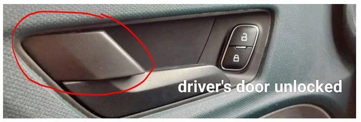

Sounds like your first lock was you pushing the lock lever when you opened the door

Your 1st lock was you pushing the lock lever when you opened the door. Yes, really.
Why it was only your door.
Careful with that - find all sorts of threads on accidentally doing that.
2nd lock was keyless entry auto-response it's being discovered for MY25 - different than prior MY's.
If you leave keys in truck, running or not, and get out - it assumes you made a mistake and protects you by locking the doors after a time limit.
