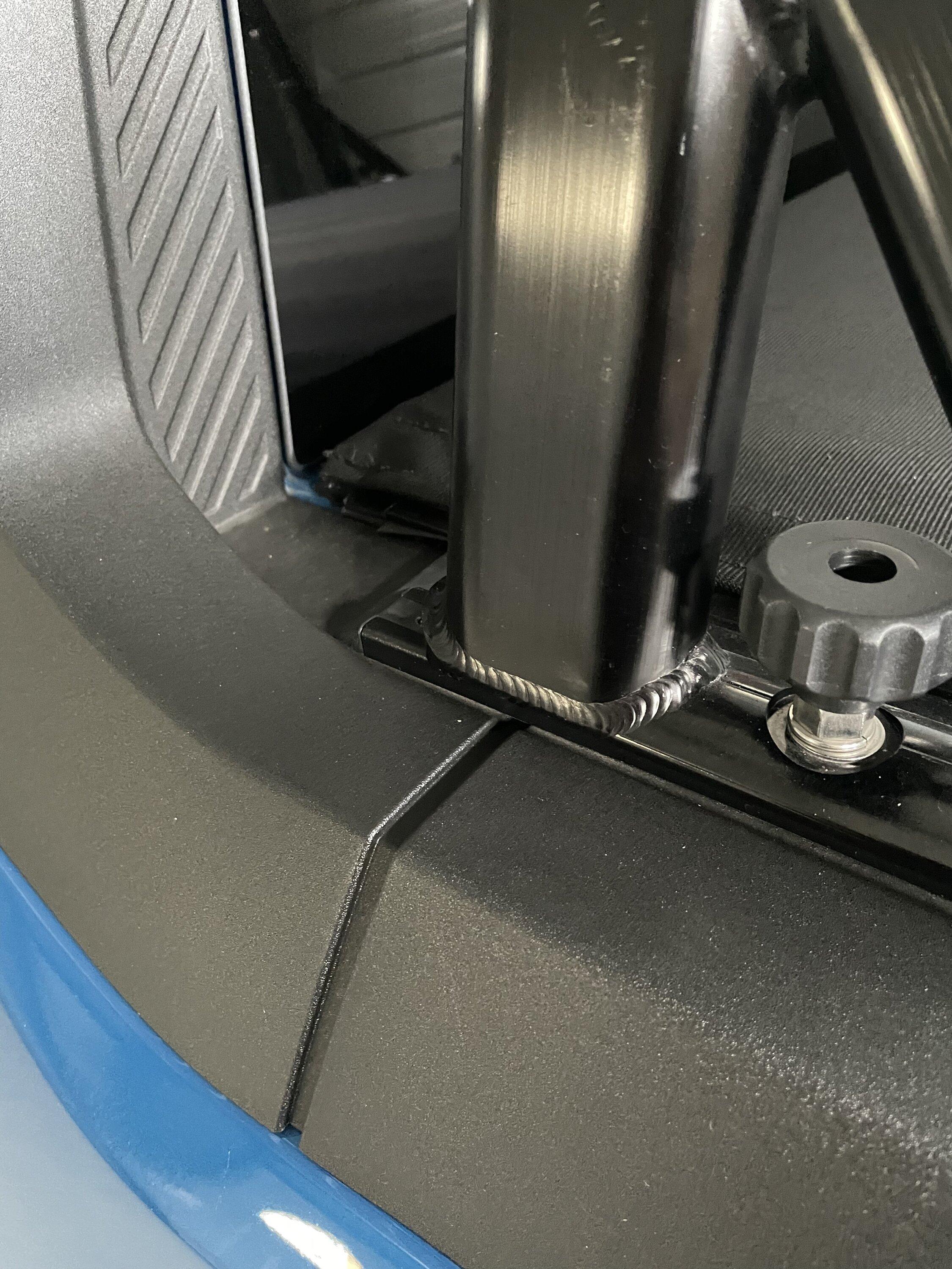

This is the type and size of stripping I used. It was put down before the rail was set so that it could be fully compressed and concealed.

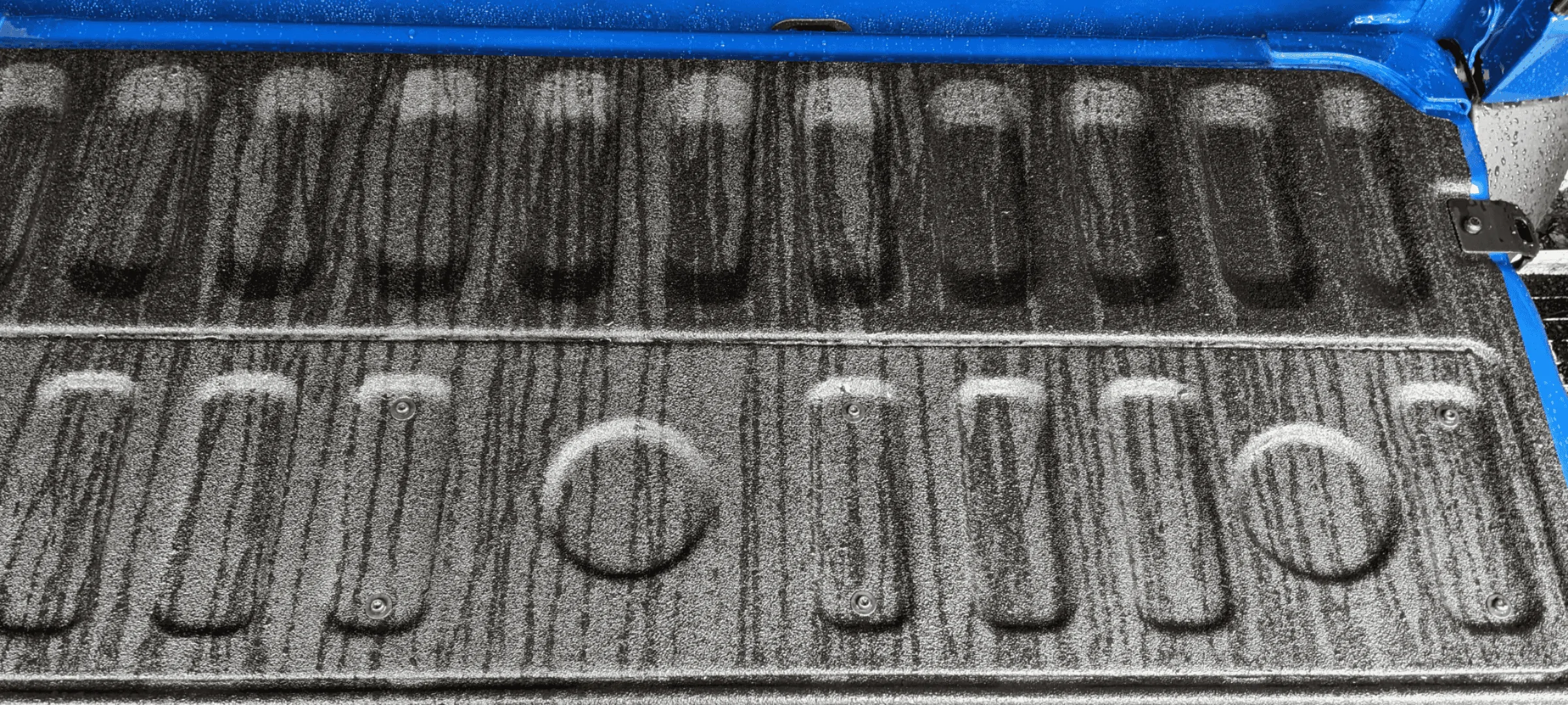

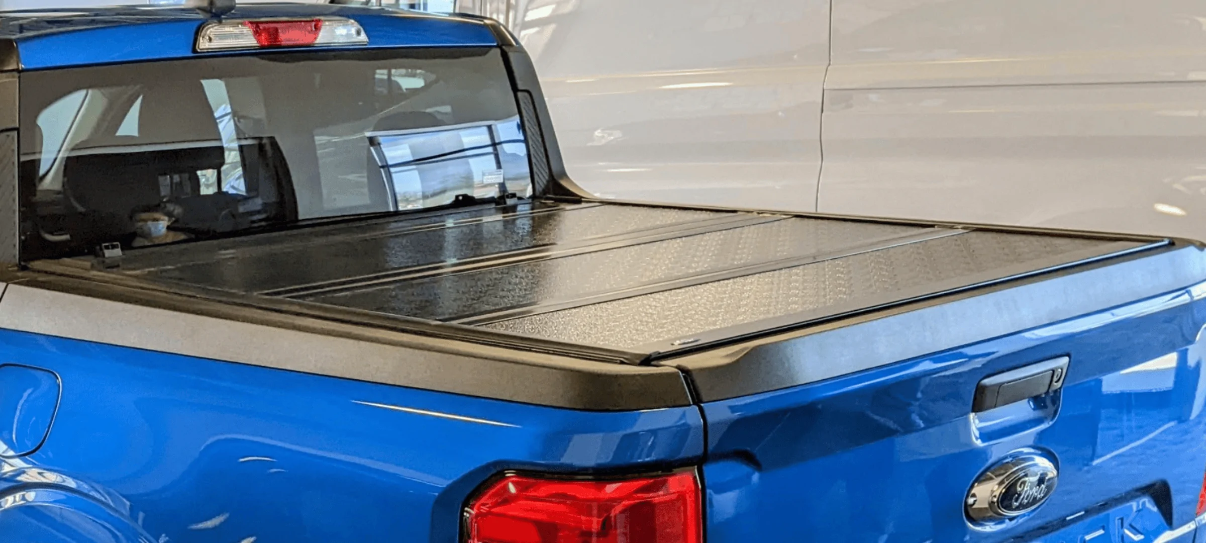

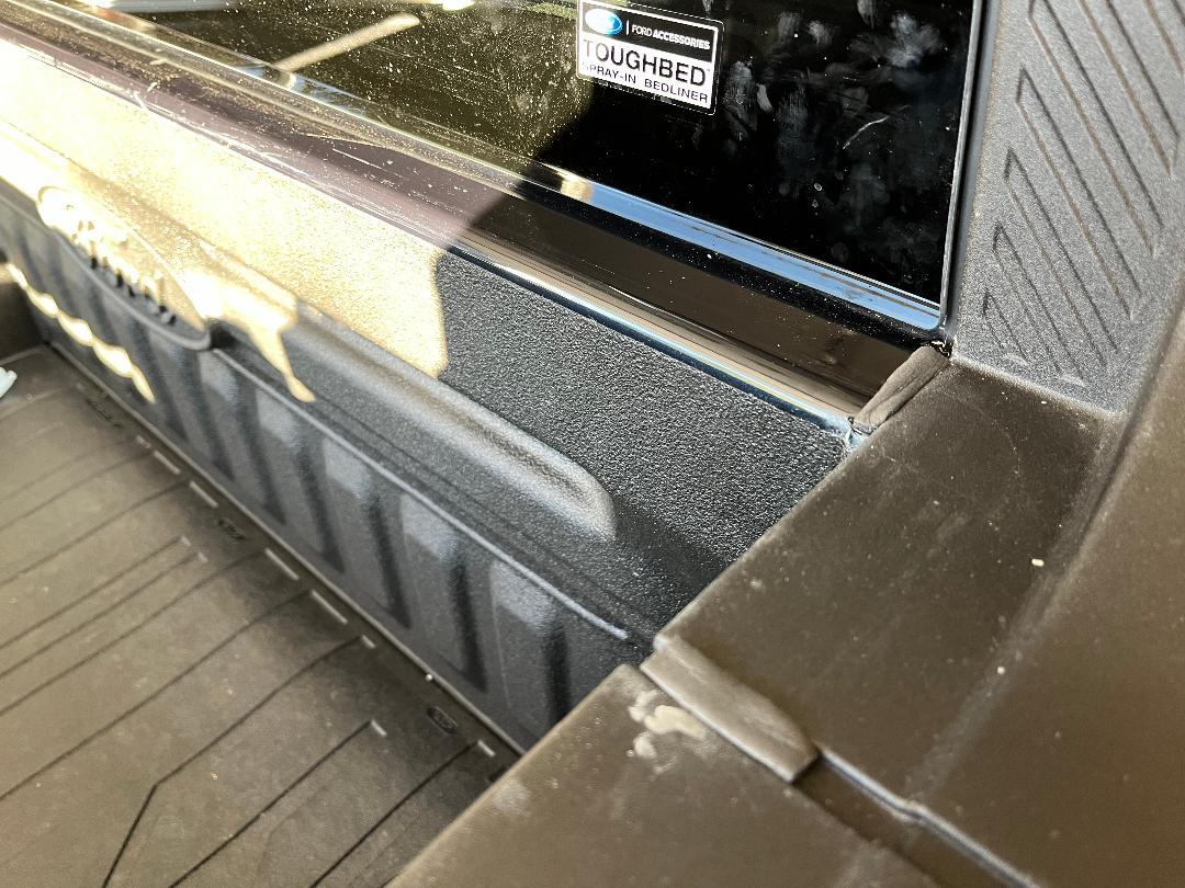

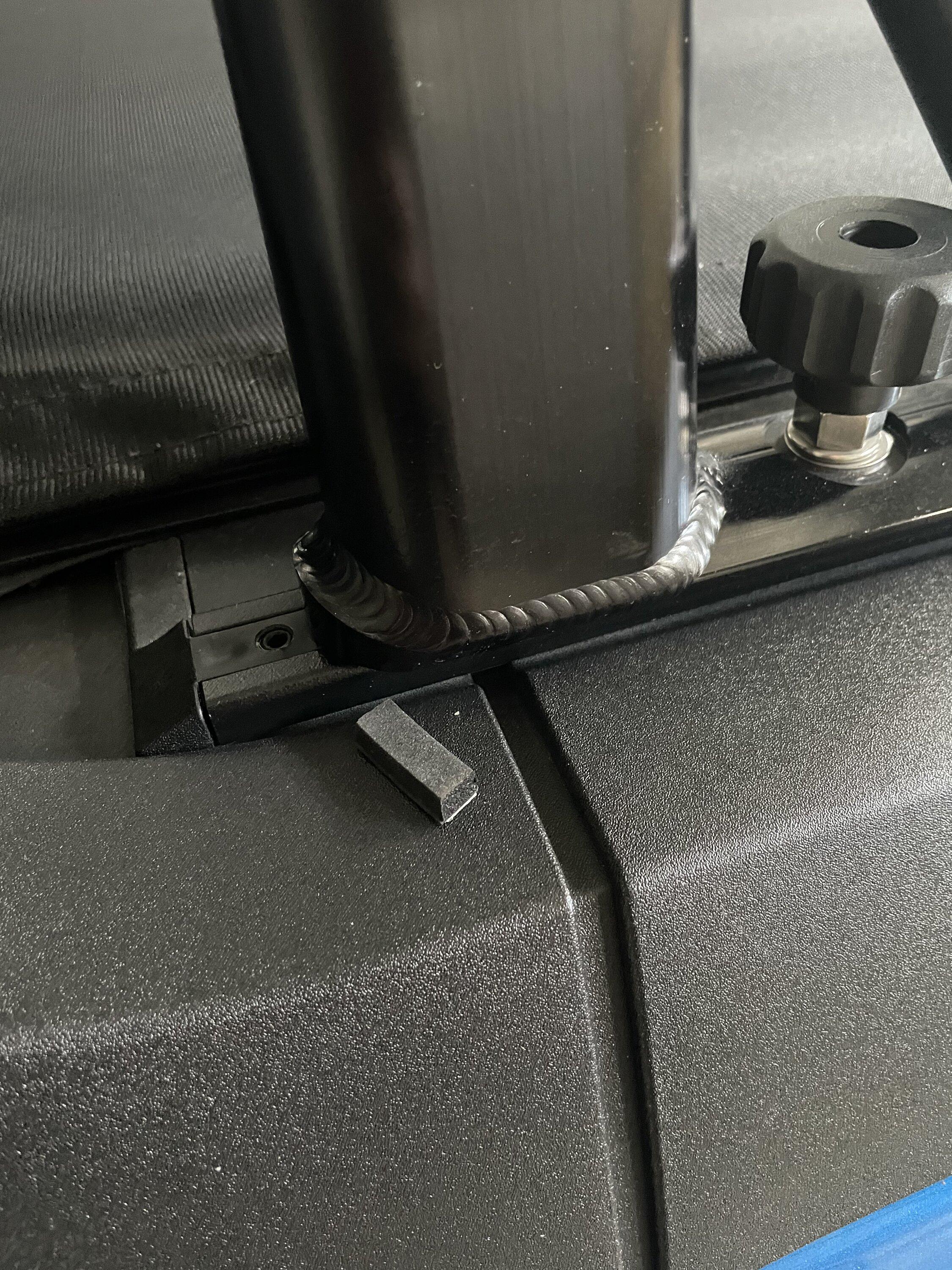

I put some rubber seal in the weld joint and the gap in the bed cover trim (see pictures). I decided against the silicone calk. I was afraid all I would do is trap the water and cause a bigger problem with rust later on the water that drips in now seems to run out through the drain holes under the bed pad on the floor. I have some gasket material to place on the bed rail and tail gate that I was given to by the camper shell place I visited yesterday. He basically told me no cover is fully water tight. I am going to live with the dribble I have now because it is much better than before. Good luck because some times you just have to live with what it is. I have spent two weeks trying to get leak proof and I give up.

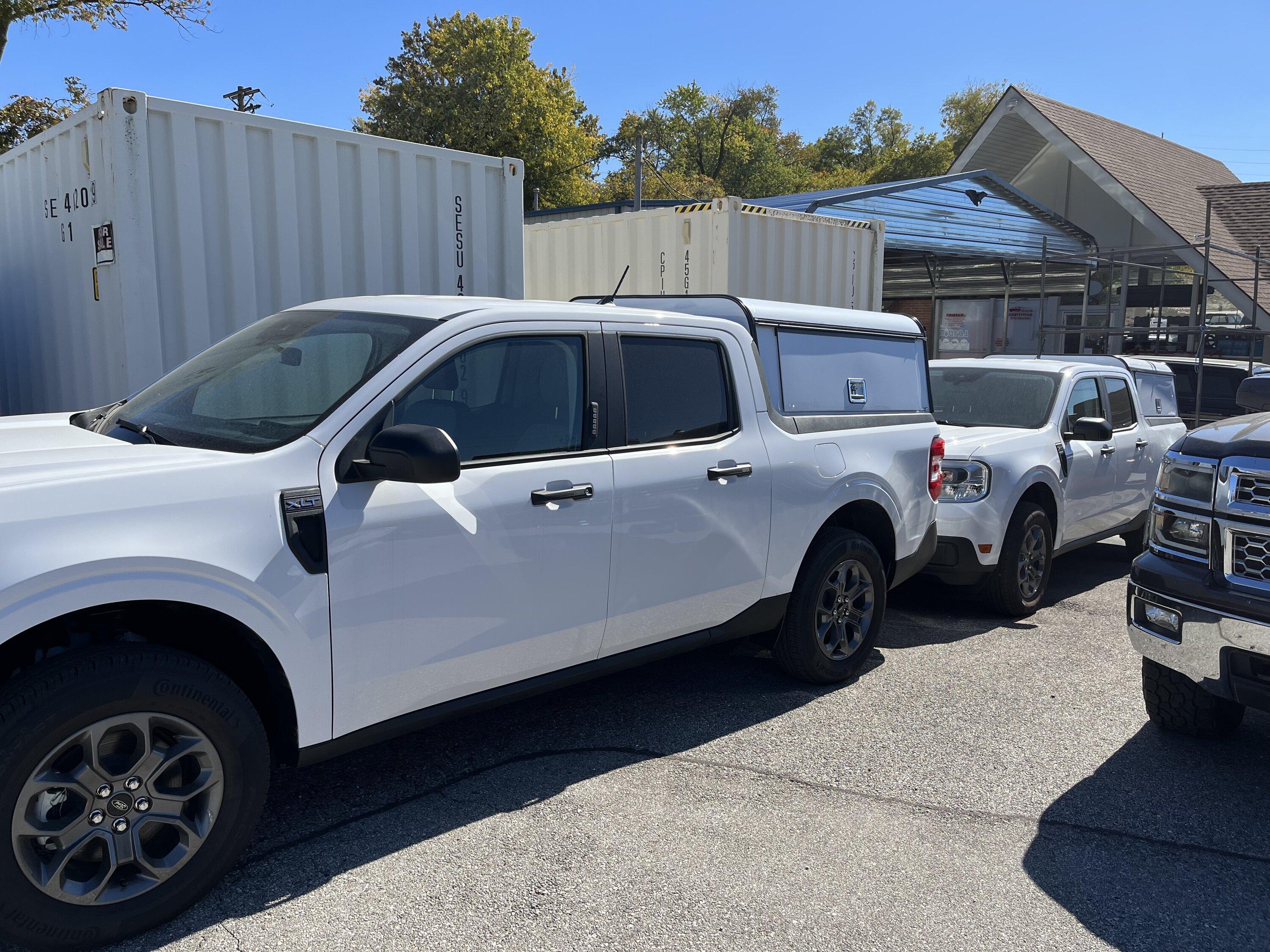

As a note picture two is showing 2 of 12 Maverick XlT’s at the camper shop having shell’s installed. I saw 6 at a ford dealer two weeks ago some one is getting deliveries in the fleet busines. I didn’t think to look if they were hybrids.

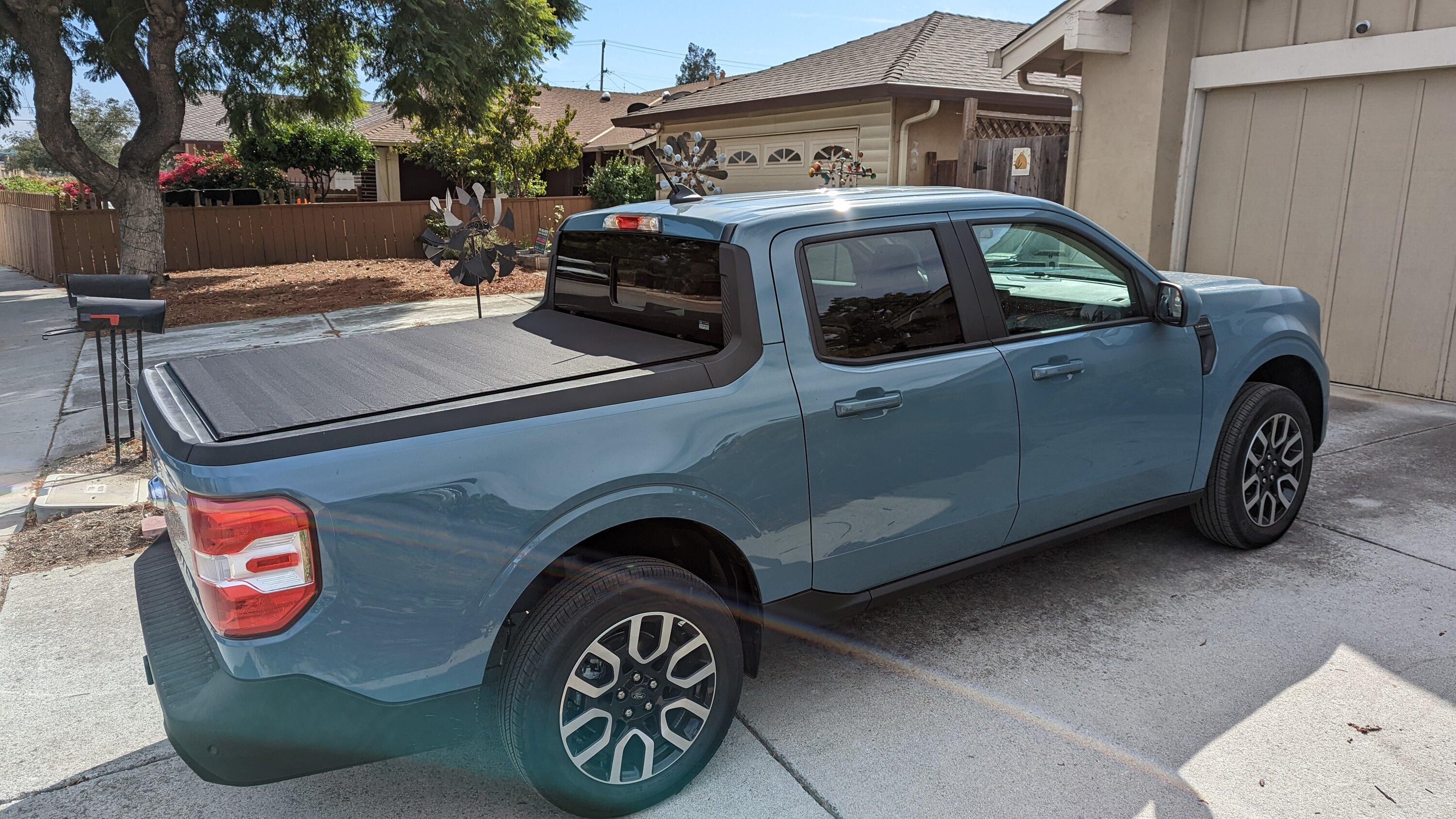

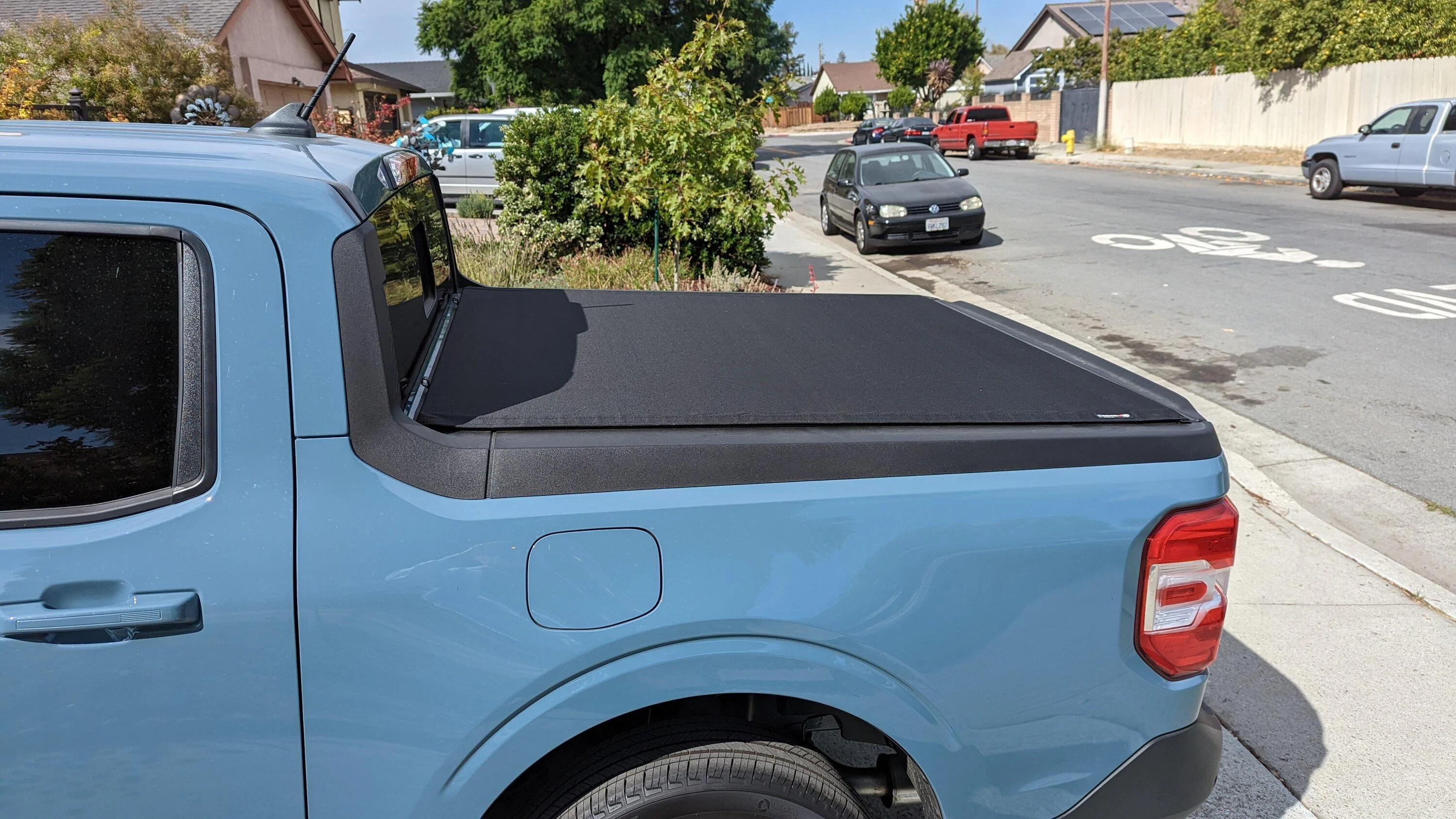

I installed a Truxedo Sentry CT cover yesterday. I doubt it's watertight, but hey it's a truck and it sure looks purdy.

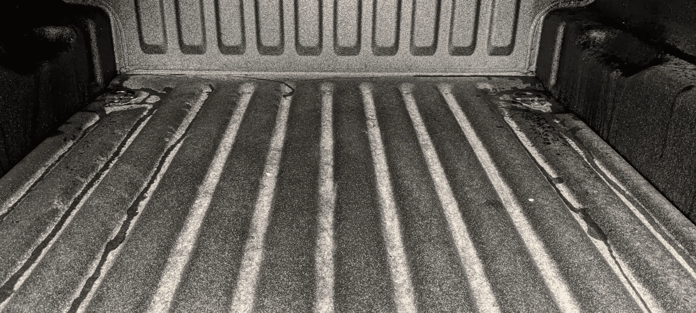

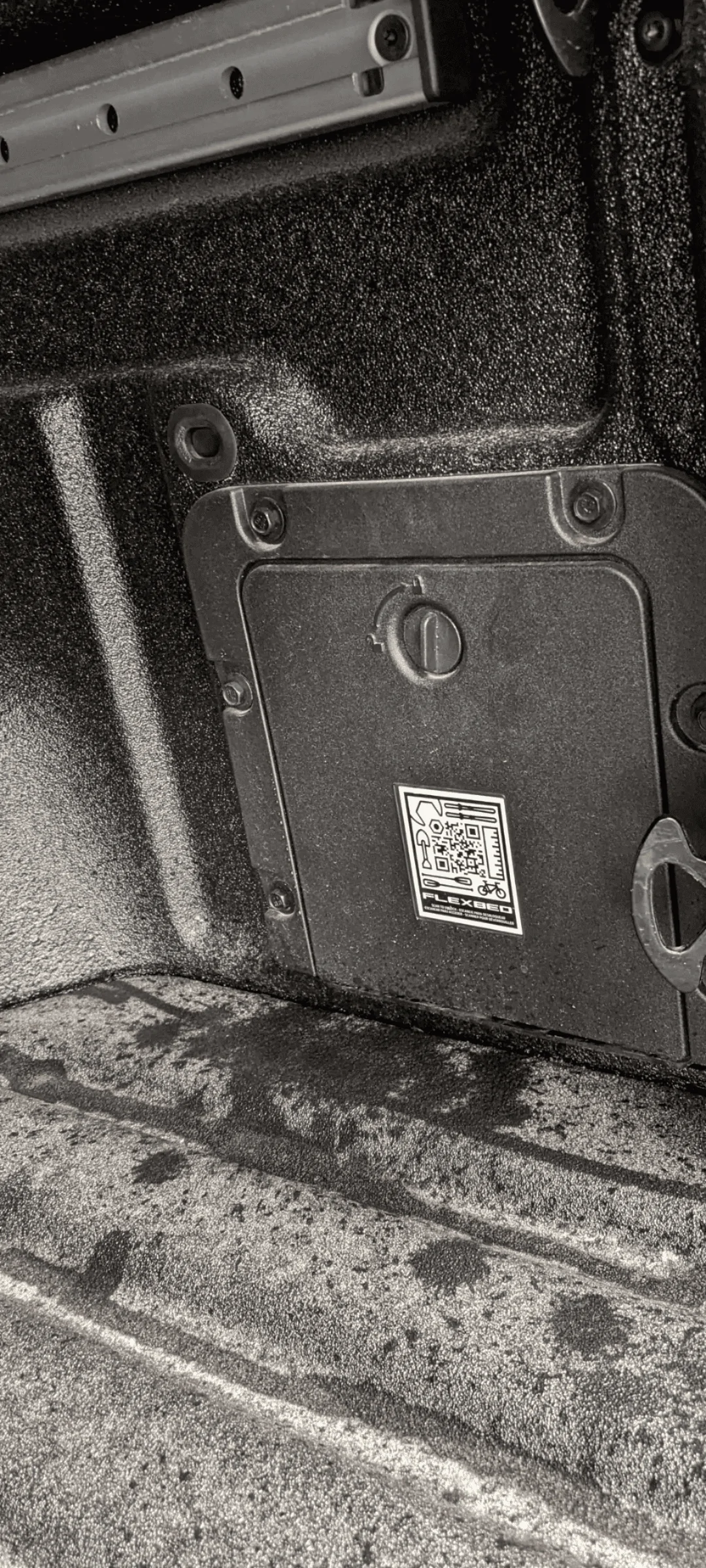

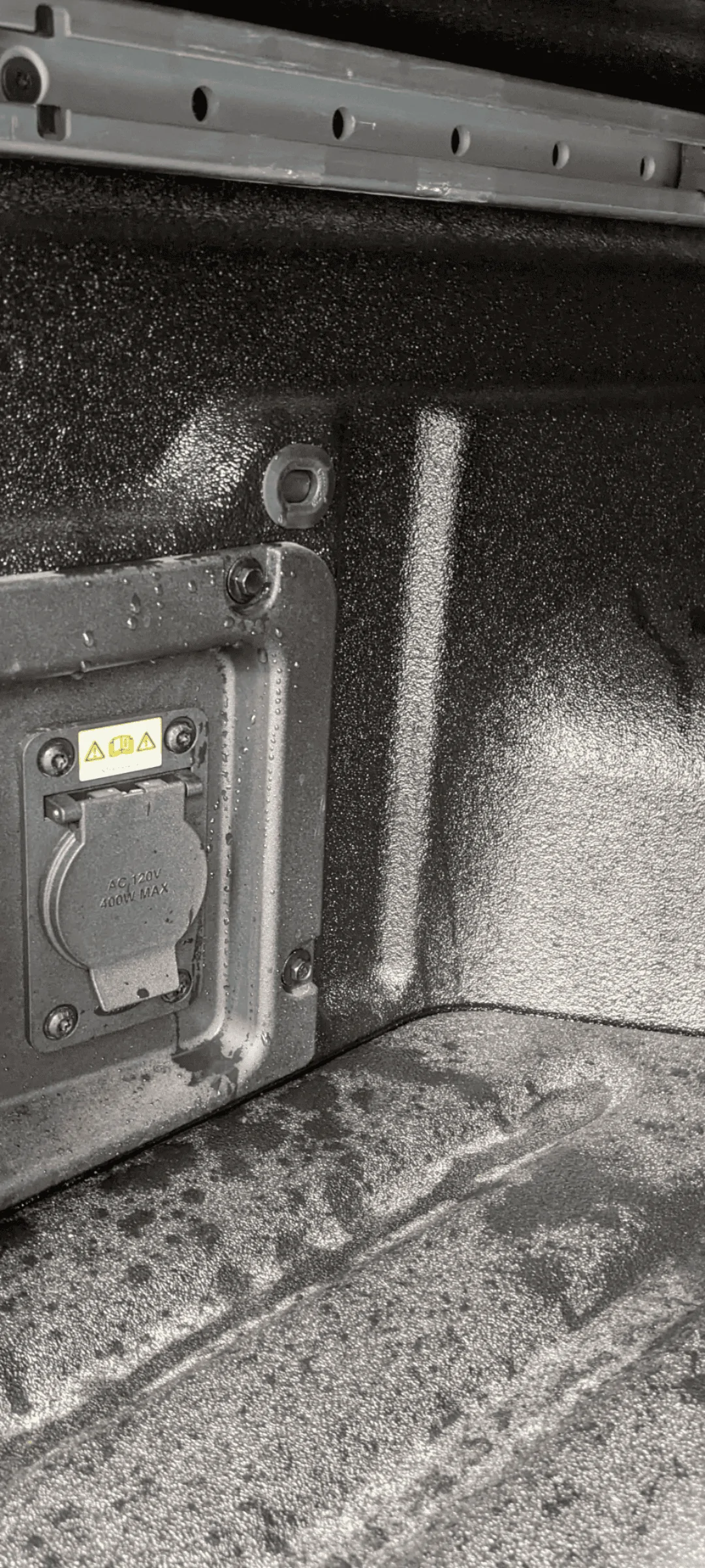

I had quite a bit of water at the beginning right after picked up my Maverick (pictures are one week after picking it up) I loosen the cover from the rails and adjusted it a little better. And now there's hardly any rain in the bed. I also think the Sun helped soften the rubber and helped it lie a little flatter.
