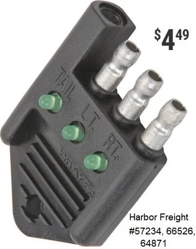

Sounds like you do indeed have an issue. I've seen some bizarre electrical problems that arose from a bad ground, so it may be as simple as that, although you would think that the trailer hitch would have enough connectivity when parked that the WHITE (ground) wire would be unnecessary.
The ground pin on the end of the 4-pin trailer connector goes thru a couple of connectors on its way to the truck's chassis ground, so this would be easy to check with an ohm meter. It's the only exposed pin in the truck's 4-pin connector. While you're at it, check the trailer side too.
I picked up this cheap tester at Harbor Fright and it's been useful. My truck is sensitive enough to think a trailer is connected when it's installed.

Looking deeper, the tail lights on the trailer connector are powered from a relay in the BJB (Battery Junction Box) that's controlled by a signal from the BCM (Body Control Module). Tail lamp power also goes thru 20A fuse #55 so if you short it out during testing that would blow and keep it off thereafter. Standard trailer wire colors are: GREEN = Right Turn/Stop, YELLOW = Left Turn/Stop, BROWN = Tail/Marker and WHITE is chassis ground.
