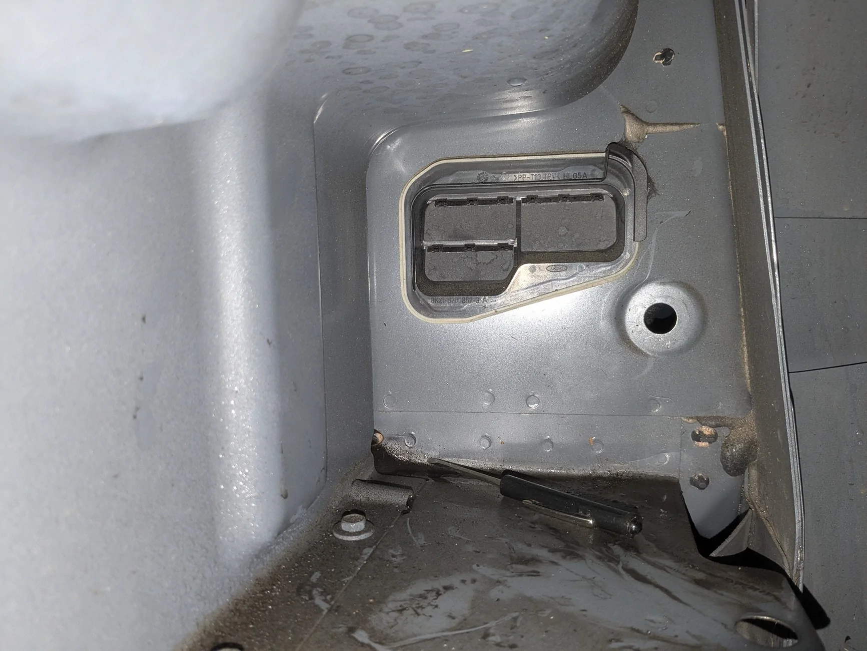

I removed passenger rear fender liner, not too terrible. There is a small hole with a plug near the cabin vent. It was easy to push wire in through that hole and grab it from behind the seatbelt trim piece behind the rear seat. I cut a slit into the round rubber grommet, pushed the wire through it, and after I got it all setup I put it back and slathered some "liquid electric tape" all over it to keep bugs out. (looks like black rubber cement).

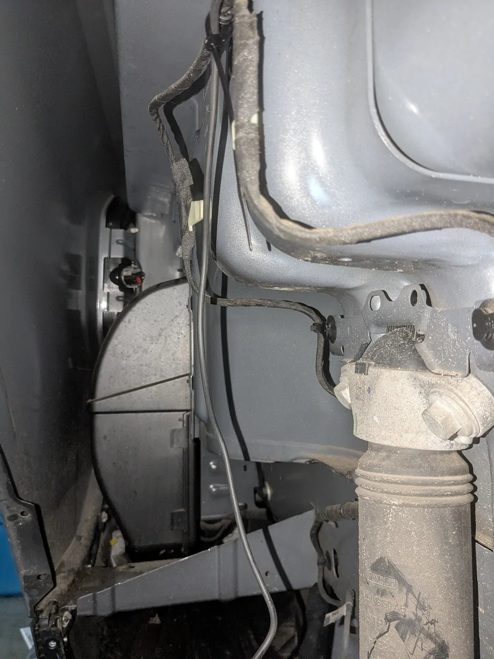

Then there isn't much up above the fender, ran the wire to the rear taillight with a zip tie on the one cable above the strut. That stuff on the upper left is the rear taillight.

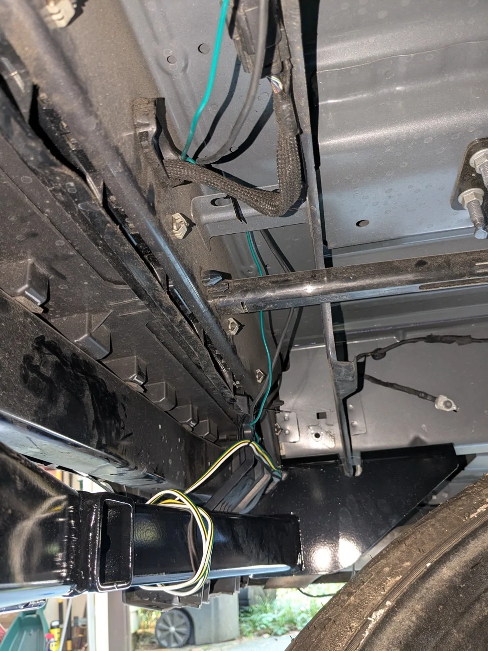

So I dropped the splash shield and spare just to get more space. I got things run and closed up the passenger tail light then realized the wires would be caught up in the spare. So I opened it up and pulled the passenger wires to route them above the spare tire winch handle tunnel.
The black wire is power from the battery under the seat going down passenger rear fender then to the trailer light module which I mounted below driver side taillight.

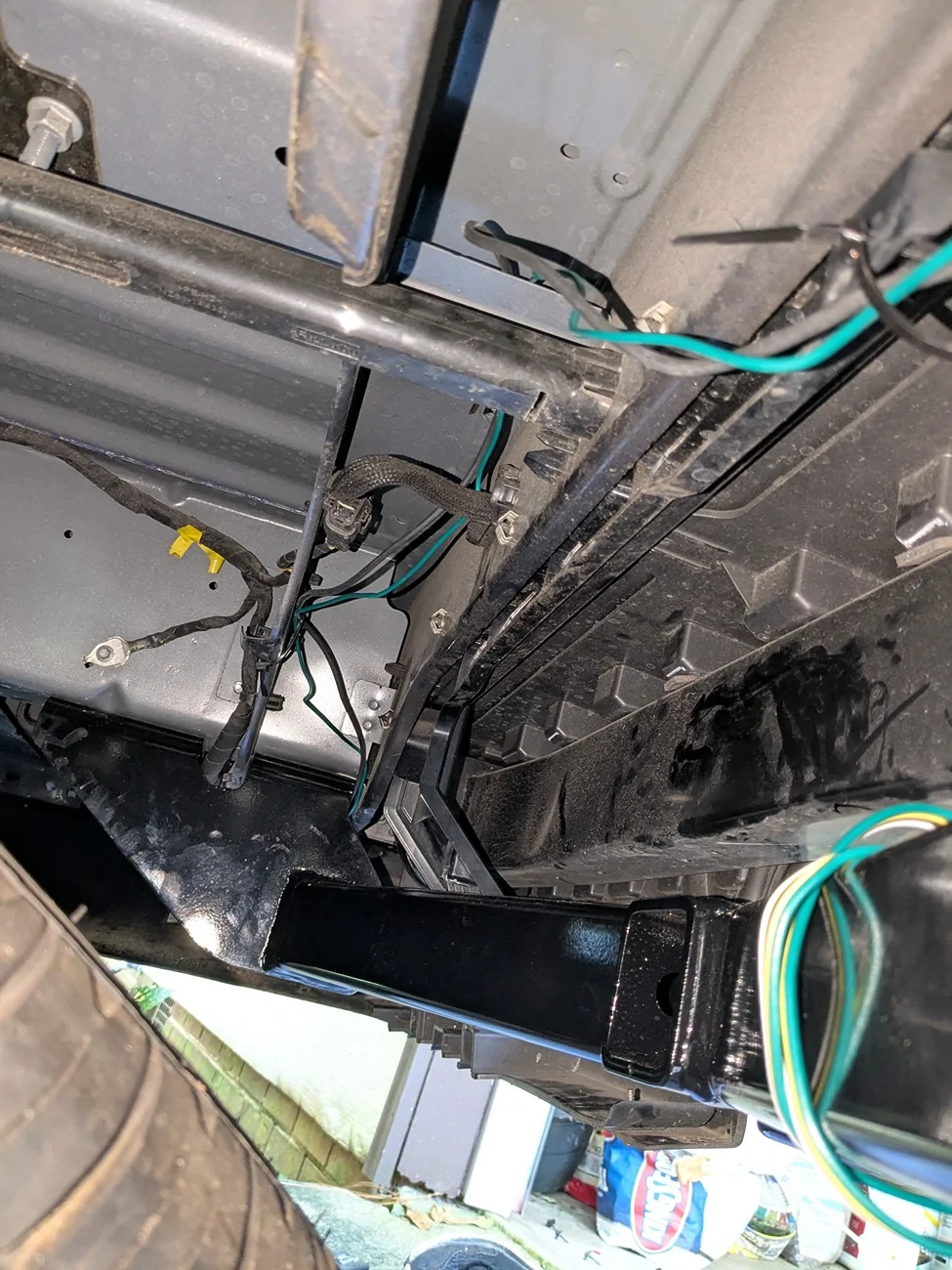

Here's looking towards driver side.
I'm VERY IMPRESSED with this taillight module- I tested it before the power was hooked up and the tail lights still work 100% fine without power. That puts my mind at ease- won't worry about losing rear lights if the fuse or wiring or module have issues.
