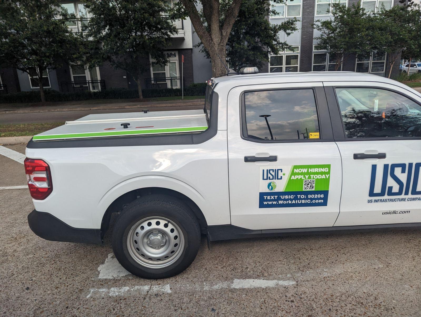

Rigorous use? Not sure about that - but our local utility locators are running them. I’m seeing more and more using them as delivery or service vehicles.
Ford Maverick Using Hybrid as work truck B351AB27-59C1-41A6-99DE-8BC7D7CB2729
