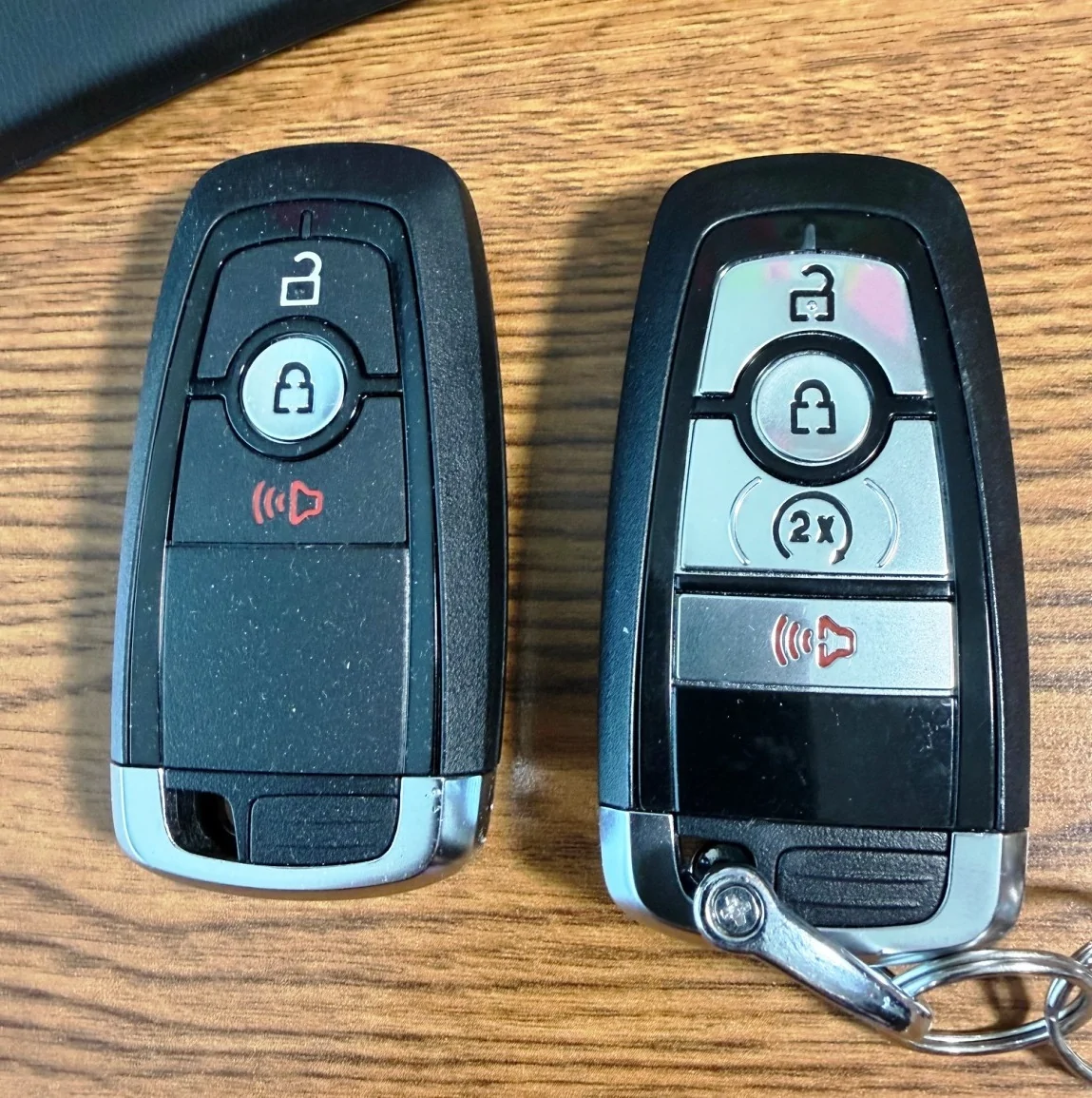

My '25 XLT came with the 3-button FOBs, no remote start button. Read that it can be upgraded with a 4-button FOB as they all come with remote start embedded. I bought a 4-button with remote start on Ebay ($56) for a '25 Bronco Sport. Easy to program the 3rd one and just put the cut key onto new remote, and traded Bronco battery cover for the Ford cover. Although maybe I should leave the Bronco cover on so if I loose the FOB they will look for the wrong vehicle. .. :LOL: .. Original FOB on left and new on right.

And this works to remote start?
I am thinking of doing the same thing. I was waiting until the price came down. I see that it did. So I may do what you did. I do know that the 2025 has a different key fob then the 2024 and earlier vehicles.

Great upgrade!

Yes, it works. And you can still use the Ford app to start Mav. too.
I have a 2025 hybrid xlt with the 4 button fob but I haven't been able to get the vehicle start to work

Hmmmm - same year/trim.
Down to some settings differences if not production run difference.
Sounds like Vern has truck connected up for Ford app remote access to work.
Bill - got the same?
I could see if truck isn't setup for potential remote start - why enable some functions.
The truck also has options regarding the remote start.
How do your settings compare?
