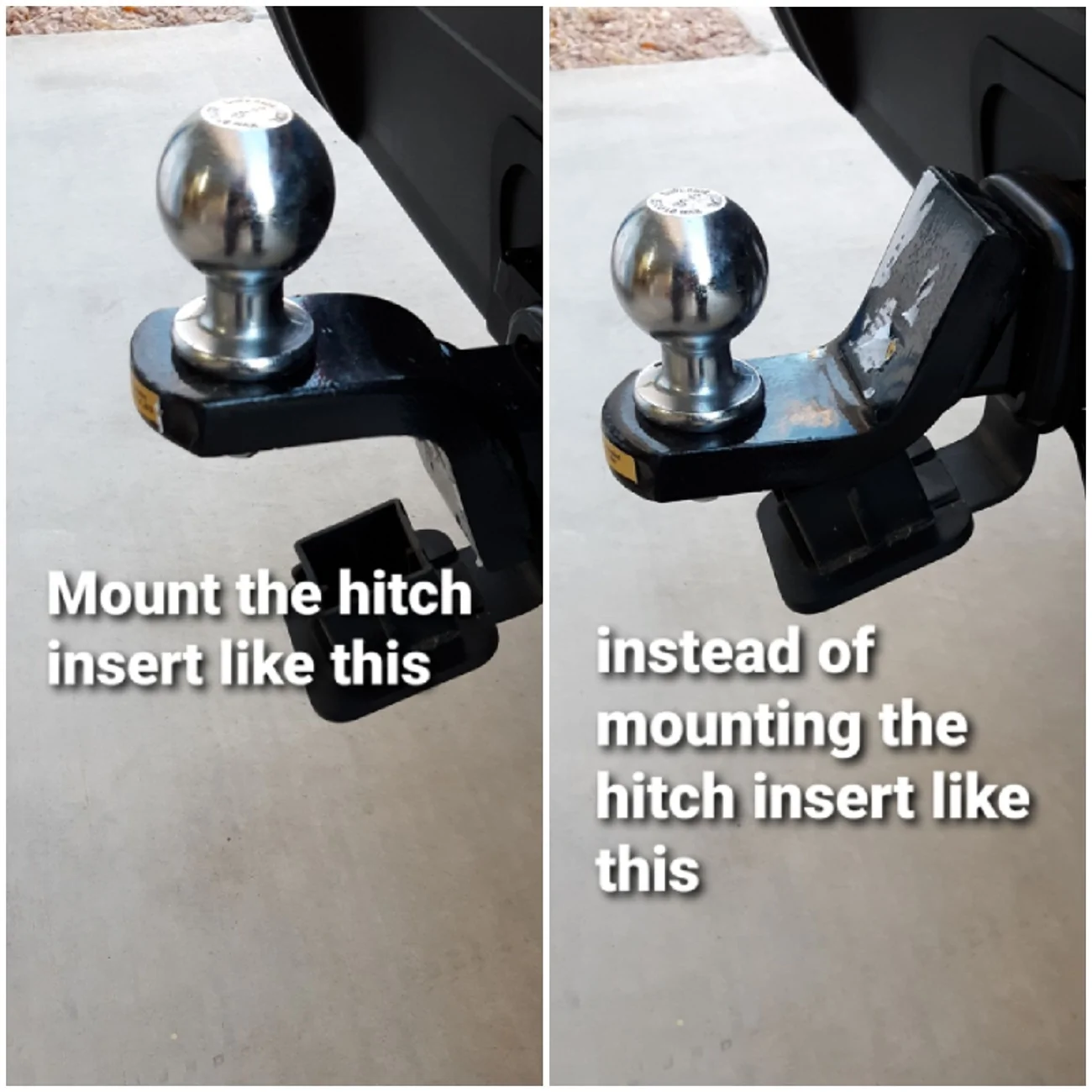

From the Uhaul FAQ page:
"The optimal ball height for towing U-Haul trailers is 18½ to 18¾ inches. This is measured from the ground to the middle of the hitch ball, prior to connecting the trailer"
On a normal Maverick, a 2" drop hitch gives 18 3/4" to the middle of the ball (see picture in Hot Runr Guy's post), and Tremors are about 1" taller than that. Uhaul's maximum allowed height is 25" so you'll be fine with a 2" drop which should sit at +/- 19 3/4" to the middle of the ball on your truck. If you want to be super anal about the ball height you'd need a 3" drop, but I've never seen one and a 1" difference doesn't matter. Or, get one of these, but they're very expensive:

2inch ball with a 2 inch drop was perfect for the uhaul 6x12 trailer
Good to know! When I (hopefully) get a Maverick, maybe I'll trade with my racing partner who has the same setup but could benefit from an adjustable ball mount. I only ever tow U-Haul trailers and he's got the 2" drop.
Did the trailer sit level with the 2" drop? I like to tow it slightly nose-high to keep the coupler out of the sidewalk on steep driveways, so I might try flipping it around so it's in the 3/4" rise position.
yeah it was leveled with the 2 inch drop
With a Tremor and it's higher ride, it is slightly tilted up for a 2" drop
