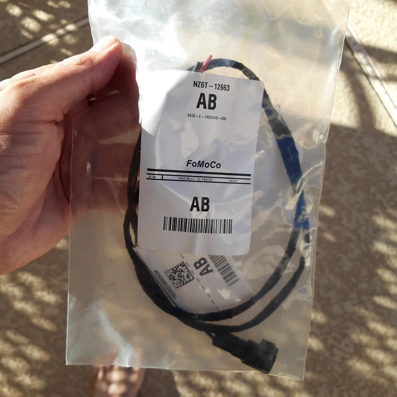

Here is a picture of the pigtail, that
"MavStangVa" referred to in post #3.
This is what you're looking for👇

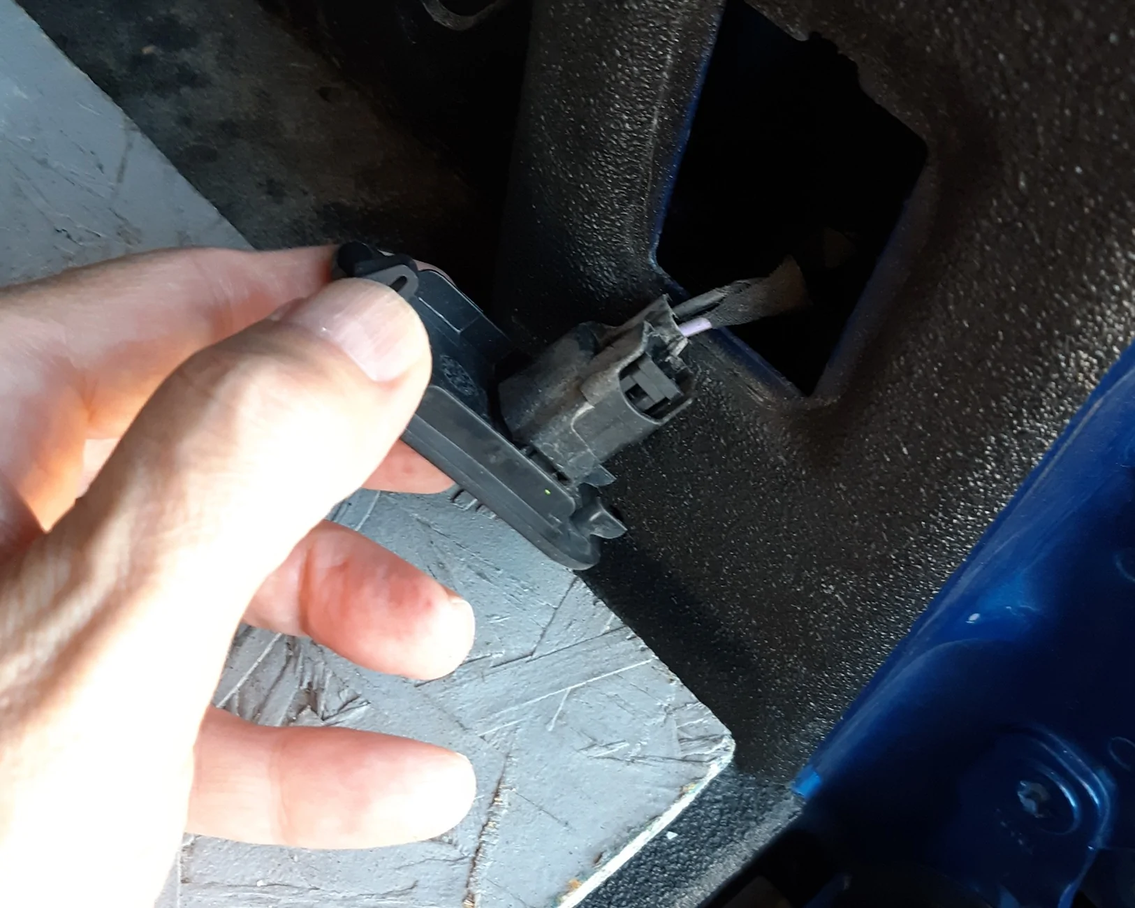

This ☝ will plug into these bed connectors.👇 The connectors are plugged into a dummy connection on the cover plate, in order to keep them clean.
I did get that wire harness (glove box) but was unaware it was for the 12V accessory connections.
Thanks for the heads up. I guess the connector has to be mounted through the clip-in plate.

You can run the wire up or down from the cover plate. I ran mine to the storage box where I installed a battery with charger, bed lights and a 12 volt plug and usb plug. Lights turn on with 433mhz remote. Now I have power whenever I want it, not just when the truck is running.
