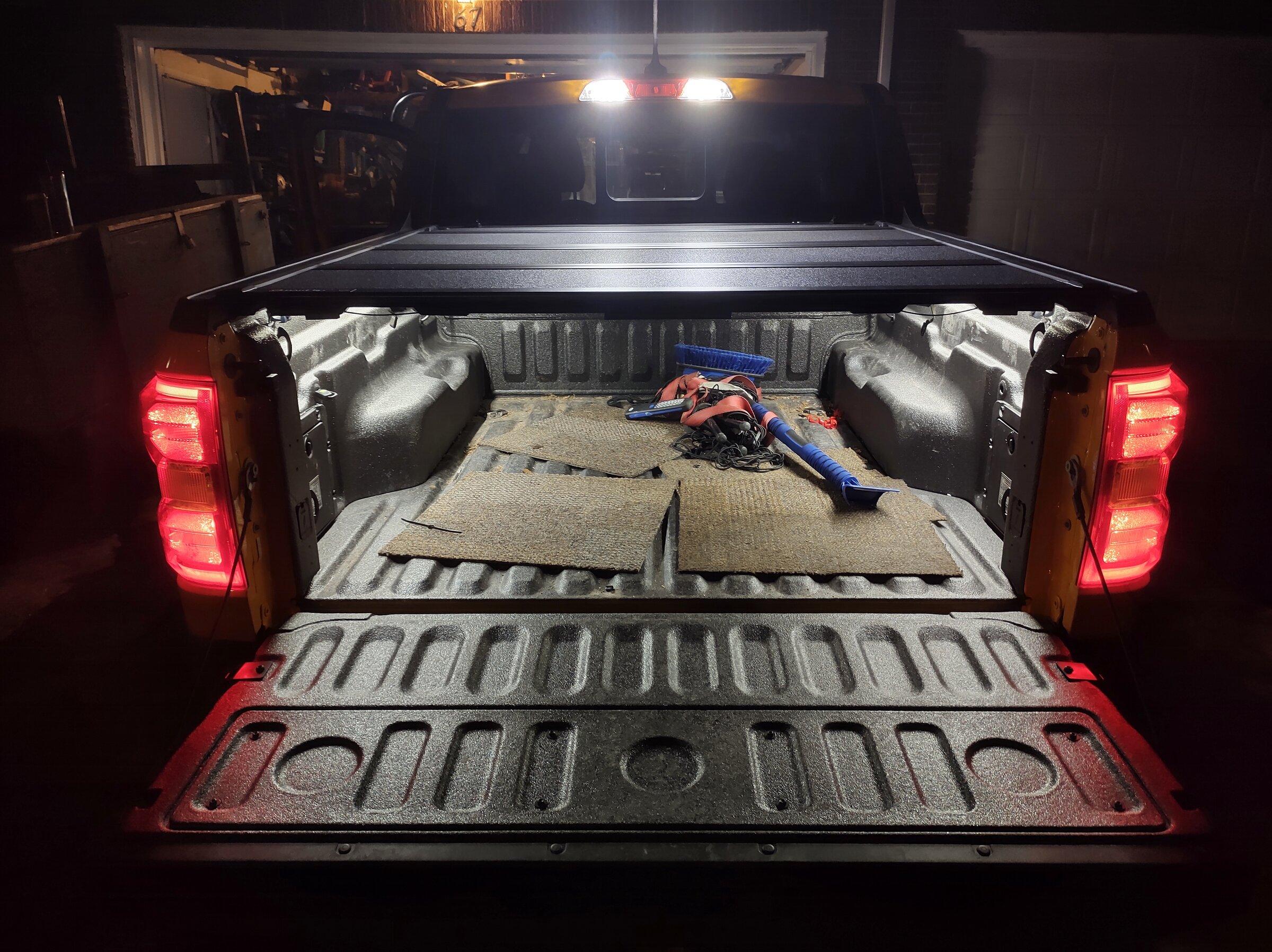

JUst installed these truck bed led lights:
www.amazon.ca/dp/B0711FYXSM/ref=redir_mobile_desktop?_encoding=UTF8&aaxitk=224e15942f48c0104cddc24f8a9b0012&hsa_cr_id=7973791700601&pd_rd_plhdr=t&pd_rd_r=caf49290-5cbb-4611-bc71-e72c4a301713&pd_rd_w=YR3e9&pd_rd_wg=t33DF&ref_=sbx_be_s_sparkle_mcd_asin_0_title

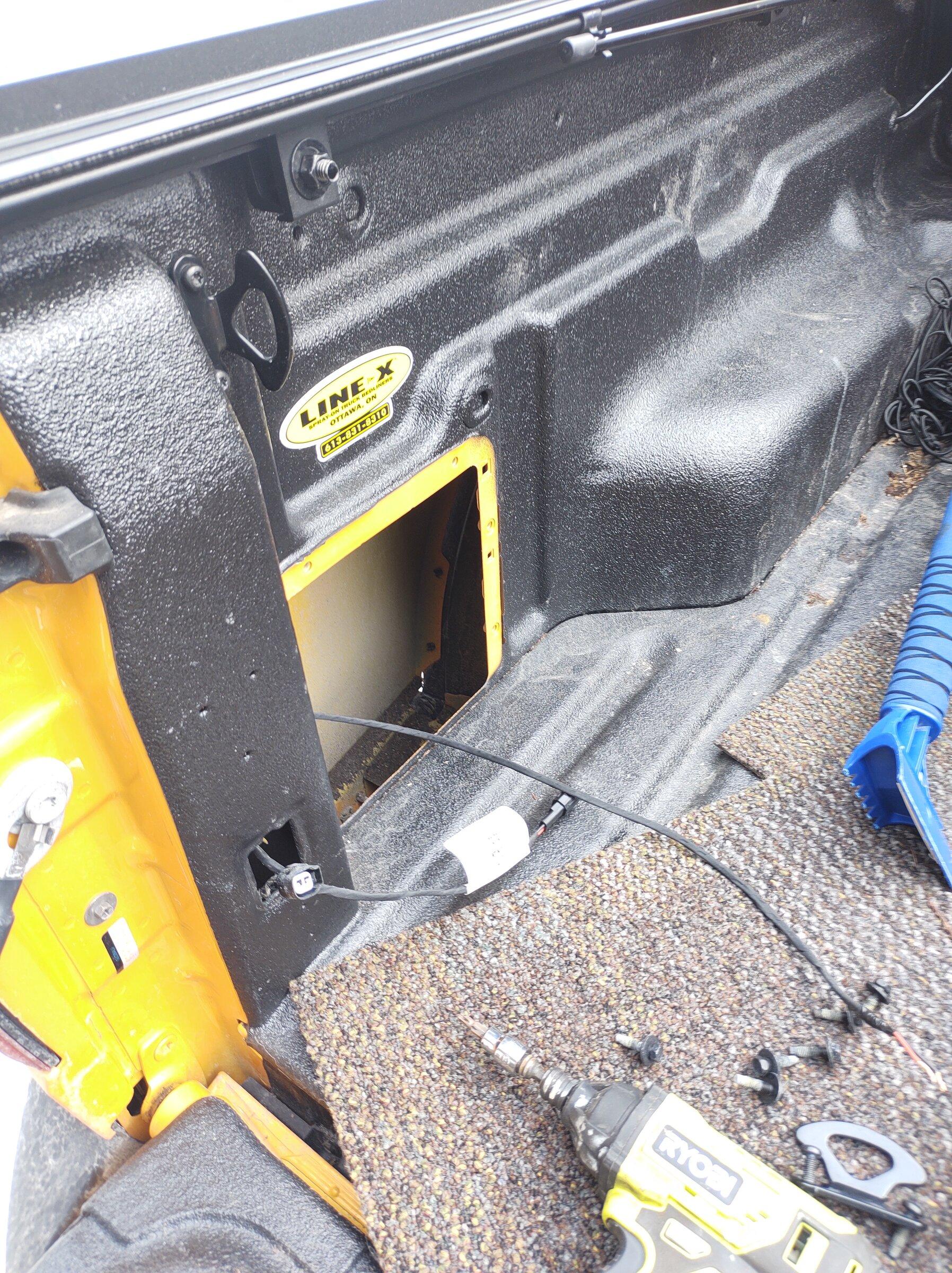

Had to trim the LED strips down to about 4.3 feet and mounted them to the toneau cover rails. Stock wiring does fit across and the pockets are fully removable for wire routing through the grommets. Used the 12 v power plug on the left side bed. You will need a 10mm socket to remove bolt pocket and T27 torx to remove lower rear anker point (need to remove to get pocket out).

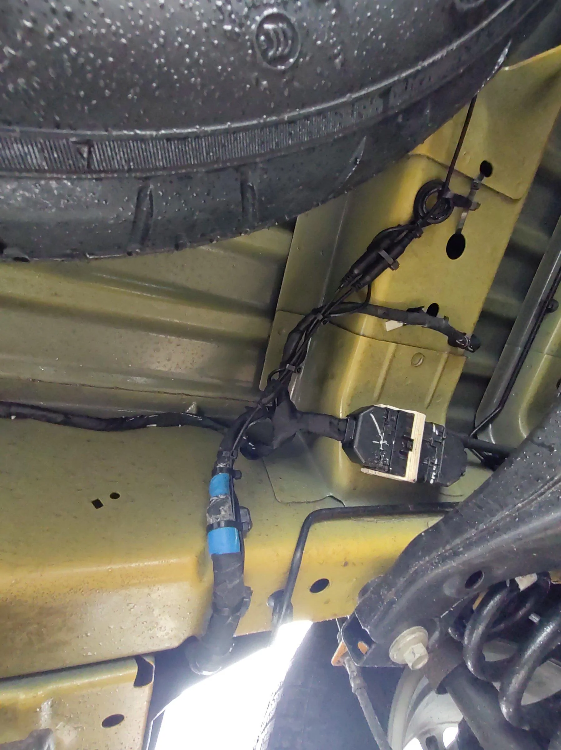

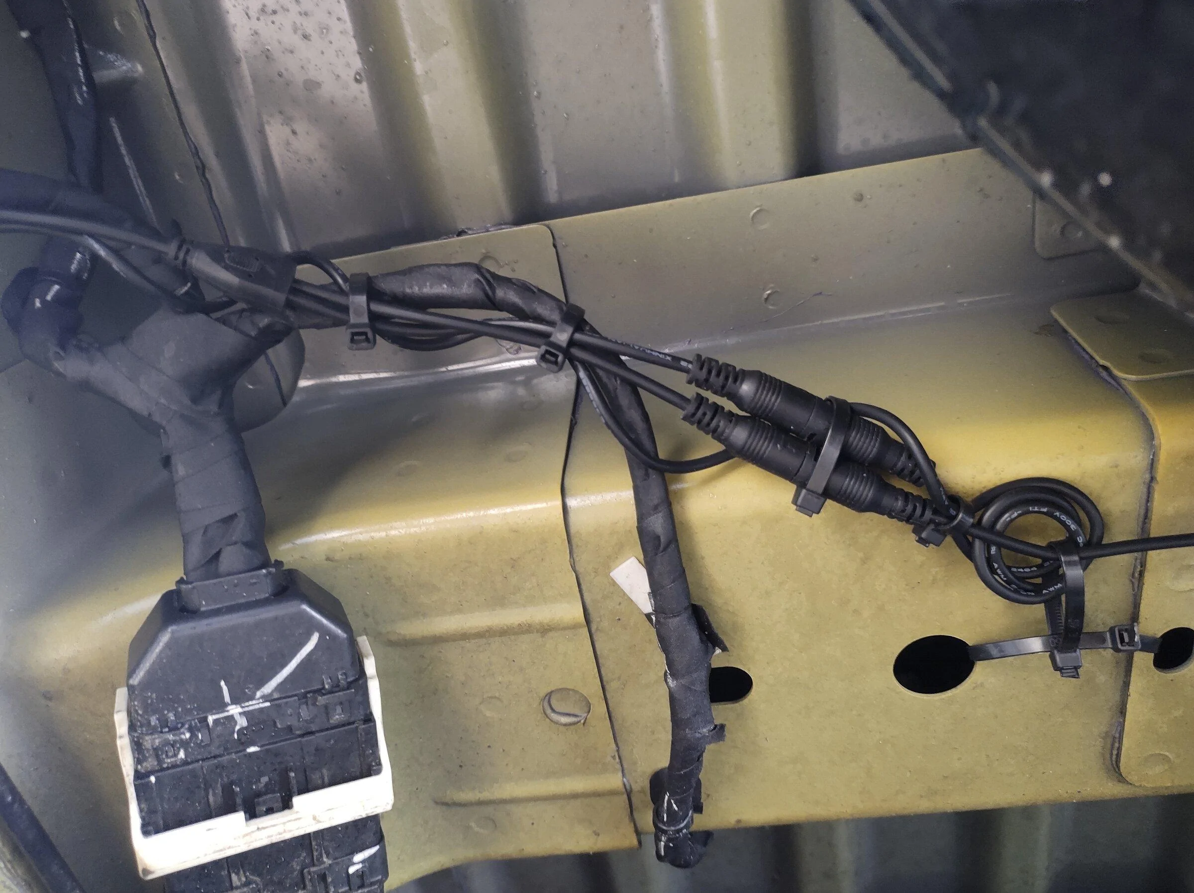

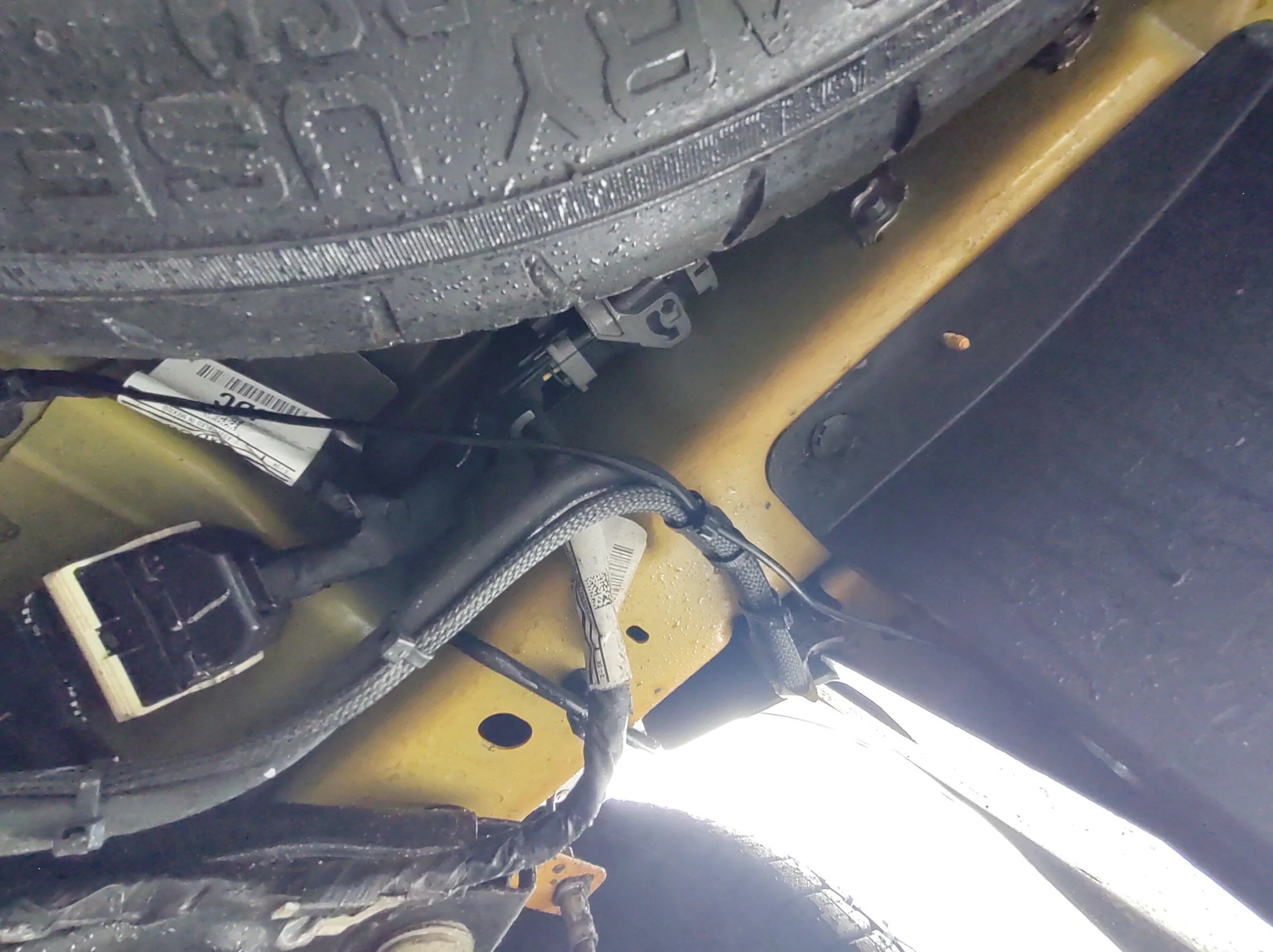

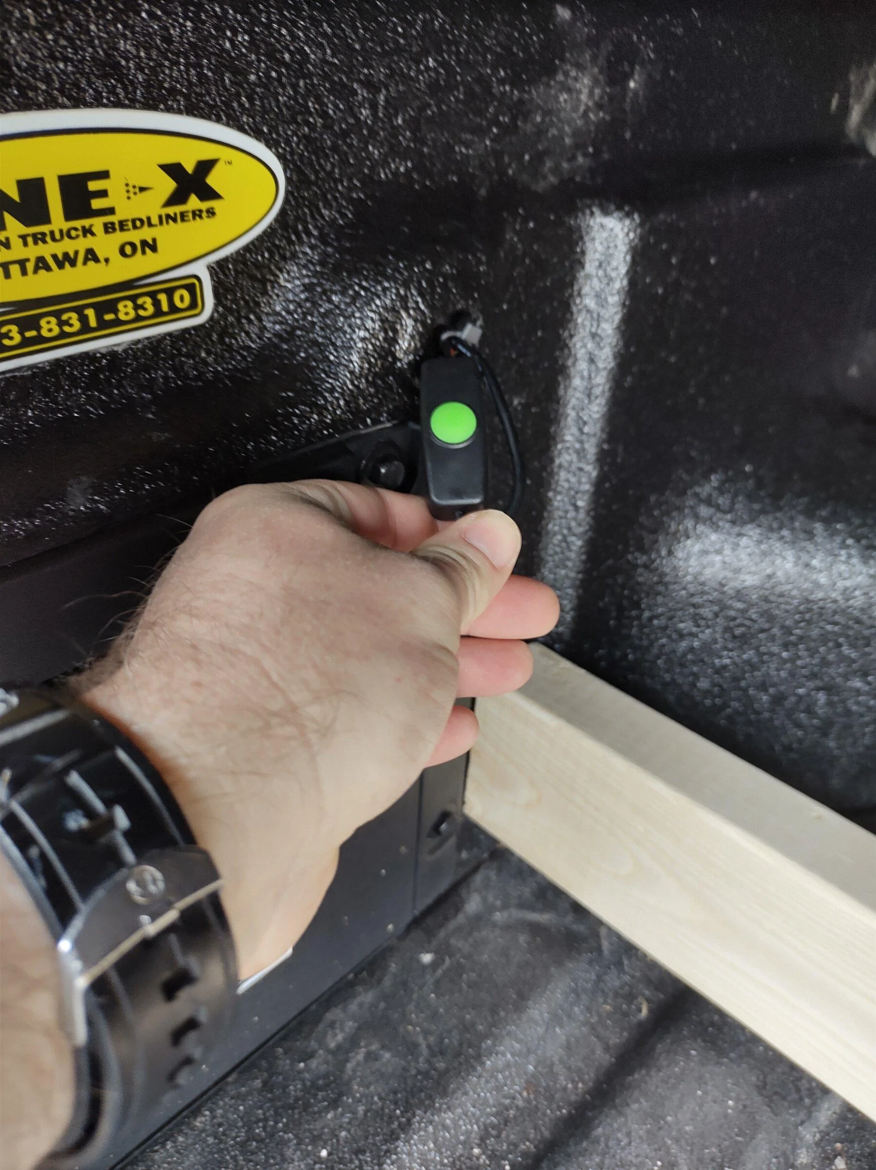

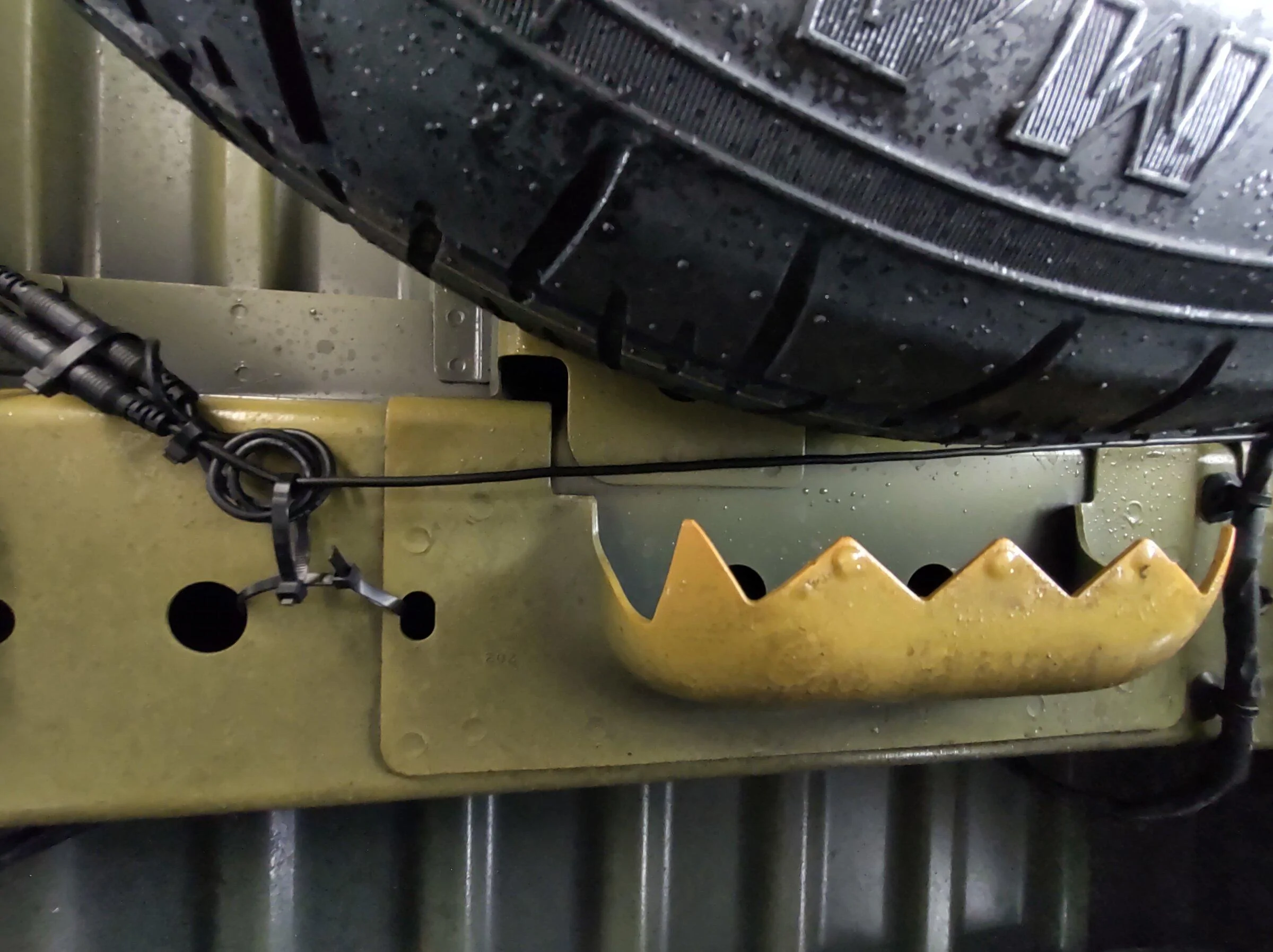

Looks great, Roy! Could you show where you ran your wiring to power both sides? Under the truck, under the front of the bed, etc. Also, did you mount some type of switch, and where? Thanks.

See pics: edit... Thought I got a pic of left side... I'll see if I can get one later

Thanks for the pics!(y)
