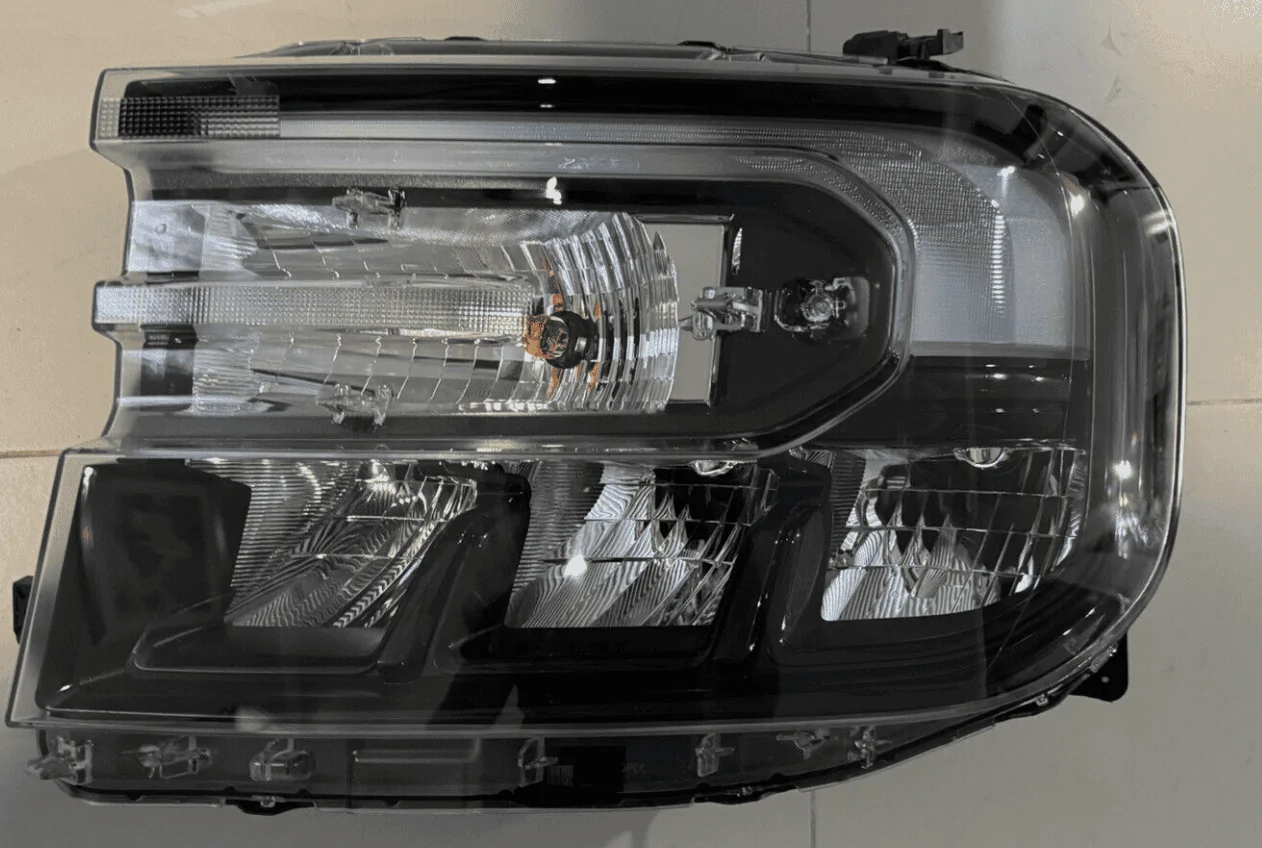

For reference, here is a tremor headlight
Ford Maverick Tremor or Lariat headlights - direct plug-and-play to XLT? Screenshot 2024-01-08 at 7.31.12 AM

As long as the physical plug is the same it should work. The only thing that might not work would be the upper led bar since I’m not sure if your truck would be wired for it but that’s an easy fix. No vin coding needed but I suggest checking out forscan if you are planing future mods to the truck.

You would need FORScan to probably do a Local Interface Network (LIN) Module Initialization as there's a computer module in the headlight that the BCM needs to learn to talk to. Also need to reconfigure other settings such as using the accent lighting for DRL instead of the turn signal low filament.

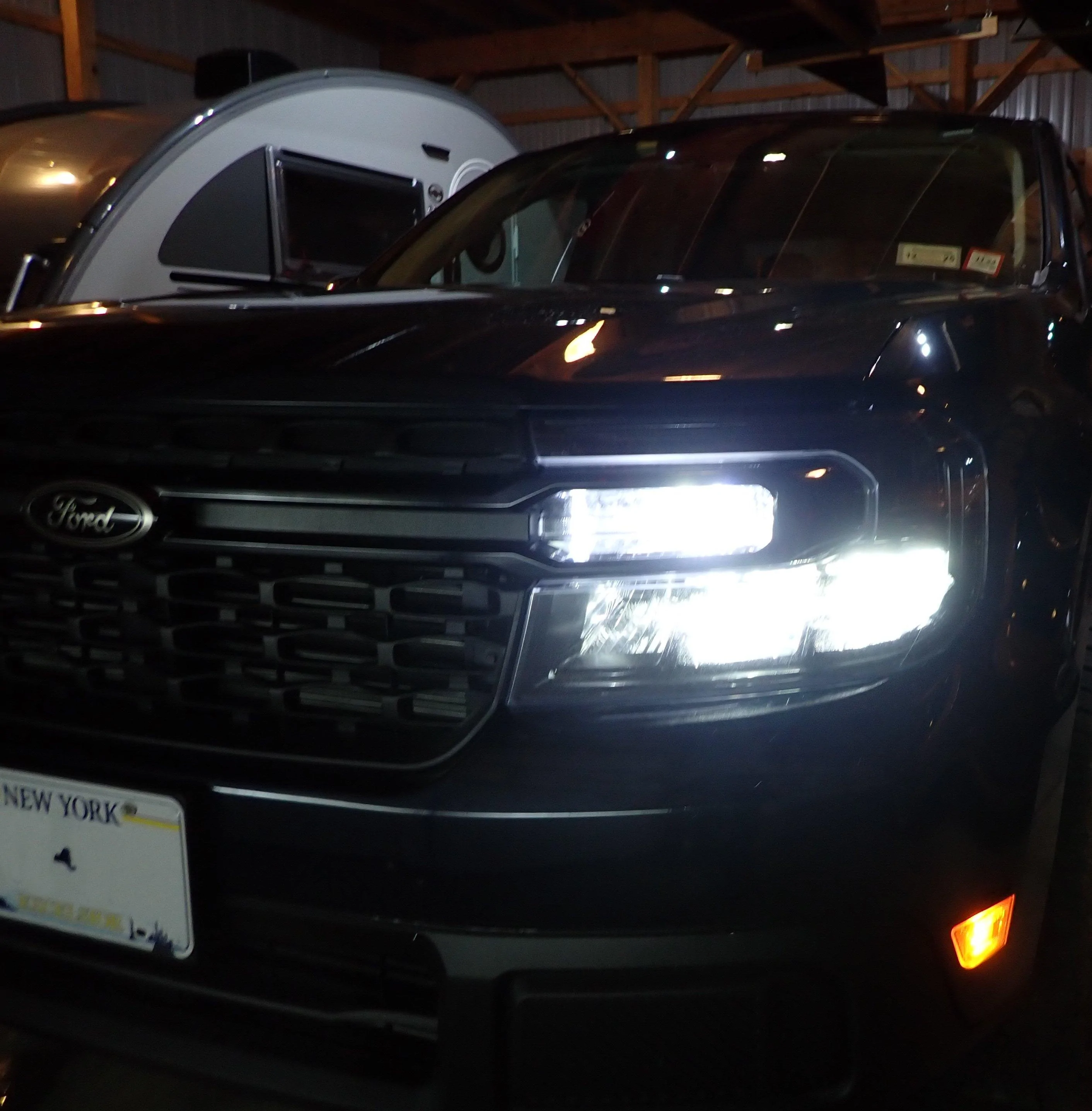

I actually like the XLT BAP lights better on mine with the front turns switched to LED white.
The more light up front the better.
