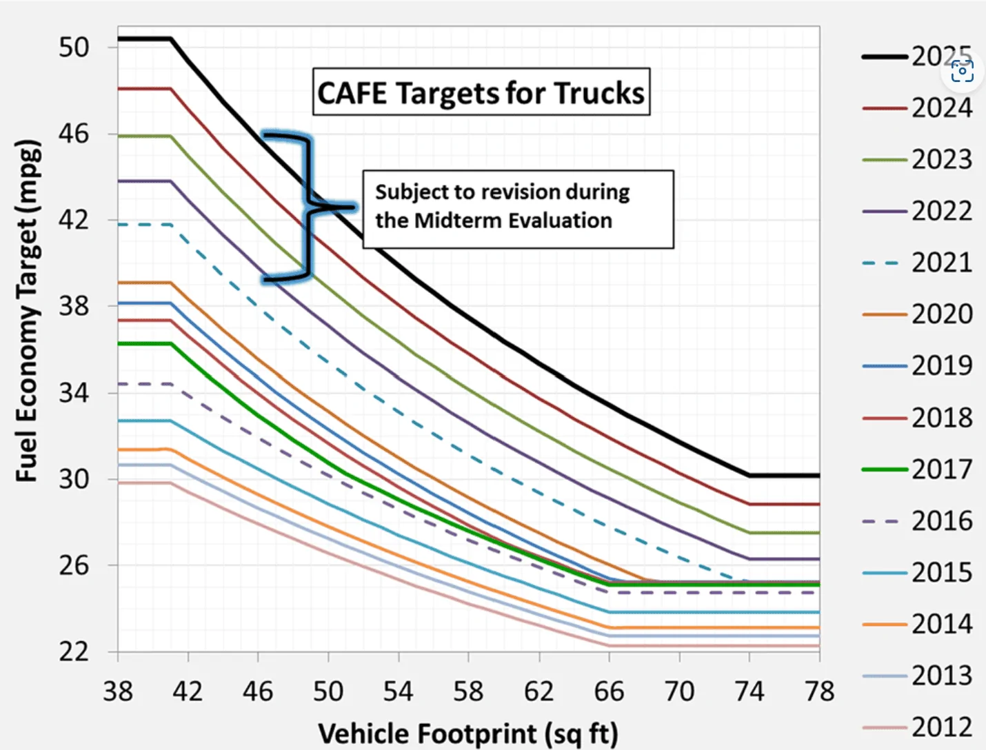

I wonder if this is a CAFE (Corporate Average Fuel Efficiency) issue? The required minimum MPG go up by about 1-2 MPG per year. All the small vans get around 25 MPG and have a footprint probably around 48-52 square feet (the Maverick is just shy of 53 square feet by my math). The MPG in the graph below is different than the EPA window sticker MPG (since the way it gets calculated changed a few times since CAFE came out) but all the vans are still way off. This means an additional $1k-$2k in tax per vehicle and that number goes up by about $500 per year. Since this tax is at the manufacturer's level, the end-buyer cost is probably twice that. That quickly makes these small vans not economically feasible to make. Much easier for the manufacturer to just increase the vehicle footprint (i.e., bigger van/truck/suv).
Interesting graph, except our Mavericks, trucks are not even up to 2012 levels yet!
The way I read that, the 2022 target for the Maverick (@ 53 sq ft, average track times wheelbase) would be around 36 mpg. The hybrid exceeds that, at 37 combined.
Gee - I suddenly feel so virtuous! :ROFLMAO:
I should have phrased that, "with the exceptions of our Mavericks"
