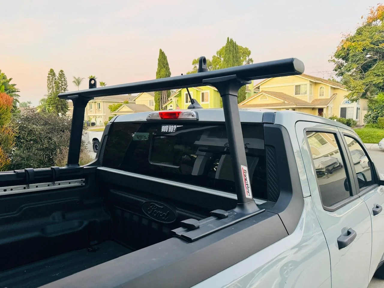

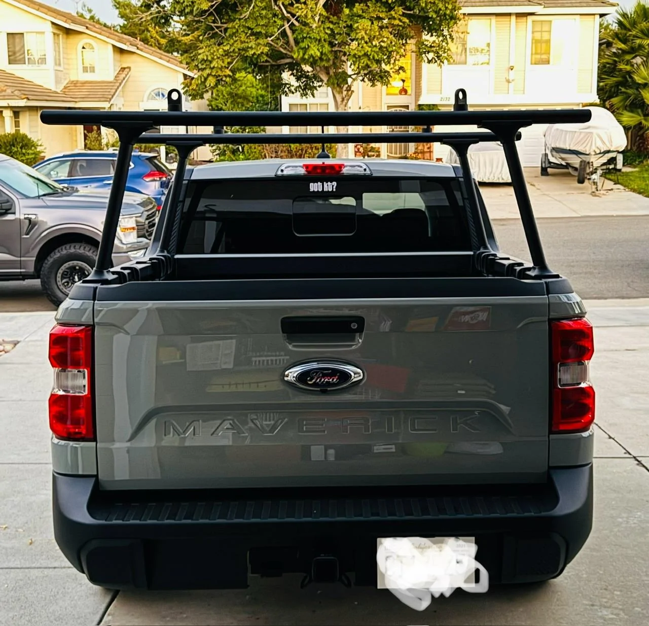

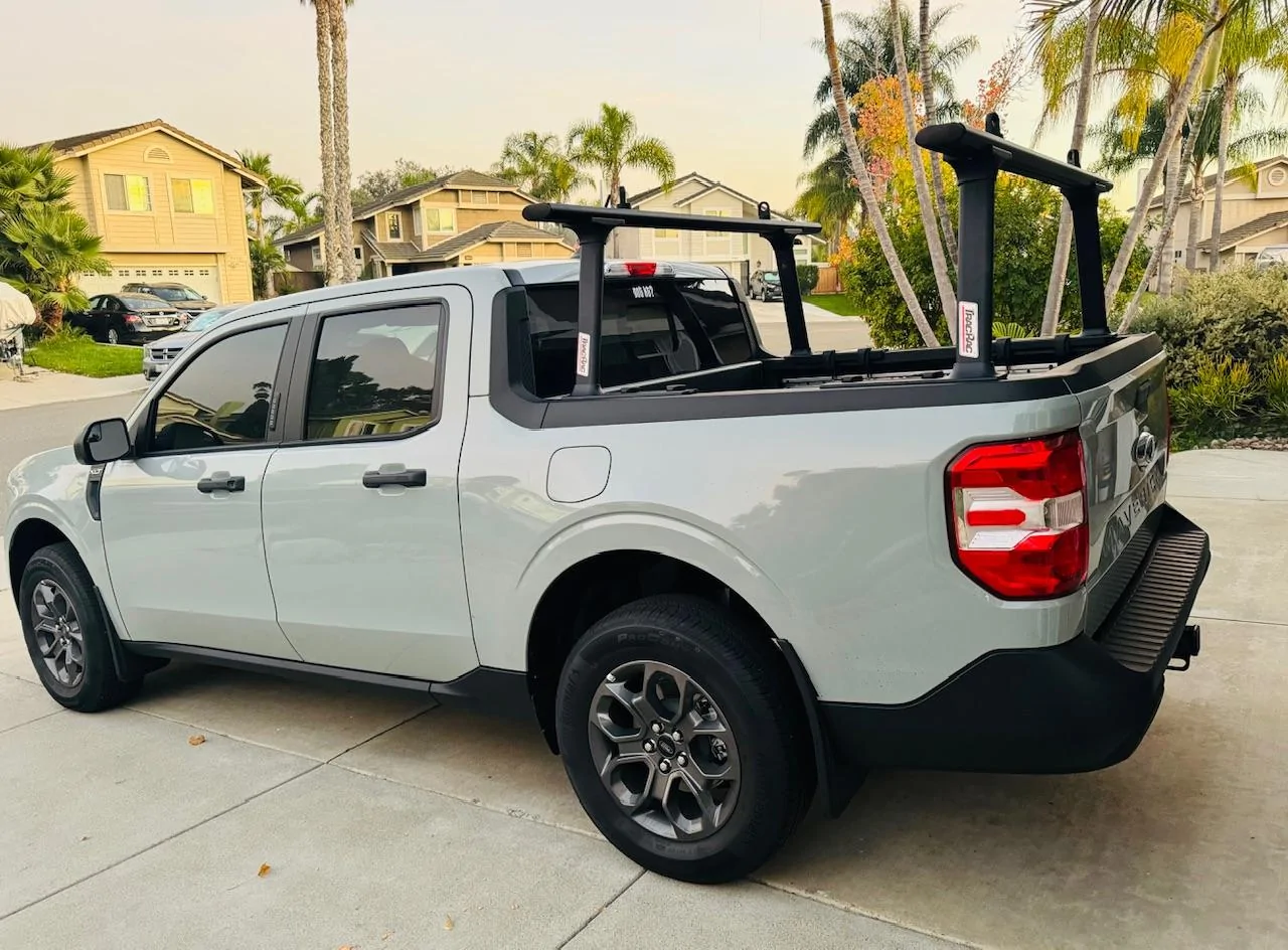

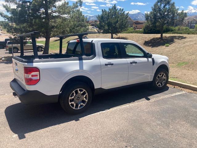

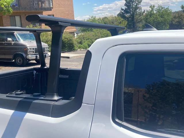

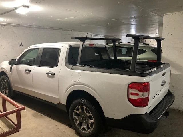

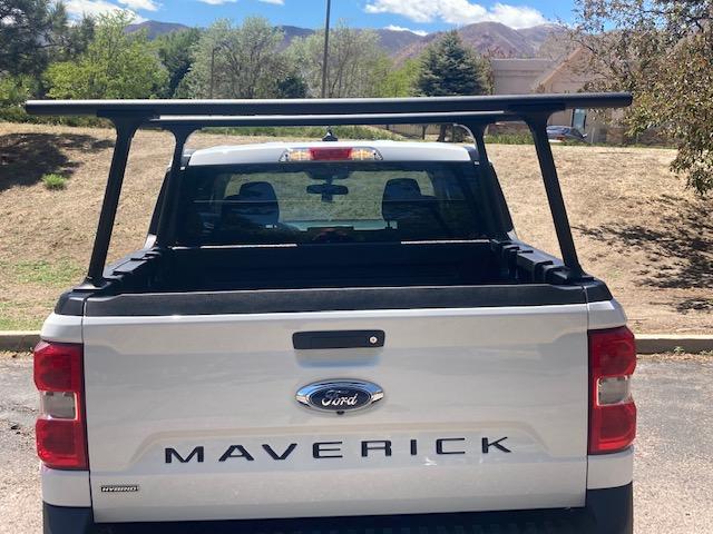

So here's a few pics of my install of the Home Depot Trac One Ladder rack ($407 with tx), essentially the same as the the Thule Trac one just not paying extra for the name. Think it came out pretty good a few alterations needed to be made as follows

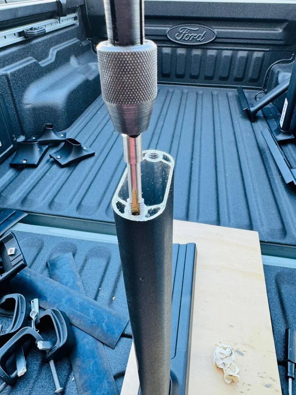

- Vertical legs/posts needed to be cut down to 18" to get the look shown, the standard set is about 6"s longer and just way to high in my opinion to sit on maverick. you will need a 3/8"-16NC to tap posts after you make cut. Remember to use some oil when tapping and it will tap no problem, you'll have to go full length of standard thread tap and it will work fine think its about 1 1/2". Oh yeah, make sure your tap and cut are used at top mounts if you use them at bottom you'll have to tap deeper.

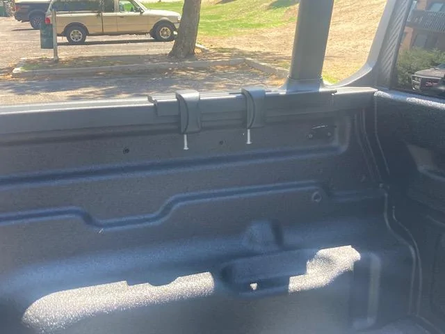

- Second tip use same tap to clear out threads on bed clamps, this will make your life a whole lot easier and just remember some thread lock which does not come with clamps. Not a fan of the allen head bolts, but i suppose makes it harder for someone as to not take a rachet to it.

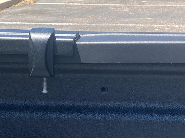

-Finally make sure vertical post pads sit inside the decorative seam on rails not on top, if not you'll get a plastic deformity on rail like the last pic, i moved pad in some and it kinda went away. there seems to be a small gab from metal bed to plastic rails so when you clamp down it bends, oh well not terrible.
- Also i took off, antenna radio works well without it, i drove truck round without it for 2 month before i realized dealer left it in glove box.

Oooh that i couldn't tell you, i would think cover would sit on top of bed rails from the ones i seen and this system would interfere i believe, but i could be wrong.
