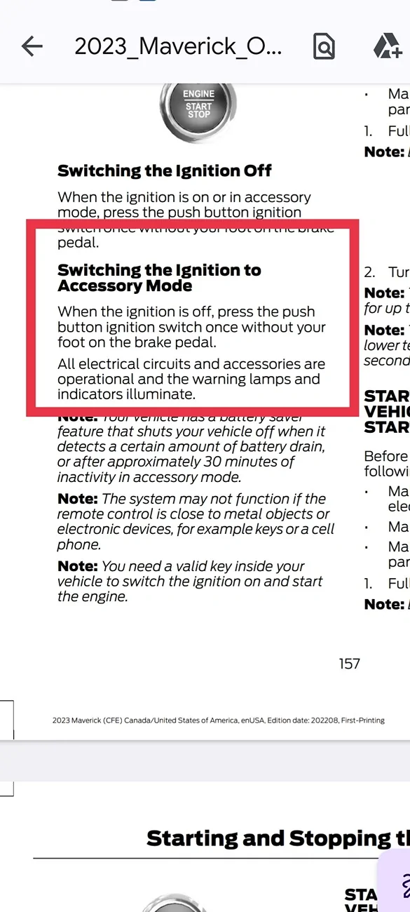

Hate to drag this one out again, but how do you follow the TPMS reset sequence if you don't have a key ignition? Turning the button to run is not possible: it is either ON or OFF.
The truck is a 2024 Lariat hybrid. Tried it for about 30 minutes today and managed to lock the shifter up for a while (which was a whole other problem).
The wheels and sensors are alloy OEM Lariat wheels, ford sensors.
Many thanks.

Ian,
Try pressing the start button without your foot on the brake.
Ford Maverick TPMS Relearn / Reset? IMG_20251106_152337

OK. Did not have my foot on the brake. You press the brake once. Then you start the sequence of turning it on and turning it off. The you press the brake once and the truck should enter learn mode.
I will try again, but it really didn't work. The truck never went into the learn mode.
I've done the sequence before successfully with this truck. WIsh there was something more straightforward for resetting. I did three vehicles today. The only unsuccessful relearn was with the Maverick (Buick Encore and Toyota Prius were the other two vehicles)
The frustrating part is that when you ask the net for help, AI produces garbage that does not apply to a push start Ford Maverick. Some of the worst answers are boiler plate on dealer websites.
