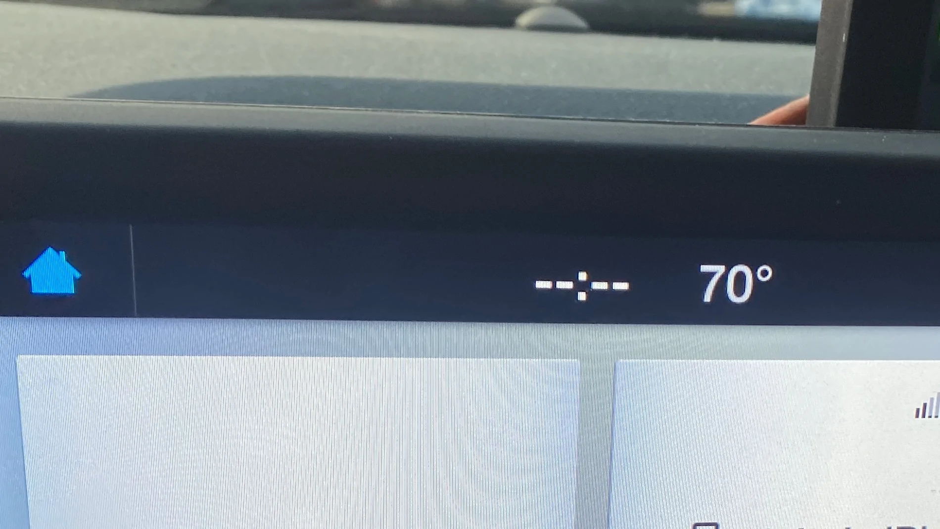

Although in mine, it suddenly decided I don't need a clock anymore.
For the past 3-4 days.
It decided time isn't important anymore in sunny California...
[/QU
Not to worry, Ford has you covered. Just drive true North, stop the truck and look at which way the shadow from your antenna is pointing. It's a built in sundial.
