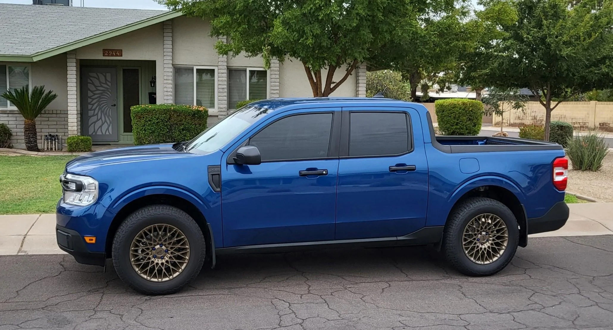

I see posts about keeping front and back tires same size or it will effect my AWD will the same thing happen if I go with larger tires and wheels looking at 20 inch. And does anyone know if 20 inch will fit on my truck with out rubbing anywhere
If you have AWD, you must go the same size on all 4 corners. Here is a photo of my 23 AWD with 265/60/18 on stock suspension and no rubbing.
