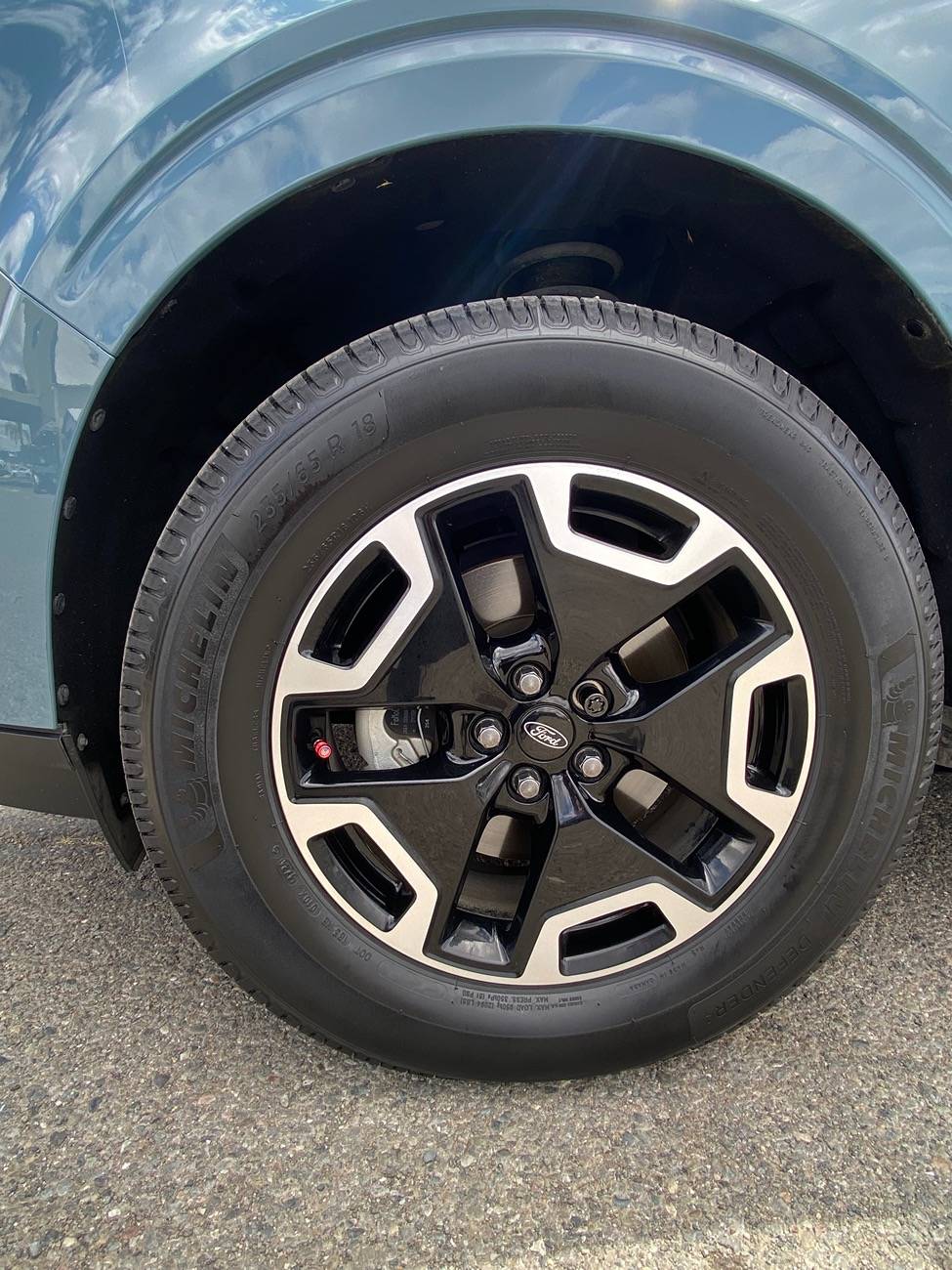

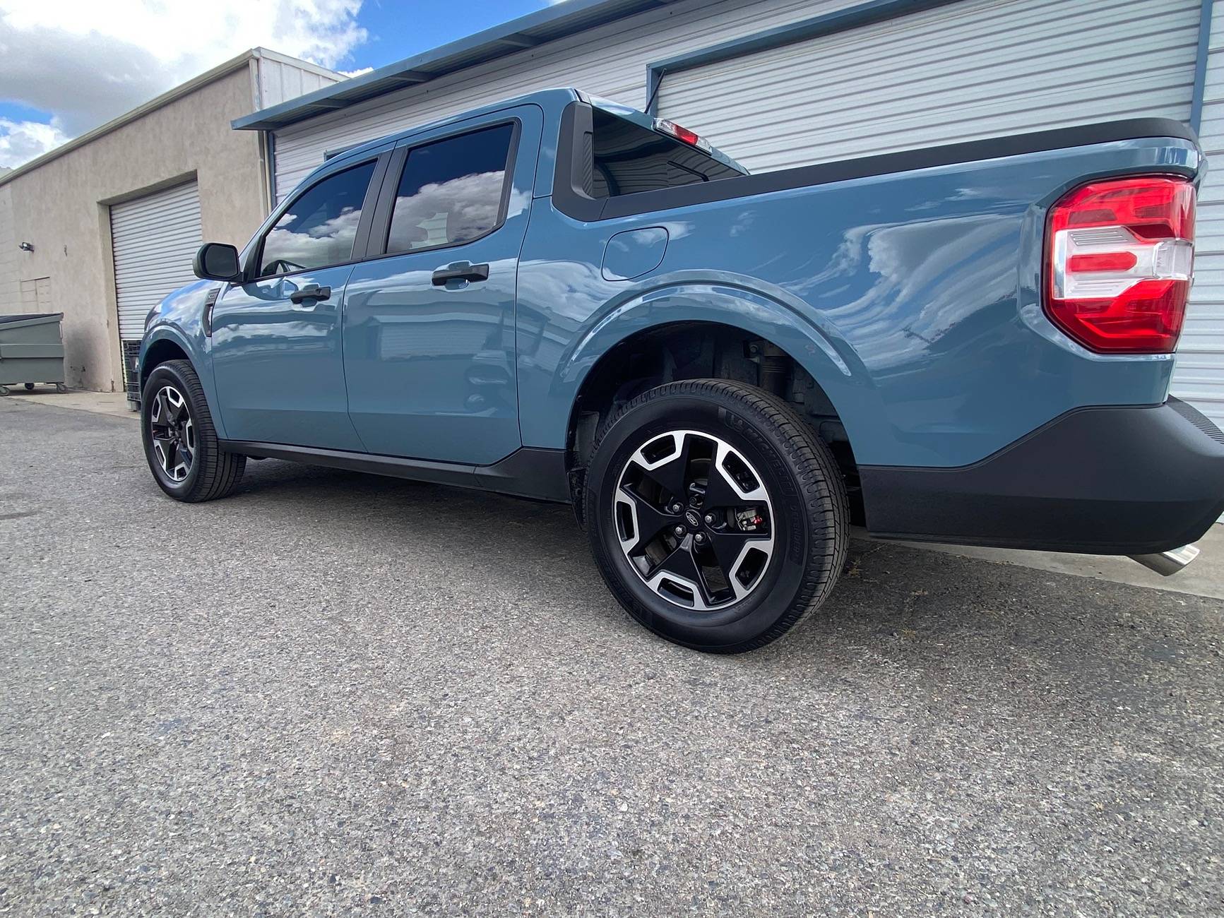

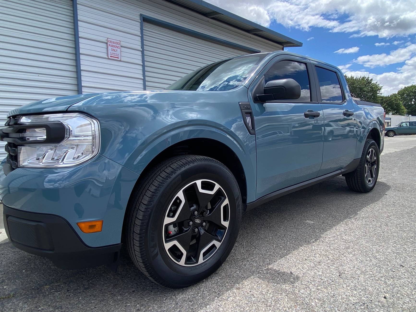

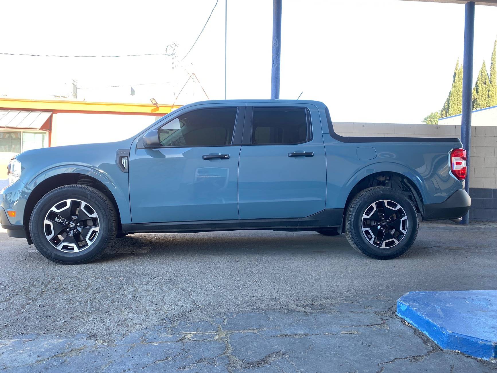

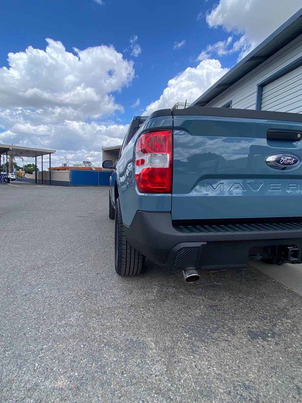

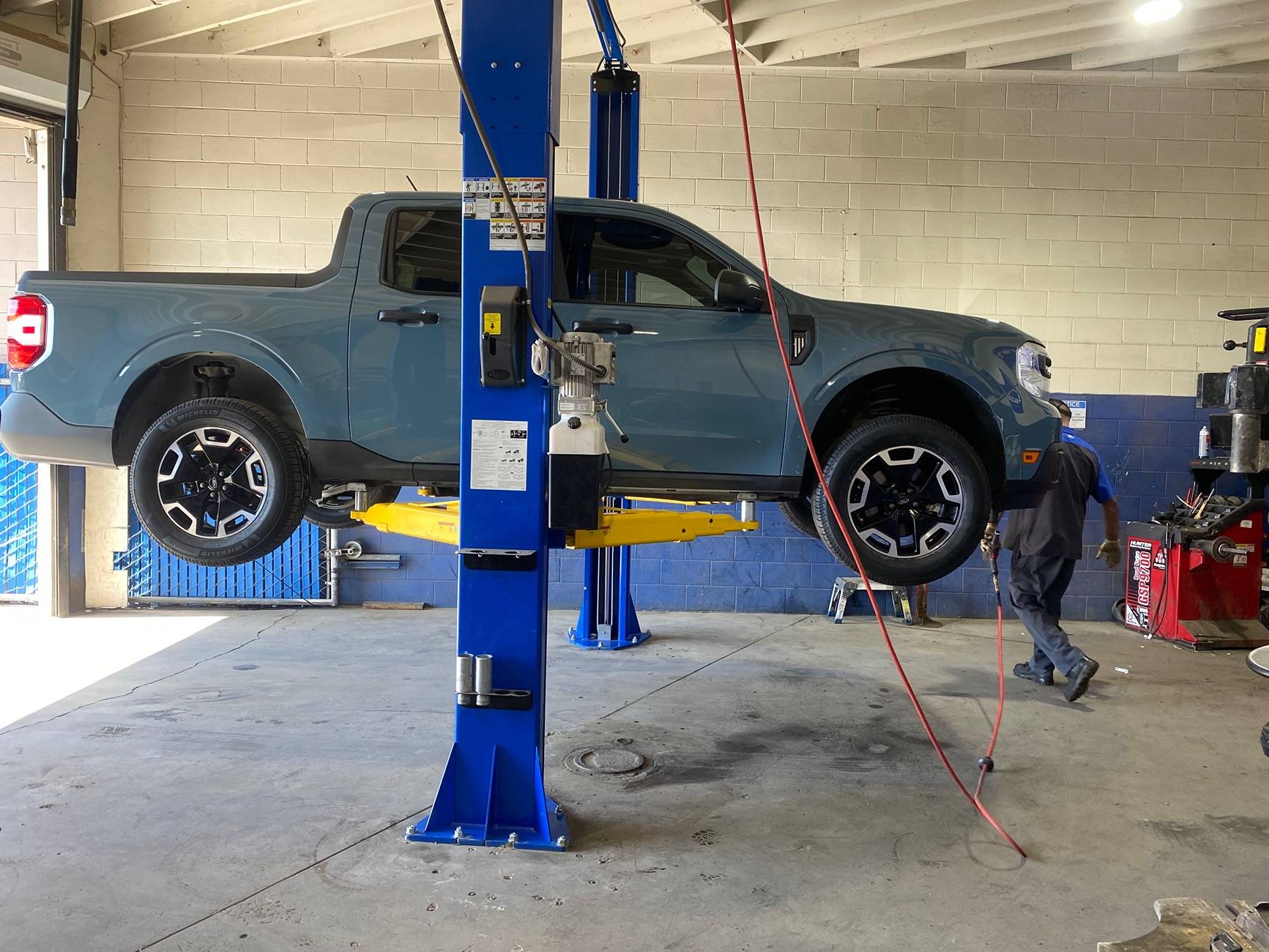

255/65r17 (30.1” diameter) does not rub with stock suspension when traversing washes off-road, or backing up at full lock on a hillside. I tried a bunch of things and got zero rubbing.
265/65R17 (30.6” diameter) is reported by some to have mild rubbing, where others deny that any rubbing happens.
245/70R17 (30.8” diameter) is reported to have mild rubbing. I haven’t seen anyone that says 30.8” won’t rub. This is the diameter where people start removing their fender liners or heating the plastic to reshape it, and they start doing some grinding on the pinch welds or install a lift kit.
If you want the largest tire possible, I’m guessing you mean for off-roading? If yes, you should stick with 17” wheels for more tire sidewall, which improves traction and decreases damage to your wheels.
There’s a few comments in this thread that recommend 245/65r17, which is 29.5”. If you want to go big without rubbing, 29.5 is not the max. There’s 3 or 4 sizes larger than that, which will not rub. But it depends on your use case. If you’re going to be hauling firewood in the winter with suspension sagging from the payload and tires heavily caked in mud, then yeah, go smaller because the mud will rub and tear up your fender liners.
Heres the summary:
235/75R17 = 30.9” diameter = rub + mods.
245/70r17= 30.8” = rub.
265/65r17 = 30.6” = borderline rub.
225/75r17 = 30.2” = no rub.
255/65r17 = 30.1” = no rub.
235/70r17 = 30.0” = no rub.
245/65r17 = 29.5” = no rub.
225/65r17 = 28.5” =stock size.
