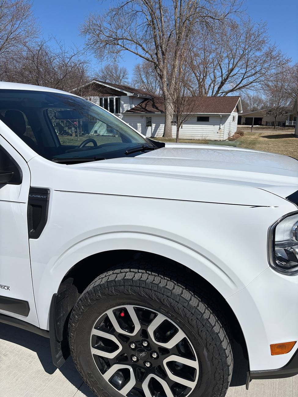

I run 255 width wildpeak AT4W’s, which have very square shoulders and large sidewall lugs and they don’t rub anywhere, under any conditions. I chose 255 because no one, literally no one, says they get any rubbing.
And there are forum members that run 265 width Wildpeaks that swear up and down that they get no rubbing either.
However, if you run a 235/75r17, the same width as the stock tremor tires, but 2” larger diameter, you will 100% for sure get rubbing.
And when it comes to wheel size, it is common in the off-road community to use a wheel that is 1/2” narrower than the tire companies recommend because 1) the wide tire bashes into rocks before the narrow wheel does and 2) wide tires on skinny wheels can tolerate lower air pressure before losing the bead.
The recommended width range for a 265/65r17 is 7.5-9.5”. If you spend all of your miles on the freeway, then yes, that is a good plan. But, if you want to air down and go off-roading, the stock, 7” wide wheel is perfect for a 265 tire.
Here’s the opposite, where you put a skinny tire on a wide wheel. You need to run max pressure to make sure the bead stays seated. You lower the pressure to something like 30 psi and when you hit big bumps, it’s going to belch air out of the bead. And it will keep doing that more as the pressure drops lower and lower, until pffffft and it’s flat.

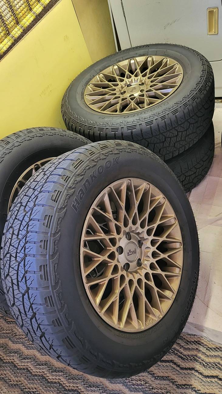

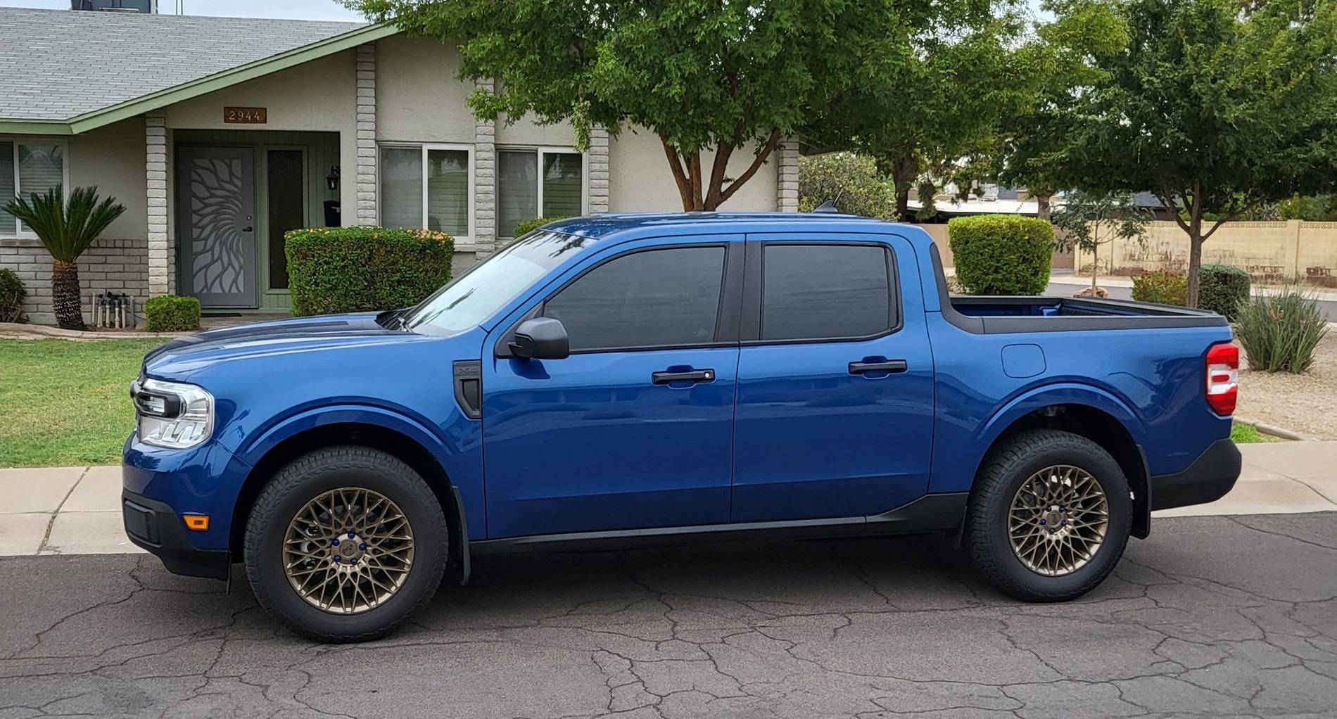

My XL is on Bronco sport 18” wheels - I just put Michelin defender 2s tires
235/65/18 no rub issues , previously had 225/60/18 - the little increase in tire height greatly improved the ride quality (noticeably !) and I love the way the truck looks a bit tougher - filled the wheel wells in nice also - but the ride ! Such improvement !
