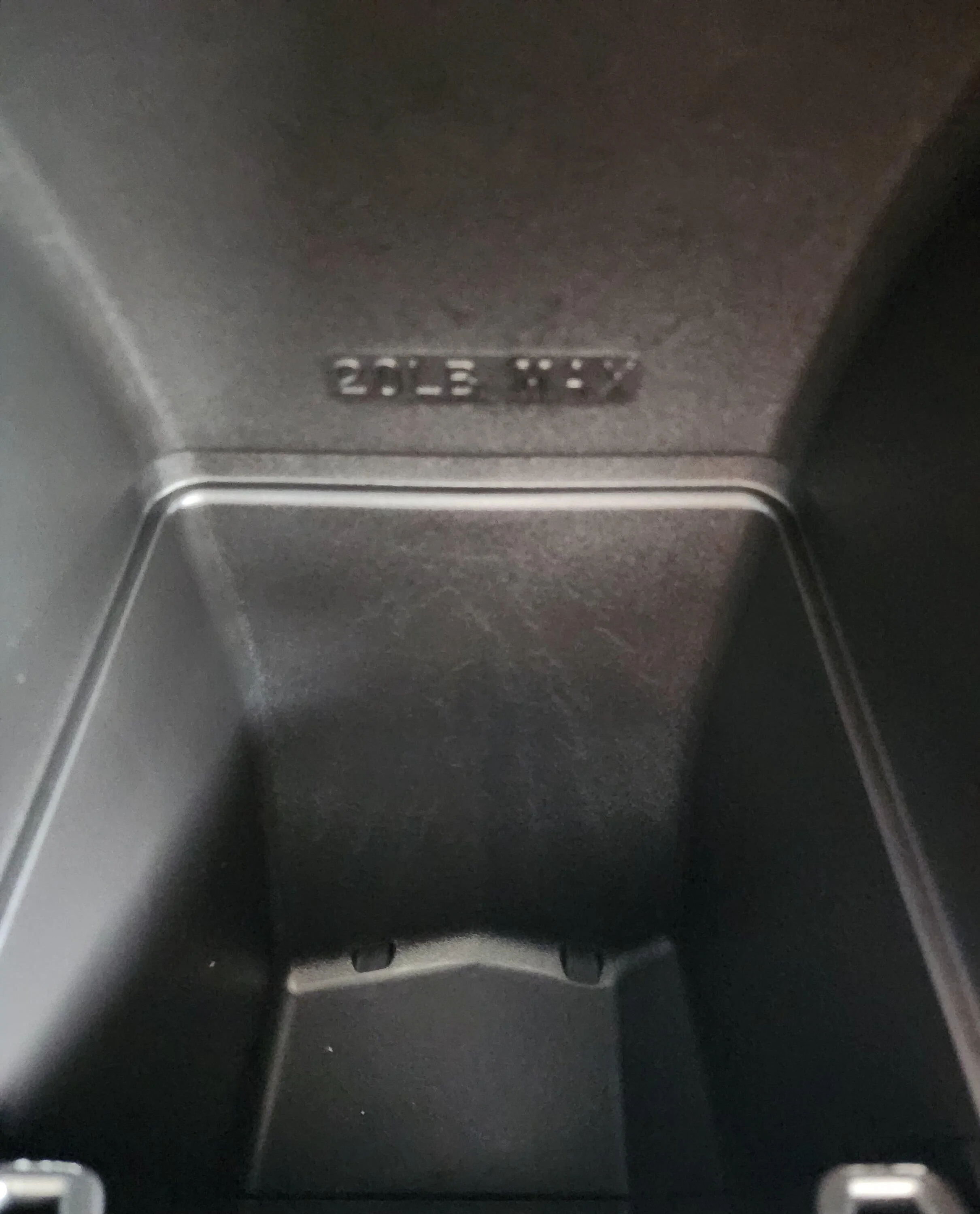

Installed bed cubbies for passenger and driver side. Bought them off the web from FairwayFordParts. Cool storage addition for soft stuff (tarp, para cord, zip ties, jumper cables, ratchet straps, chem lights/glow sticks, just regular preparedness stuff, etc...).
Part number is the same for both sides:
NZ6Z-60286A72-A
Funny how the cubbies arrive missing screws. Screws you will need are M6-1.00x20, plus washers. You re-use the ones from the covers, but need two more per cubby (4 total additional screws, if installing both cubbies). I need 4 bigger washers, but made it work for now.
And yep, bedliner is missing from the bottom after swapping from the original standard covers, like everyone else I've seen. No problem for me though.

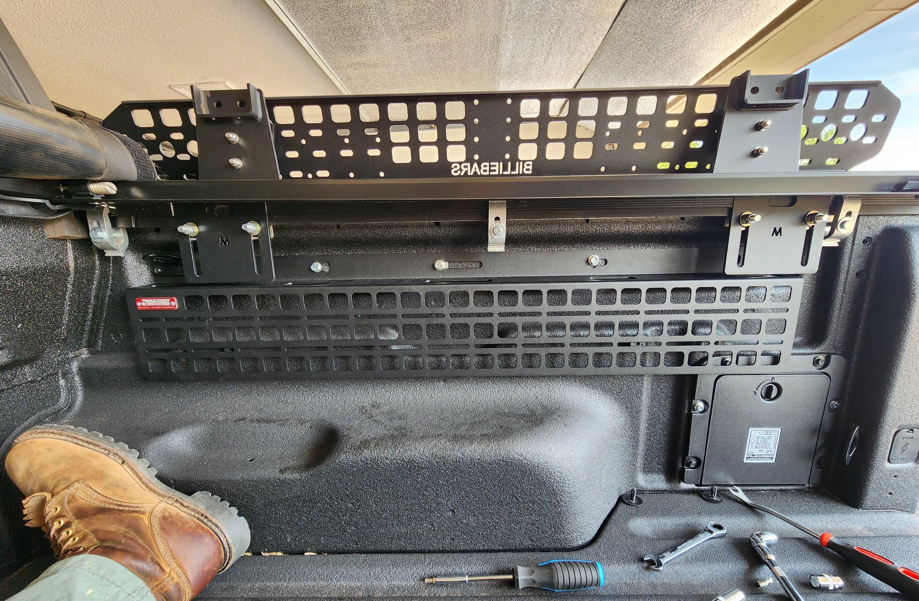

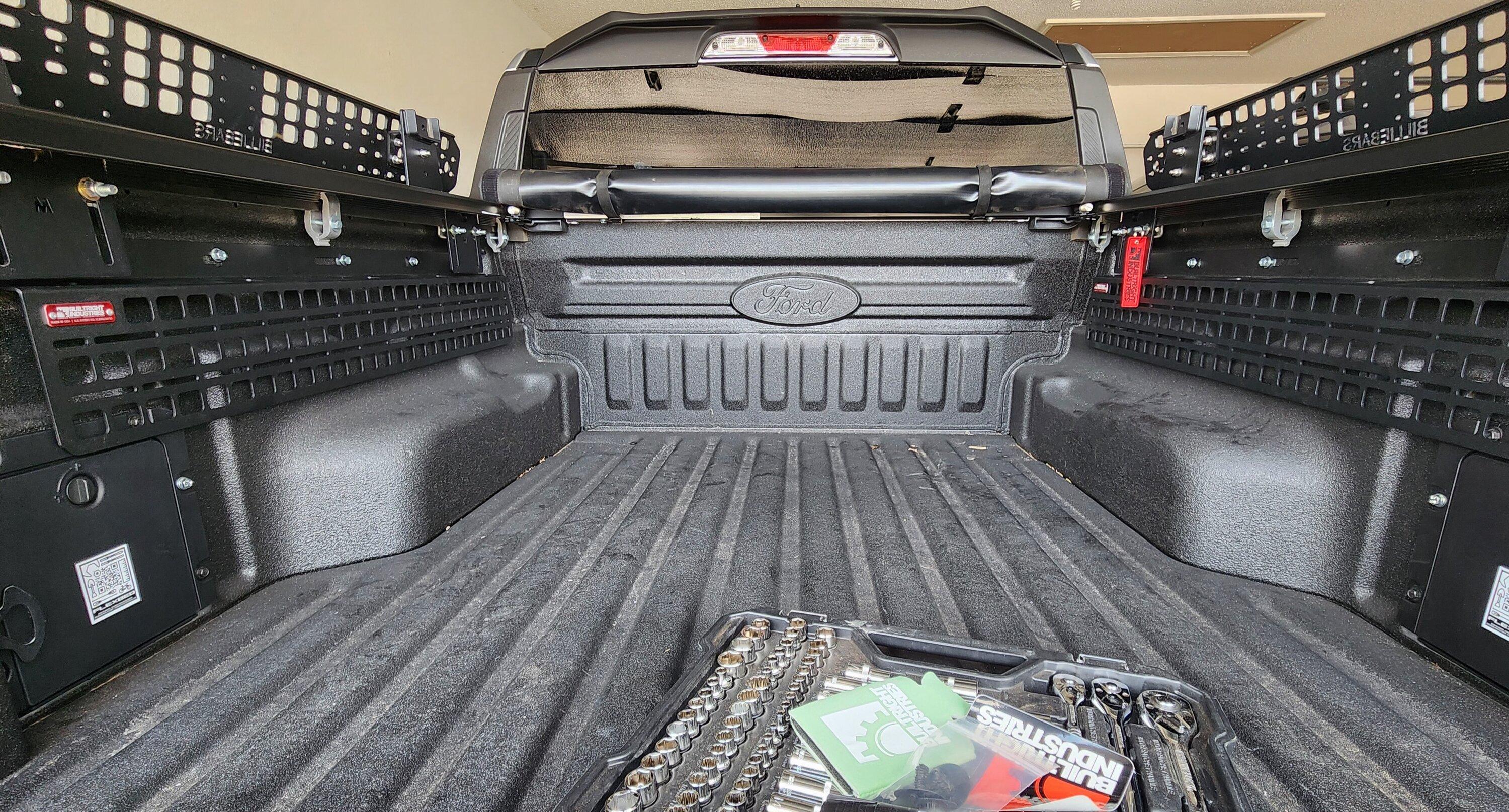

Builtright Industries bed MOLLE panels installed. Compatible with Billie Bars, X15 tonneau (X15 requires modification to be used in conjuction with Billie Bars), and bed cubbies. No interference.
Example for use of the MOLLE panels would be to mount fire extinguisher and a hand tool (shovel, axe, hoe) etc... with Quick Fist MOLLE mounts.

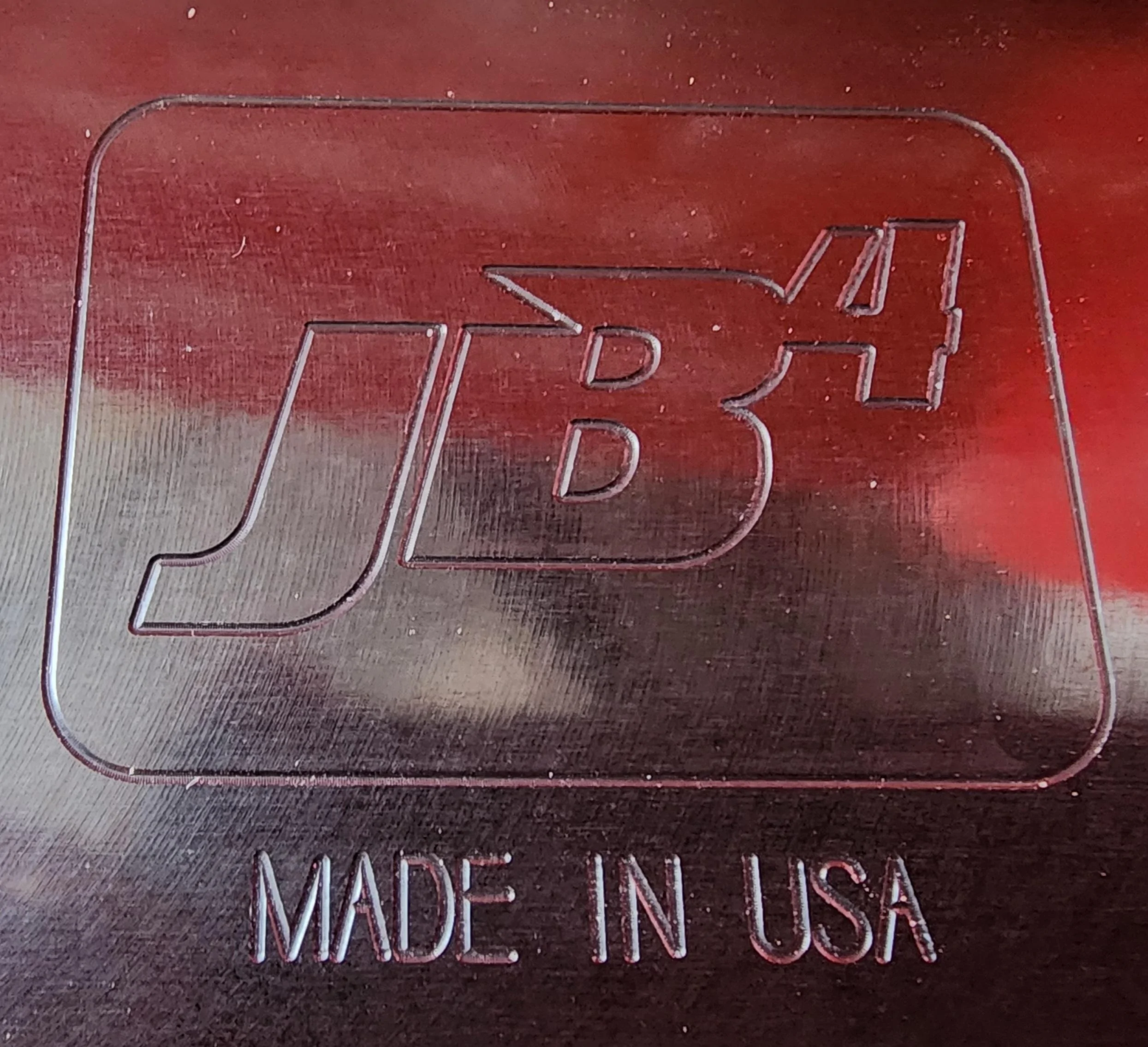

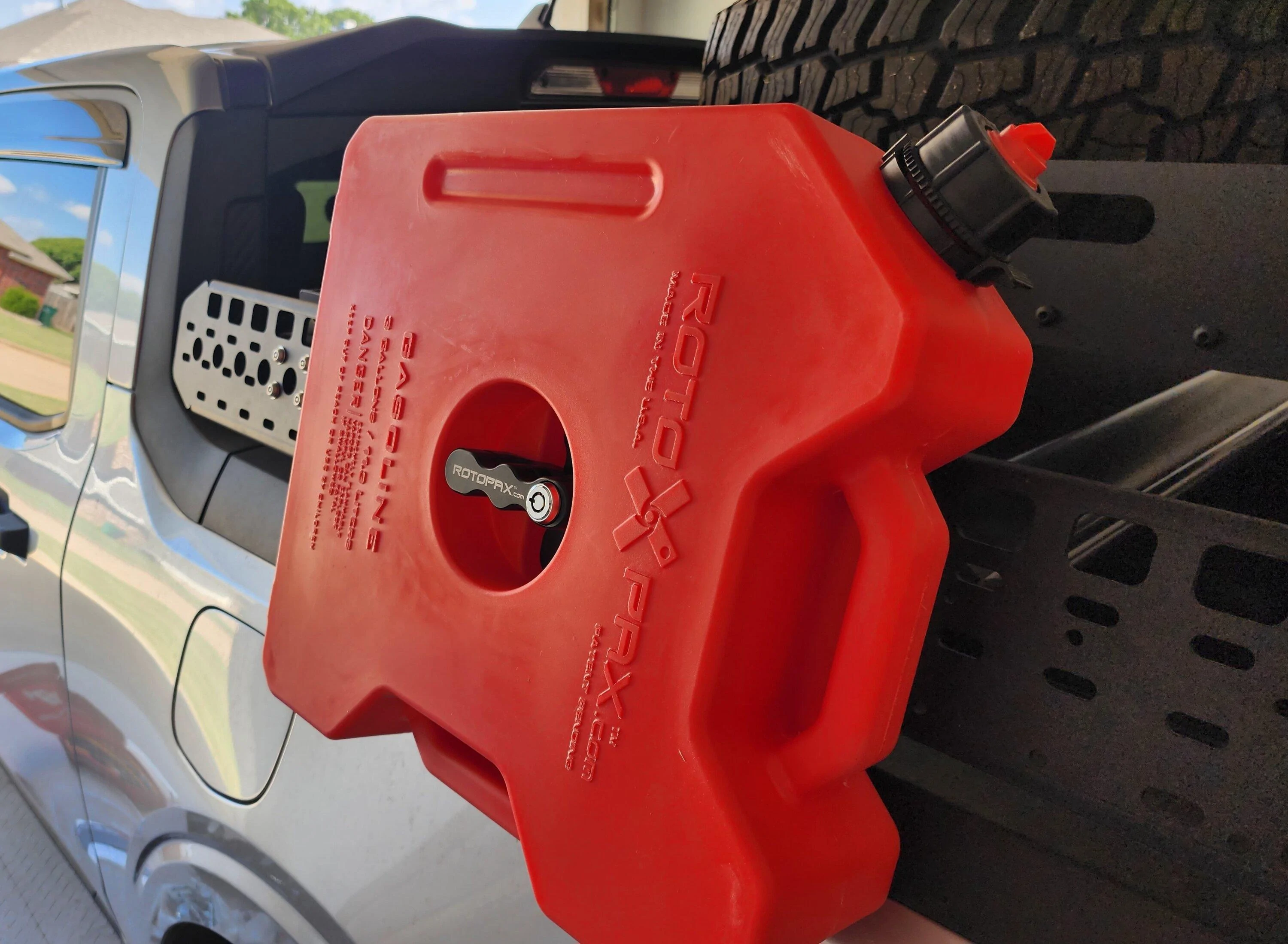

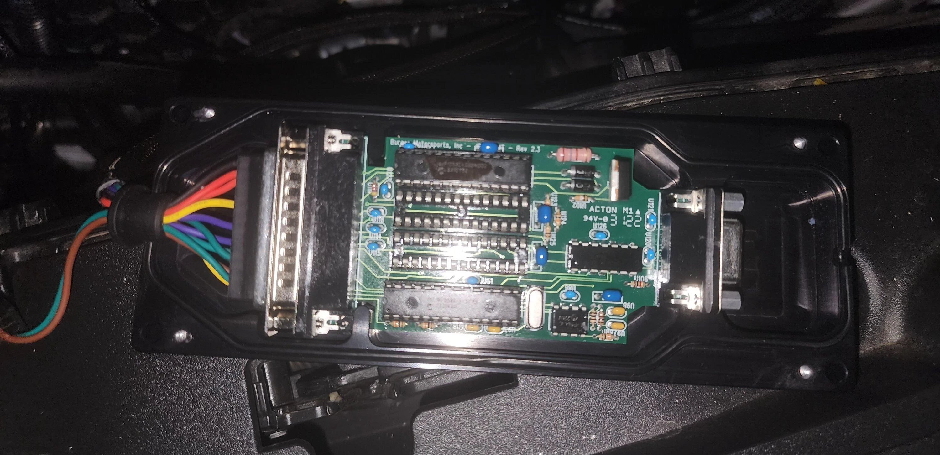

JB4 running normal on 3 different maps. Terry Burger has been super communicative with confirming acceptable operation of the unit. Very responsive to emails.

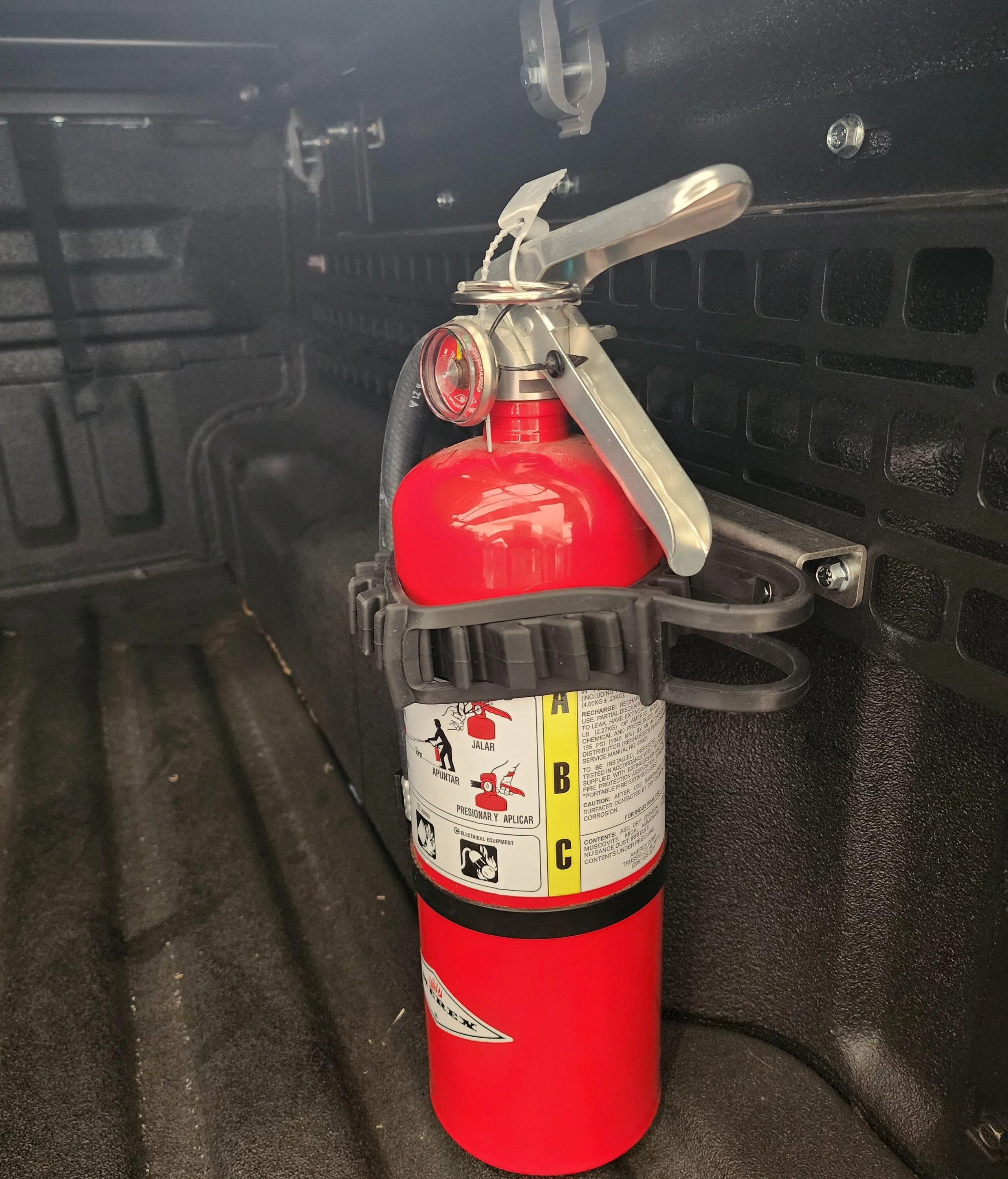

Installed 5 lb fire extinguisher to BuiltRight MOLLE panel in the bed with BuiltRight mount and Quick Fist grabber. Seems rock steady.
Working on securing a full-size spare Baja Boss to a basket over the Billie Bars with a Yakima tire mount.
Need to clean up some wires in the engine bay.
Also mounted a 3 gallon fuel container to the Billie Bars MOLLE panel.
Enjoying the truck and enjoying the club! Truck is coming along...

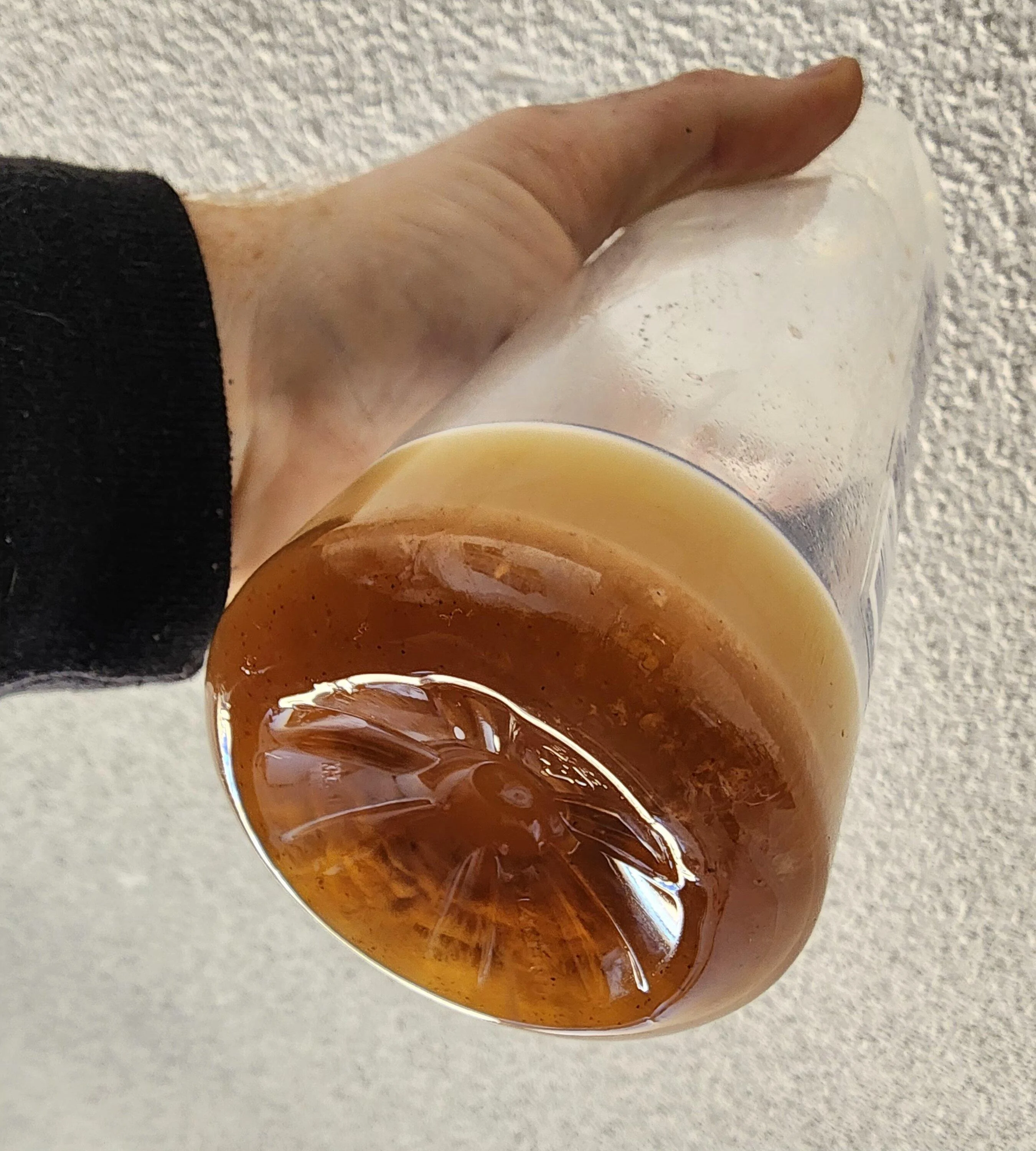

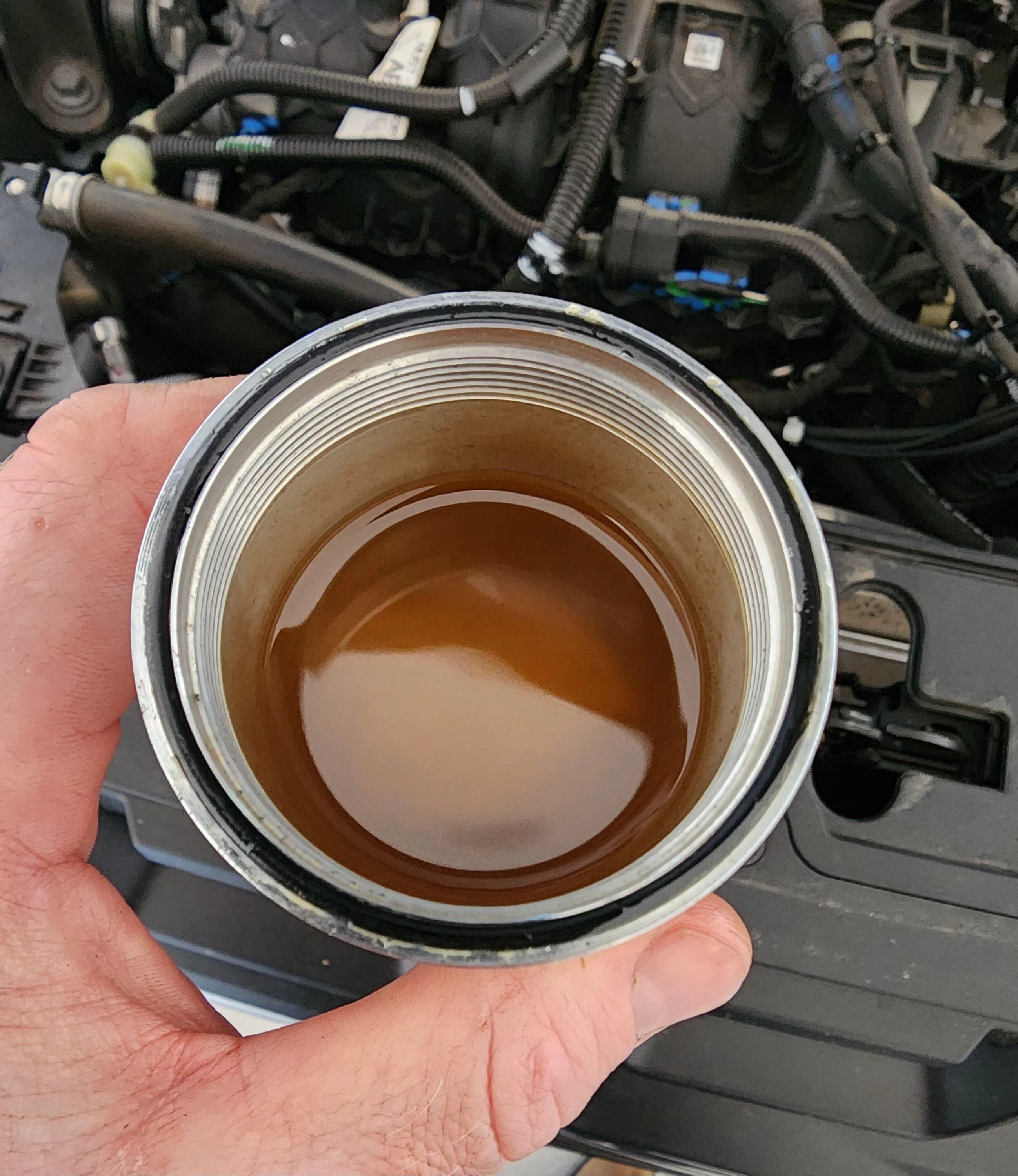

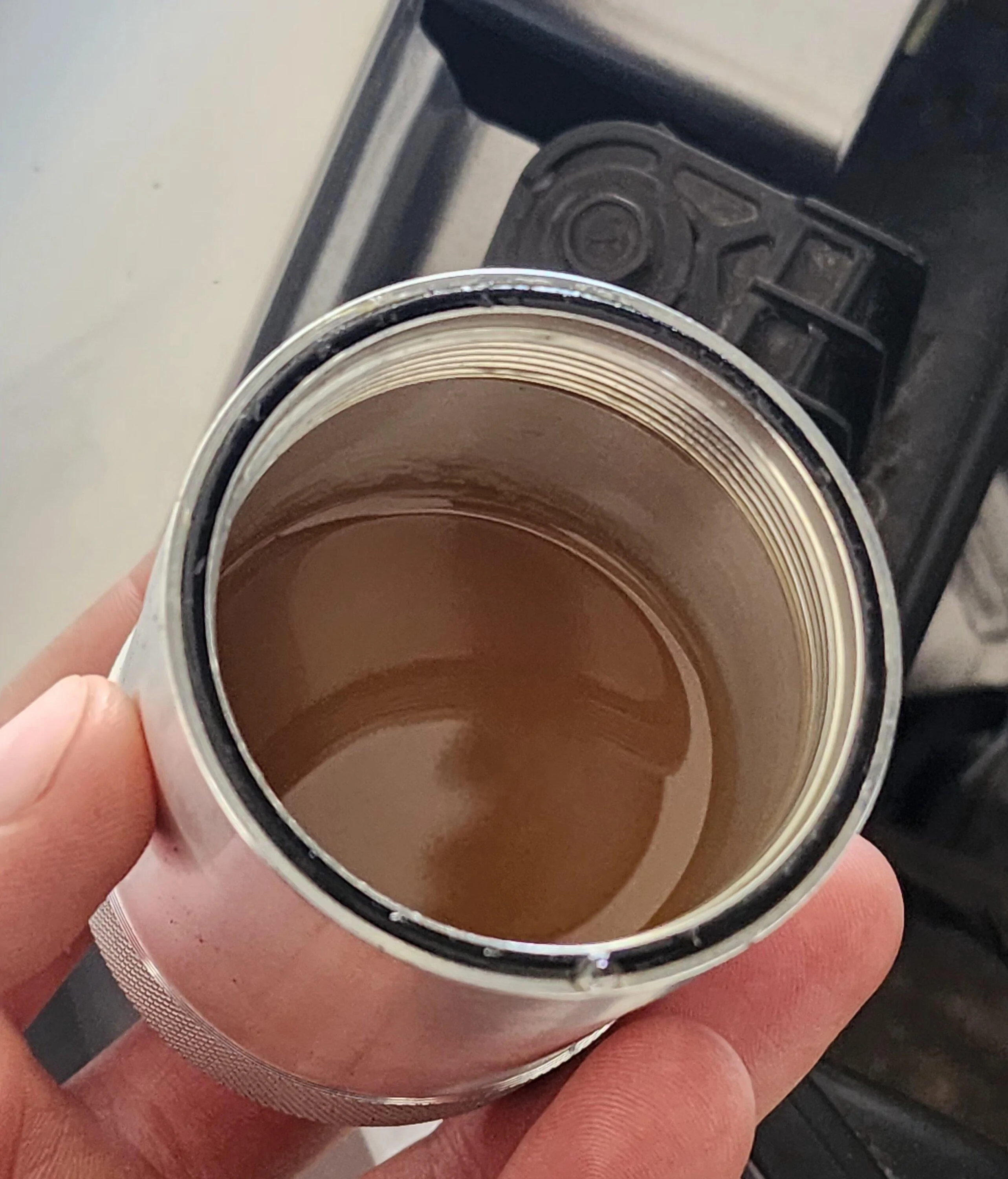

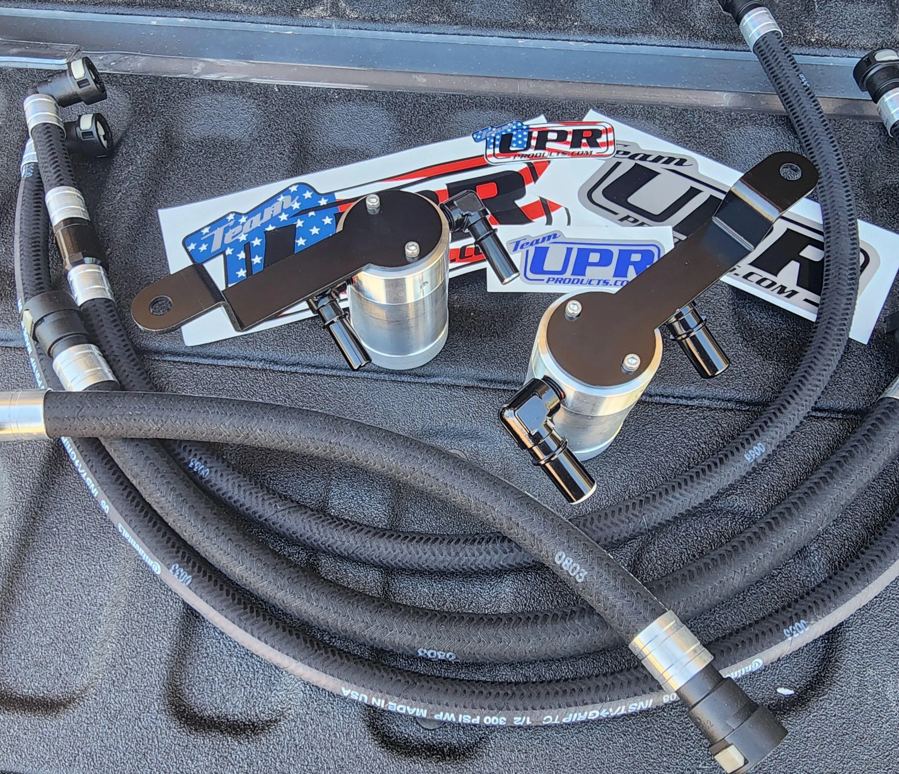

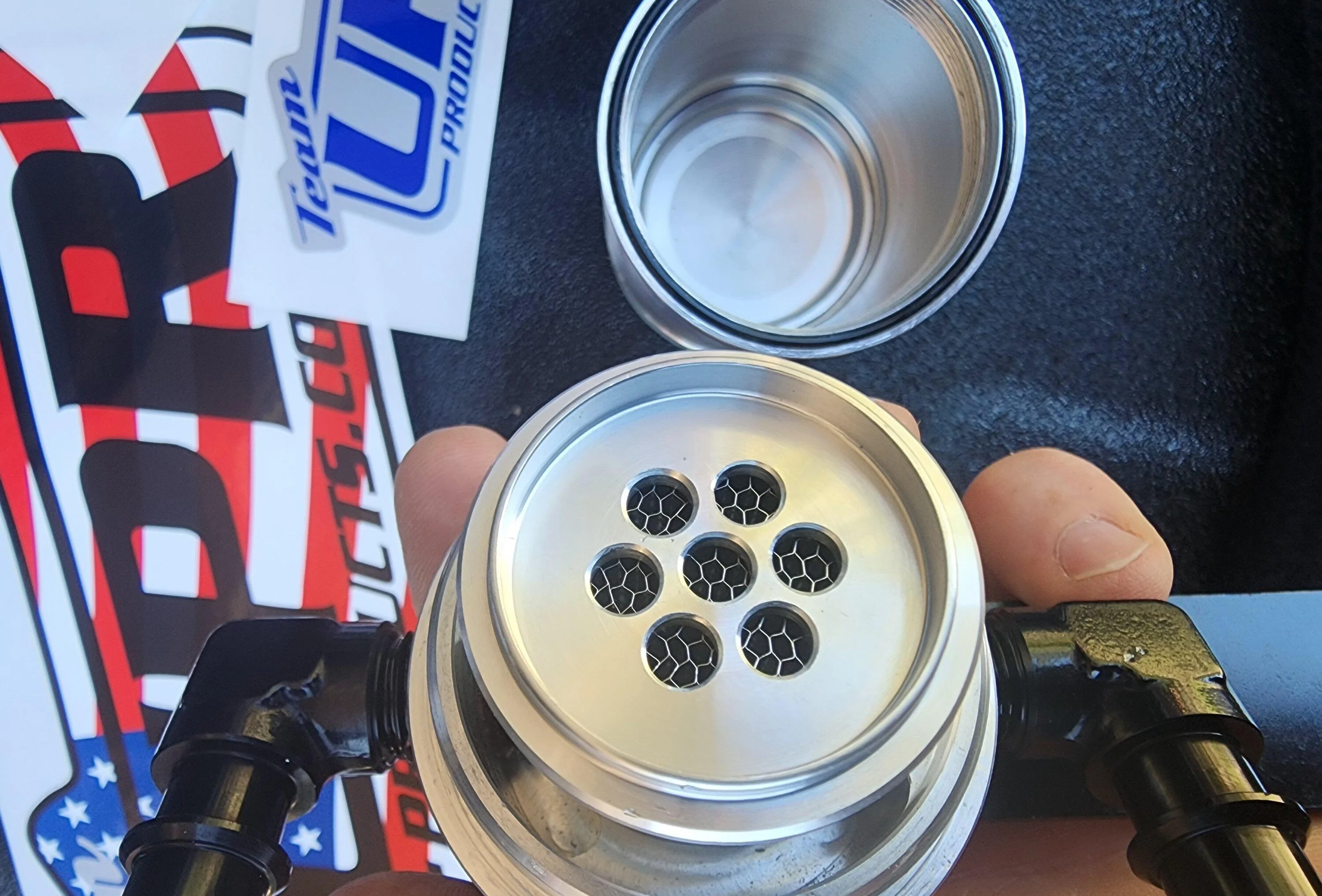

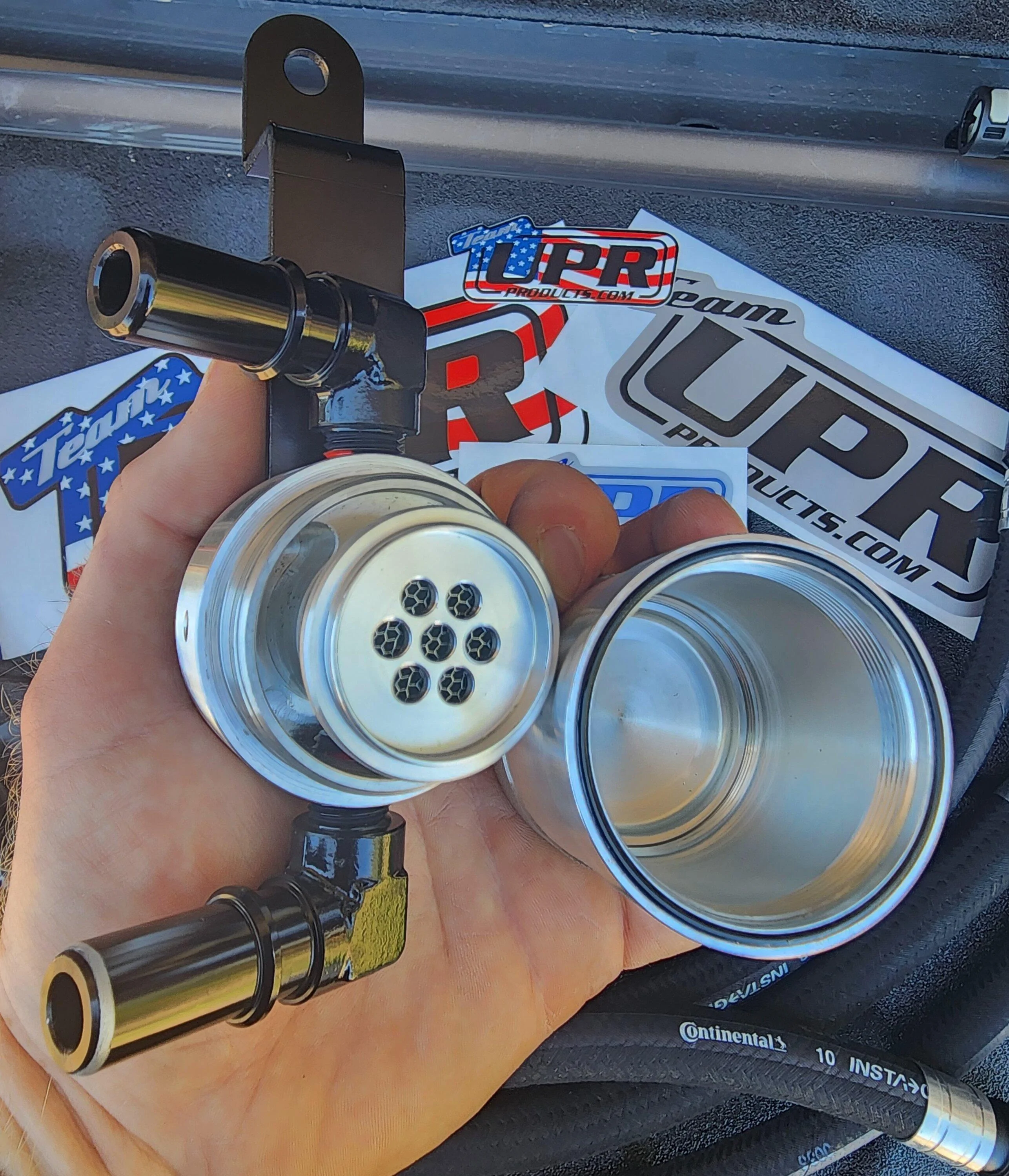

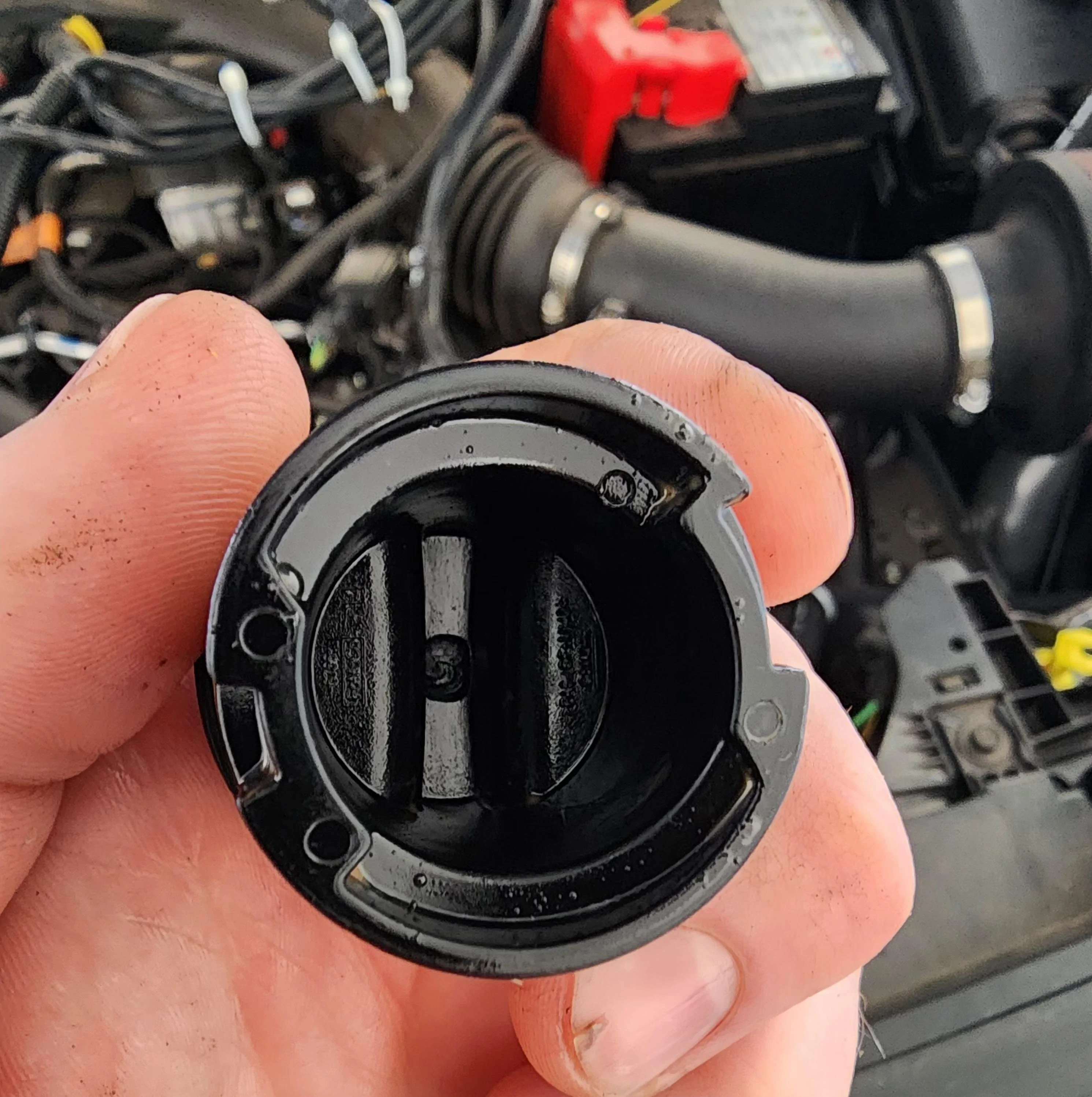

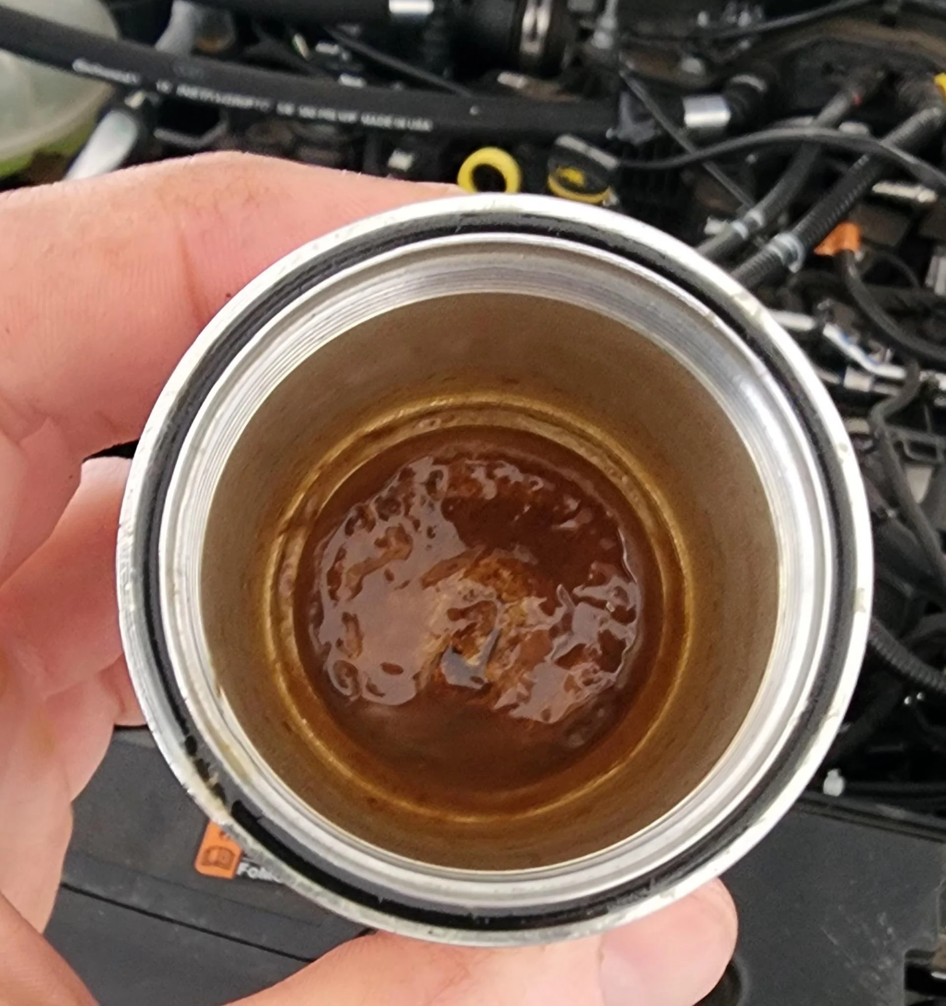

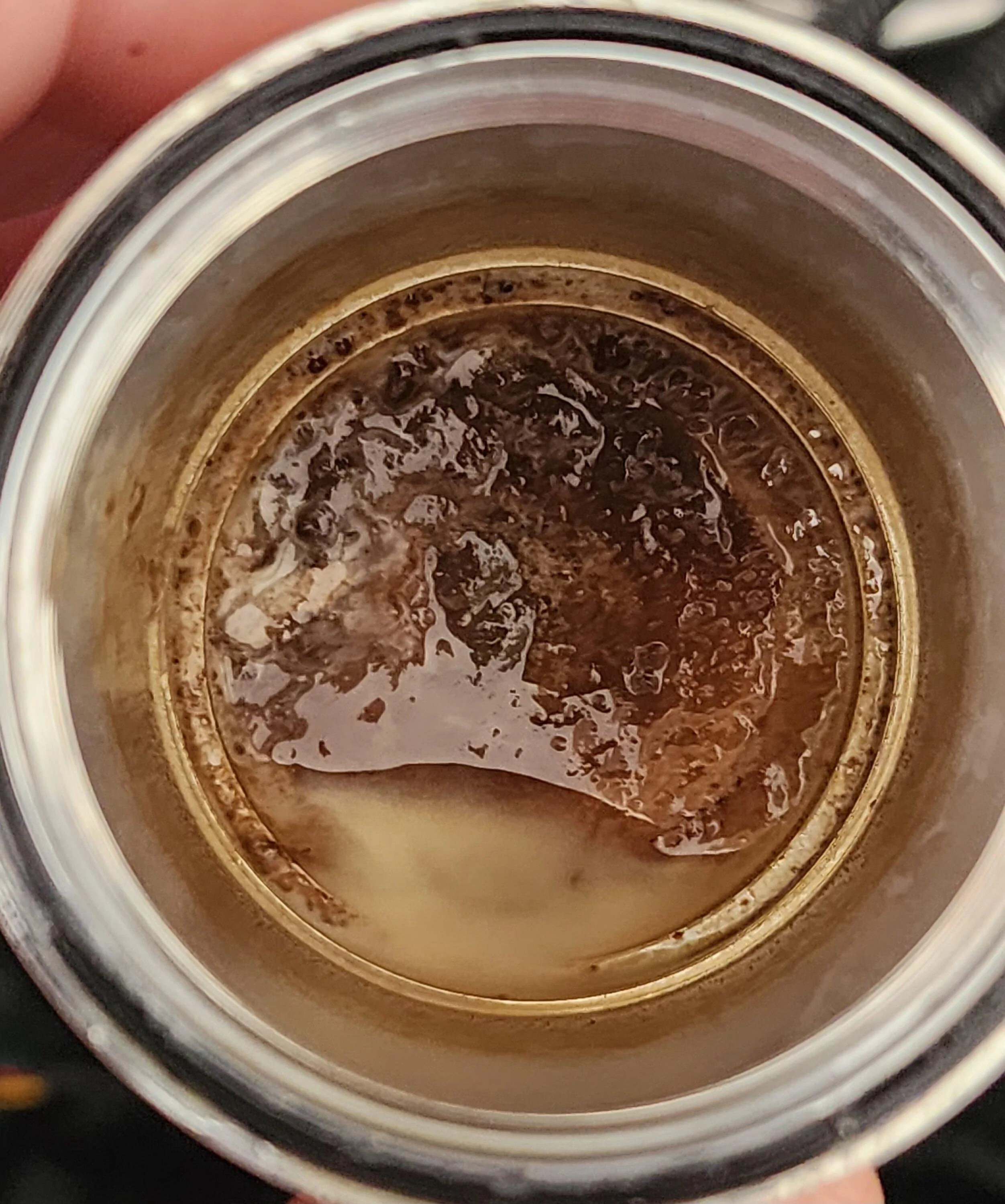

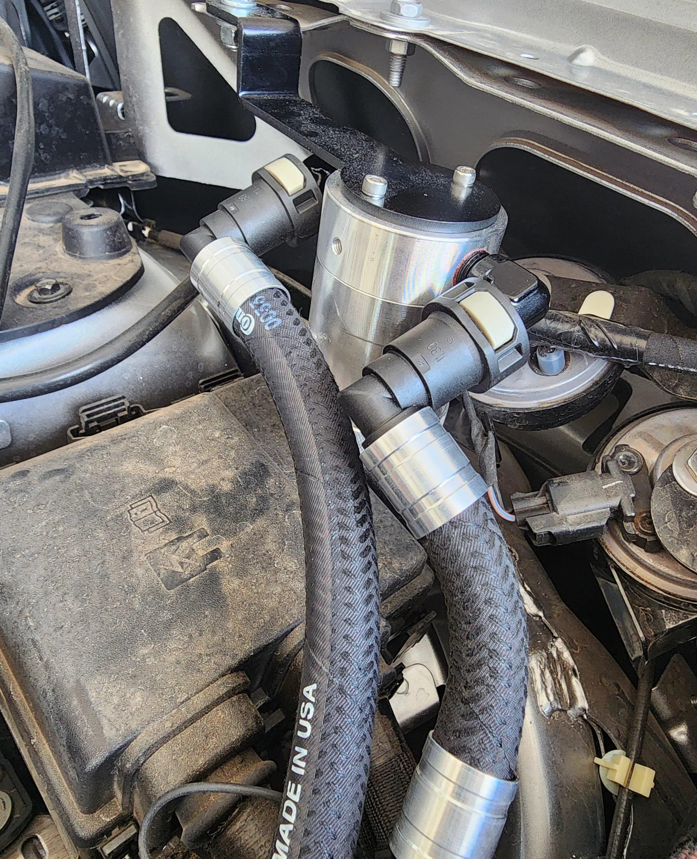

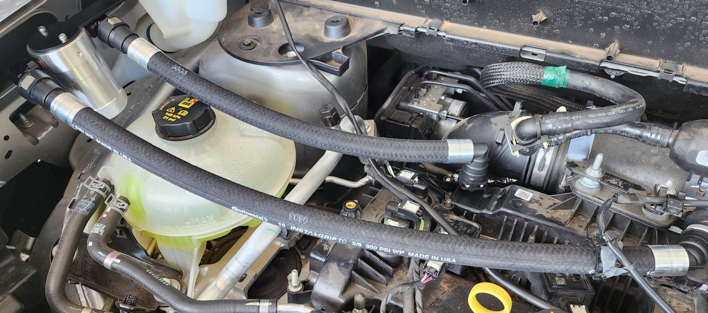

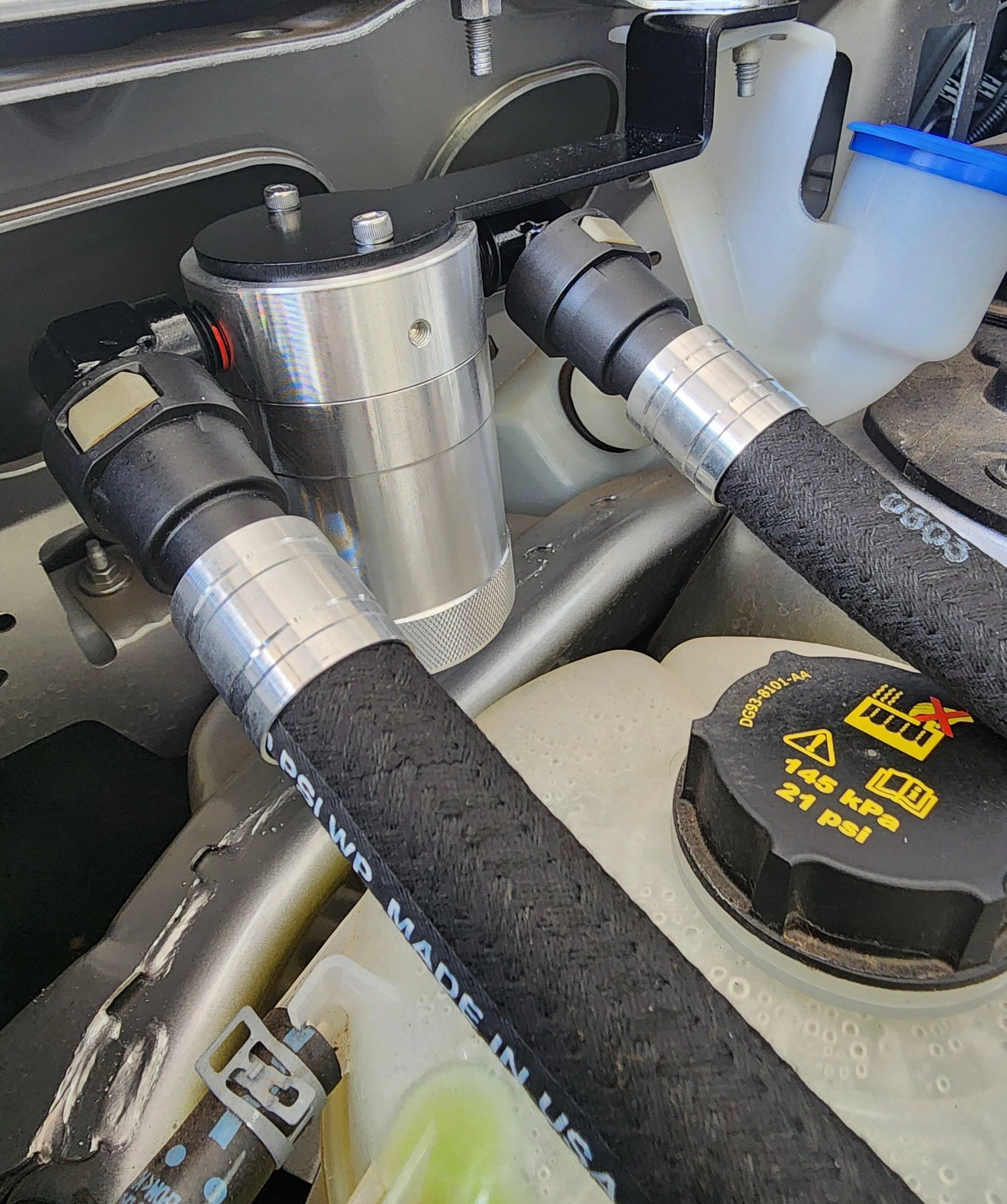

Did my second oil change today. First oil change was with Castrol Synthetic and Motor Craft filter. This change was done with Royal Purple Synthetic and Motor Craft filter.

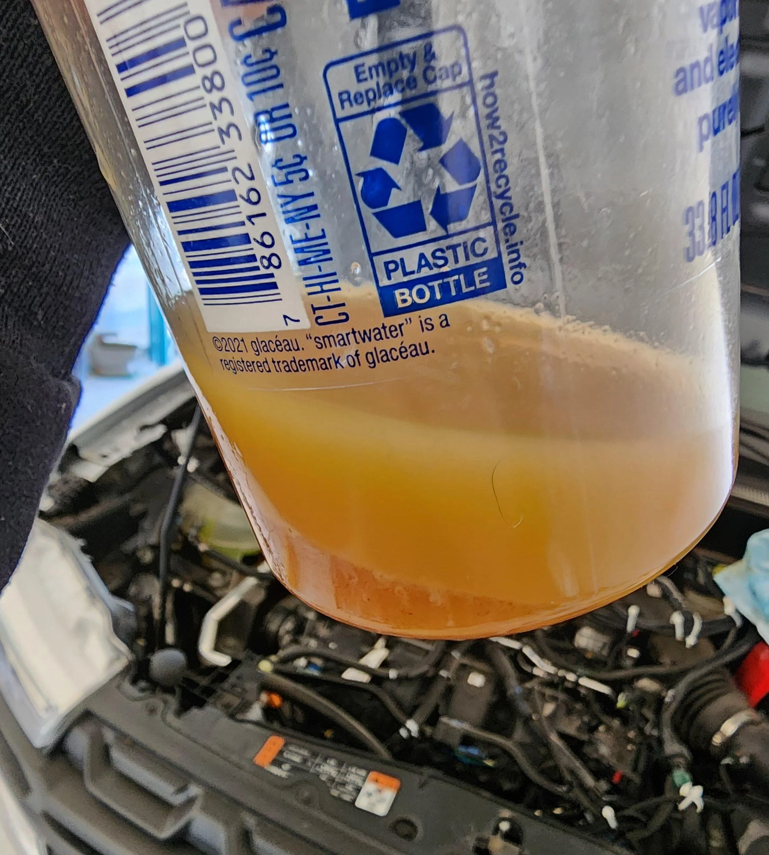

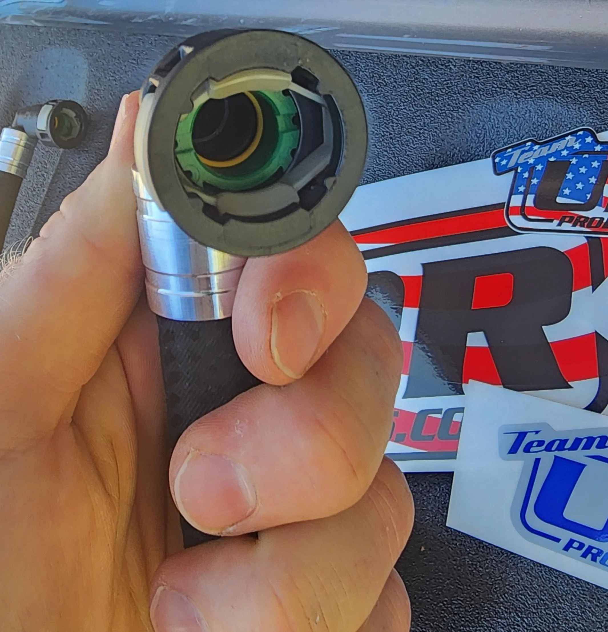

This is the first oil change since the catch cans were installed. Both cans caught more crud than I was expecting. I would recommend a similar setup for anyone else with one of these trucks, if you want to keep it running for a long time.

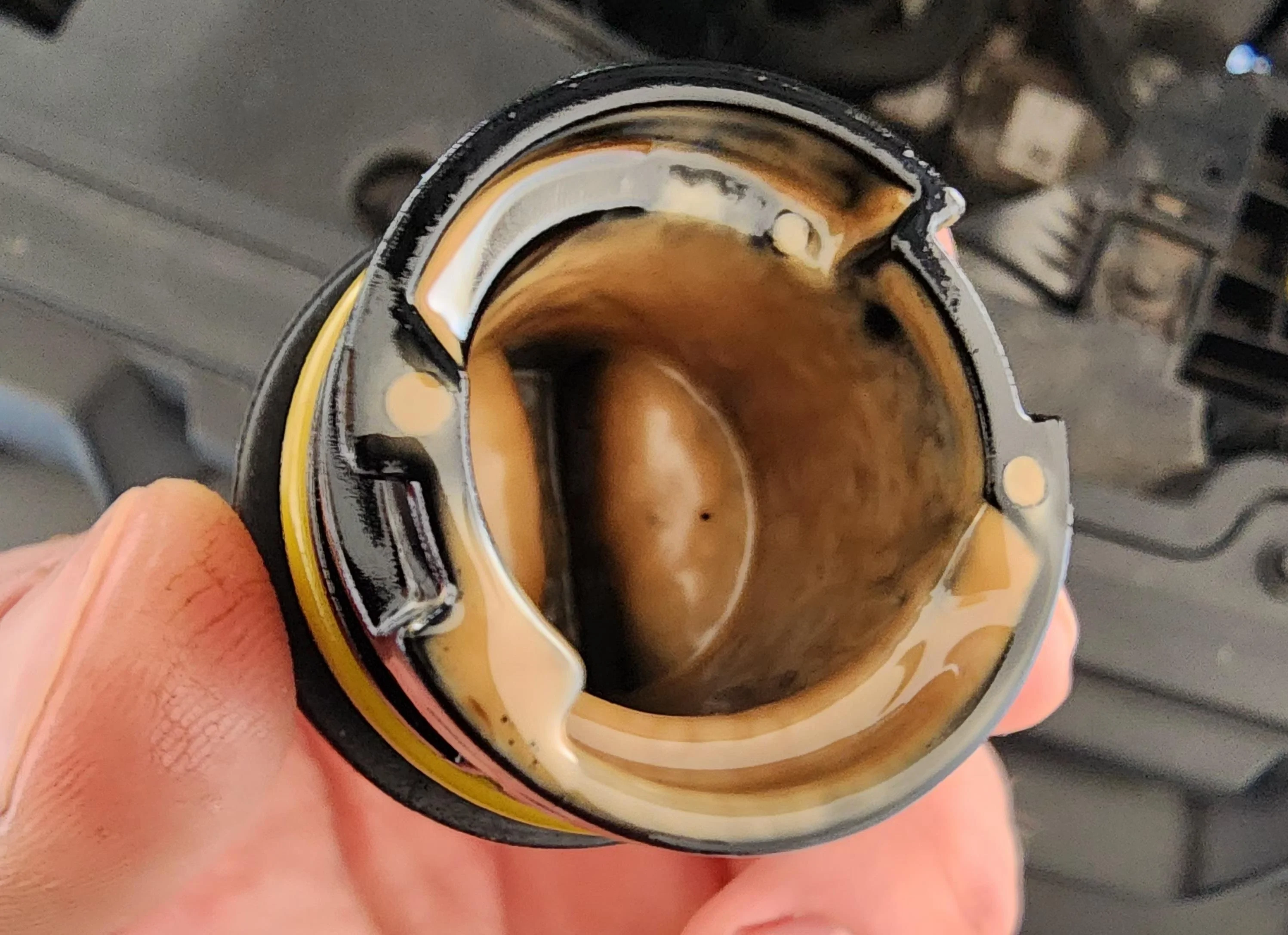

Observation this time was an odor of fuel in the oil. Also noticed sludge on the underside of the oil fill cap.
I plan to keep short intervals for oil changes with this truck. Probably going to stick with 3,500 mile intervals. I have a short commute, and that's hard on motors; More incentive to ride the bicycle. The truck did go on a 3,000 mile road trip just prior to this oil change.
I have a lot more that I'd like to do to the truck, but figured I'd mix up my build thread with a maintenance update.
FYI the truck was showing 42% oil life at this oil change, and mileage on the truck is 7,447.
Catch cans were installed between last oil change and this oil change (before road trip). I will be dumping them every 1,500 miles and every oil change.

Sludge like that under the cap is usually a sign of taking short trips where the engine doesn't heat up enough, so the condensation in the engine never boils off.
That's right. Will likely be putting more miles on the bicycle!
