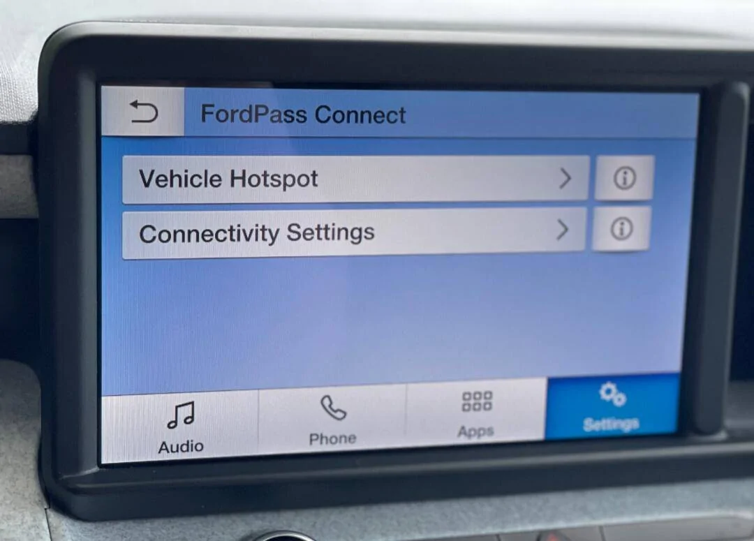

Here's a pic of what I should have. Except the connections settings under the hotspot settings is missing

Ya - that doesn't sound like something disabled.
And ya that reset isn't as bad as I thought it sounded.
Just factory defaults is all.
Which is off, but your option to turn on is gone now.

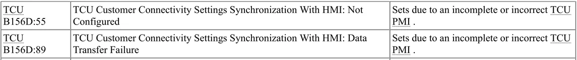

Did you manage to get Connectivity Settings restored and if so do you know the cause ?
I purchased a Fiesta 4 months ago. I've replaced the TCU and ACM and done all sorts of horrible things with Forscan but still no Connectivity Settings and no modem ESN in Sync.
B156D:55-48 TCU Customer Connectivity Settings Synchronisation With HMI.

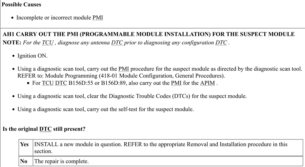

From what I've read in the various Ford forums, some modules will require a PMI "Programmable Module Installation" via Ford's FDRS at the dealer or by using a Mongoose+ for Ford, or another compatible device.
FDRS specifically requires support for the J2534 protocol.
Currently FDRS is subscription based for two days @ $120 and recommended to use a separate email account with Ford other than the one you use with Ford Pass to avoid a complete block of your account.
That can happen if Ford's new AI based cybersecurity thinks something isn't quite right with the login.
Information and Entertainment System - System Operation and Component Description
ACM
The ACM requires PMI when it is replaced.
TCU
The TCU connects the vehicle to a cellular network. It contains a non-serviceable internal SIM card.
The TCU requires PMI when it is replaced.

Open up FDRS
Select TCU from the Module tree.
Select Programmable Module Installation
418-01 Module Configuration Description and Operation 2022 Escape
Procedure revision date: 03/1/2024
Module Configuration - System Operation and Component Description - System Operation
Programmable Module Installation (PMI)
PMI is a scan tool process which configures settings in a new module.
Data used for the PMI process is automatically downloaded from the original module and stored when a scan tool session is started.
If this data cannot be retrieved from the module being replaced, the scan tool may prompt for As-Built data entry or display a list of parameter values that need to be manually selected.
Some modules are reprogrammed during PMI when a strategy/calibration update is available.
It is important the scan tool identifies the vehicle and obtains configuration data prior to removing any modules.
The new module must be able to communicate with the scan tool in order to carry out PMI.
