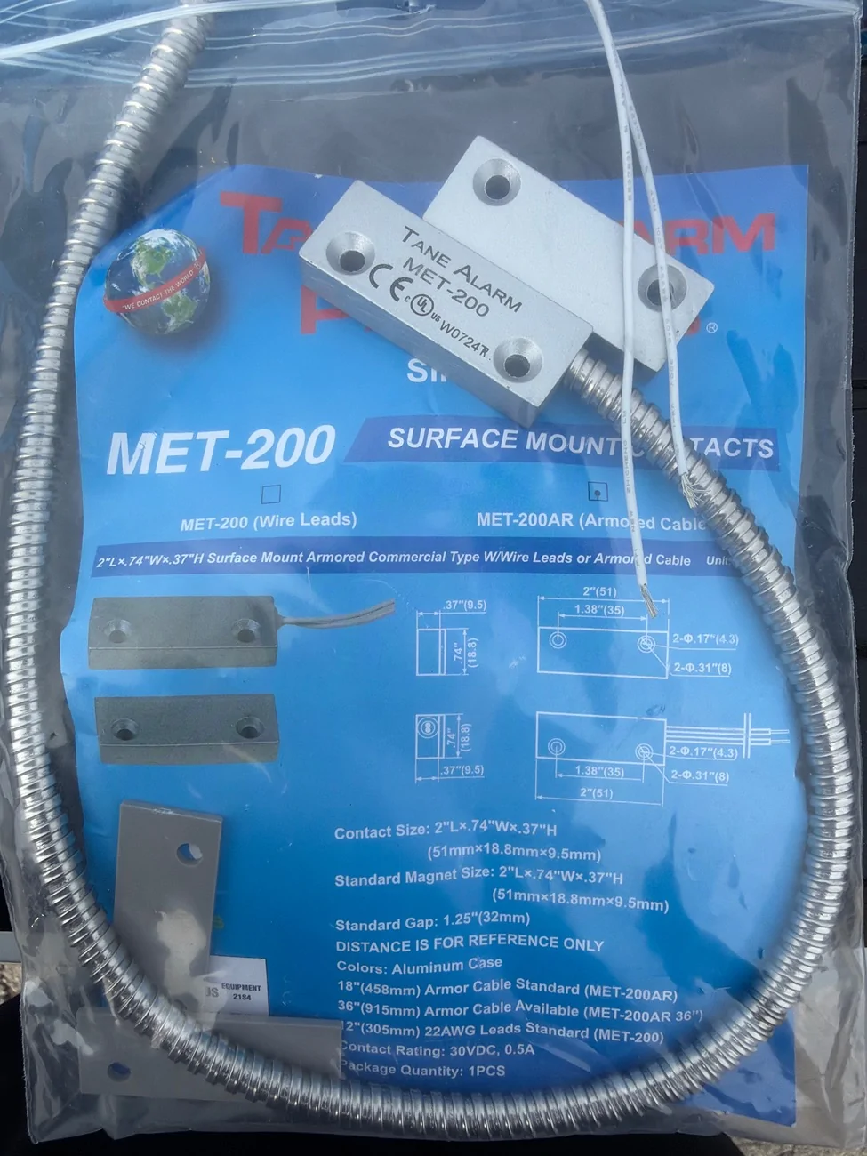

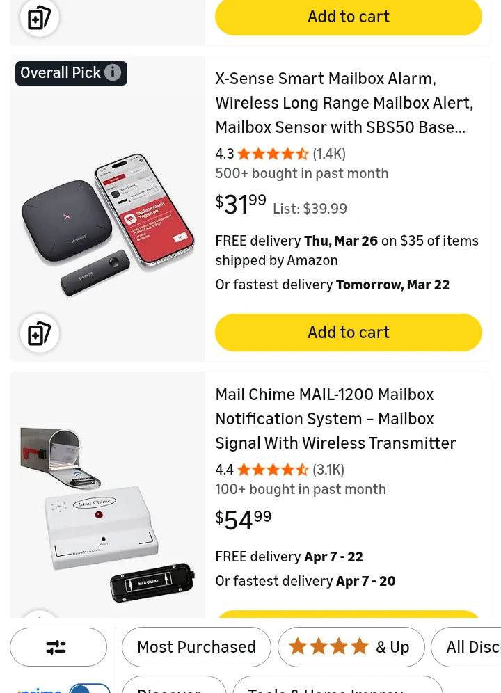

I used this that I stuck on the inside of the tailgate.

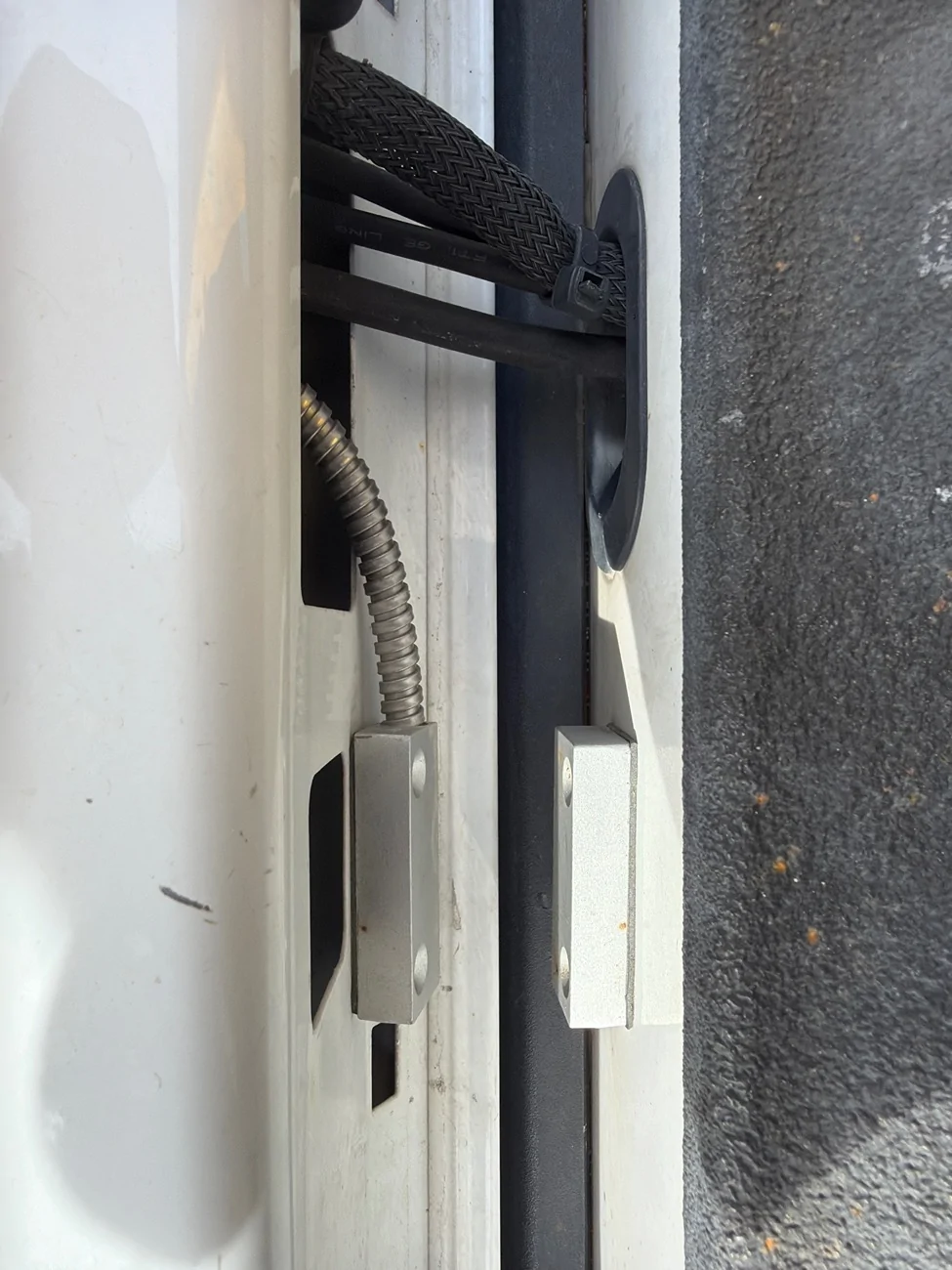

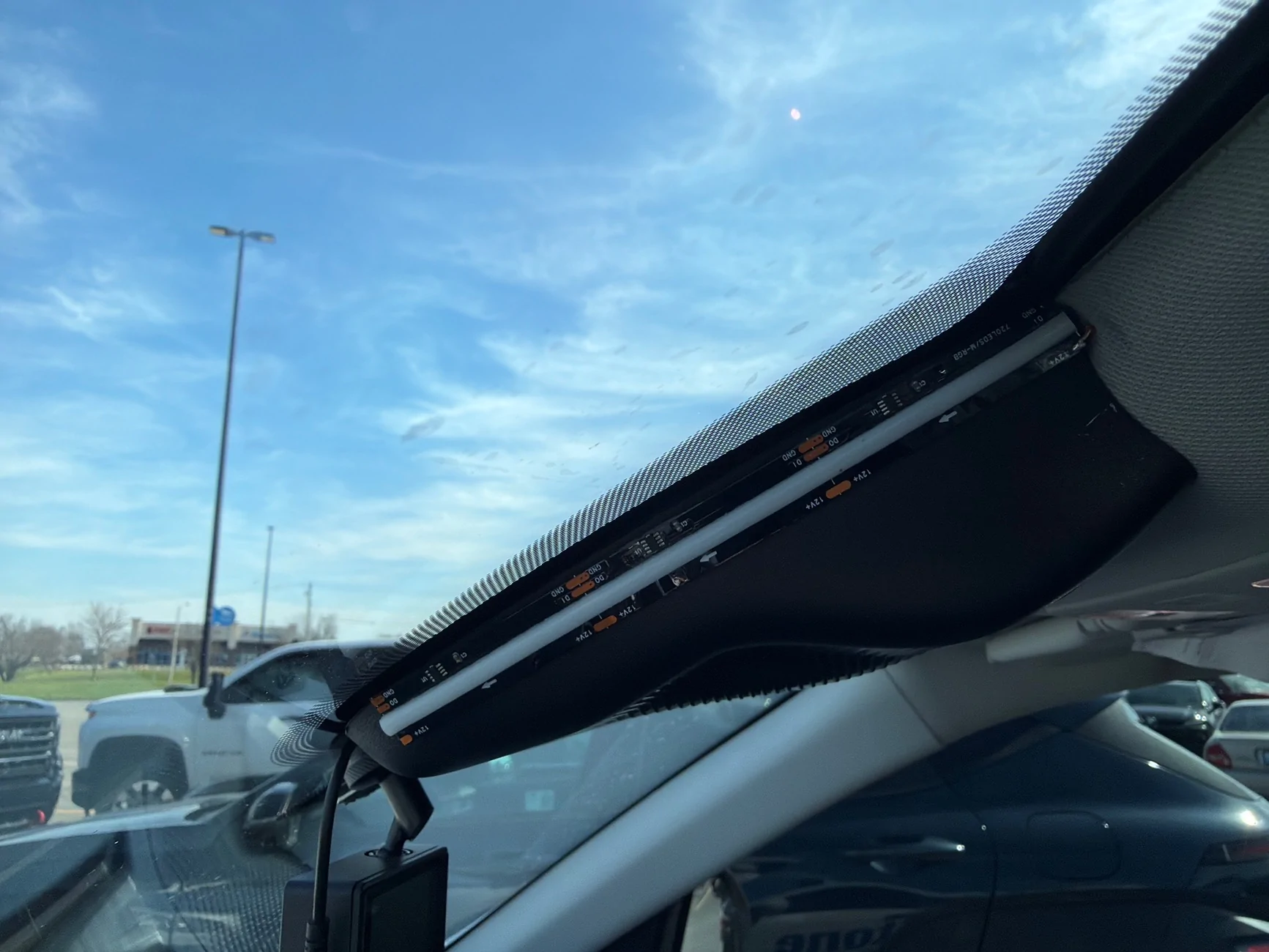

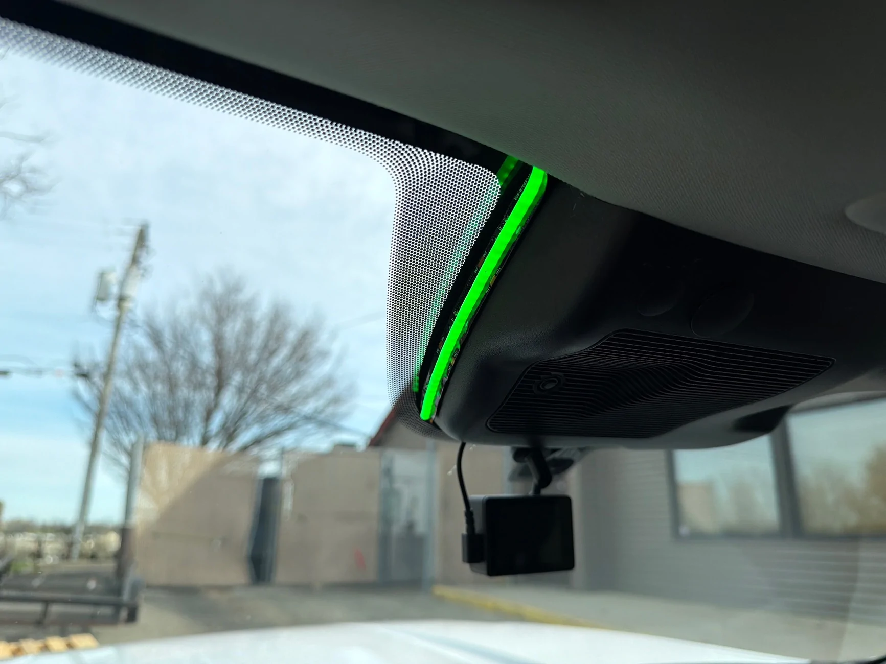

I then ran a cable to the inside and used an LED lamp that would light up when the tailgate is down.
