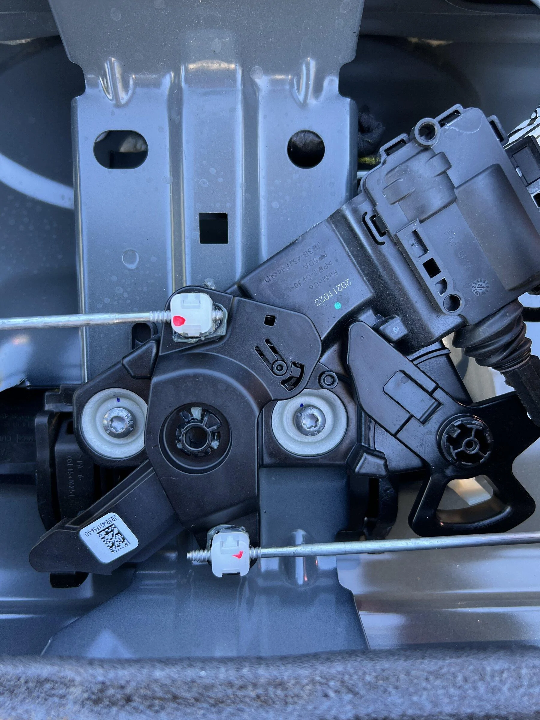

I was able to check out my friends XLT tailgate. Looks like the part number is jb3b431f94ad. However, I'm not able to find much with a quick google search. Part number only shows up in oversea sellers.

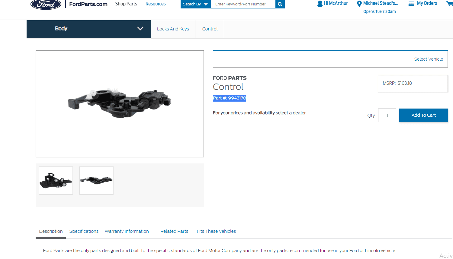

I found the ford part, its called the controler Part #: 9943170 But there is no wiring. I called ford but its still so new so they dont have any info. Does anyone know what the wiring is I hope its plug and play right in the tailgate so I dont have to run wiring all over the place.
https://parts.ford.com/shop/en/us/body/locks-and-keys/control-9343503-1#/partMatched
MTC member XLAZNDrvr added a Ranger tailgate power lock on his XL and posted this thread: https://www.mavericktruckclub.com/f...ock-using-control-actuator-from-ranger.10354/

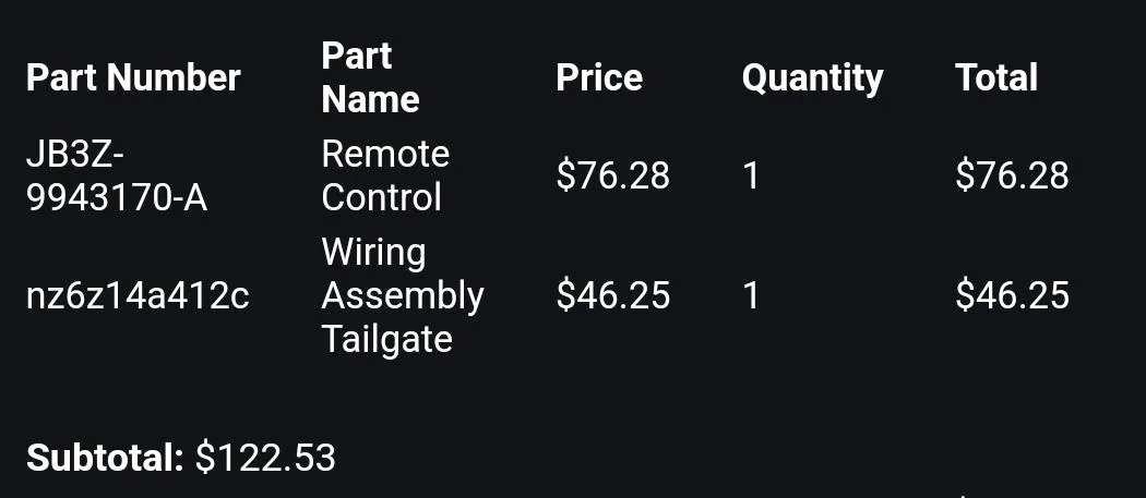

I ordered these two from Tascaparts. It was super easy and took me 15 minutes. All you have to do is replace the XL factory harness located above the spare tire and remove the tailgate panel. Then, remove the manual lock and replace it with the remote control lock. Finally, connect the remote control lock to the new harness.
I should have taken some photos, but I found a YouTube video that I followed.
