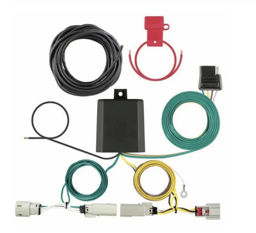

No issues with the physical install yet when I attempt to connect to the existing 4 prong- the light bar acts as a parallel current path- and makes the Mav think the rear lights and blinkers are broken.
Anyone have advice? where to splice in?

you can't really just splice -- on the maverick the turn signals and brakes are combined, you need something to separate them -- tailgate led bars don't seem to be too popular on here, so you may have to just throw parts at it until you find one that works.
Something like this
https://digi-tails.com/digi-tails-taillight-signal-separator-module

I don't think it's a simple splice when you're dealing with LED.
