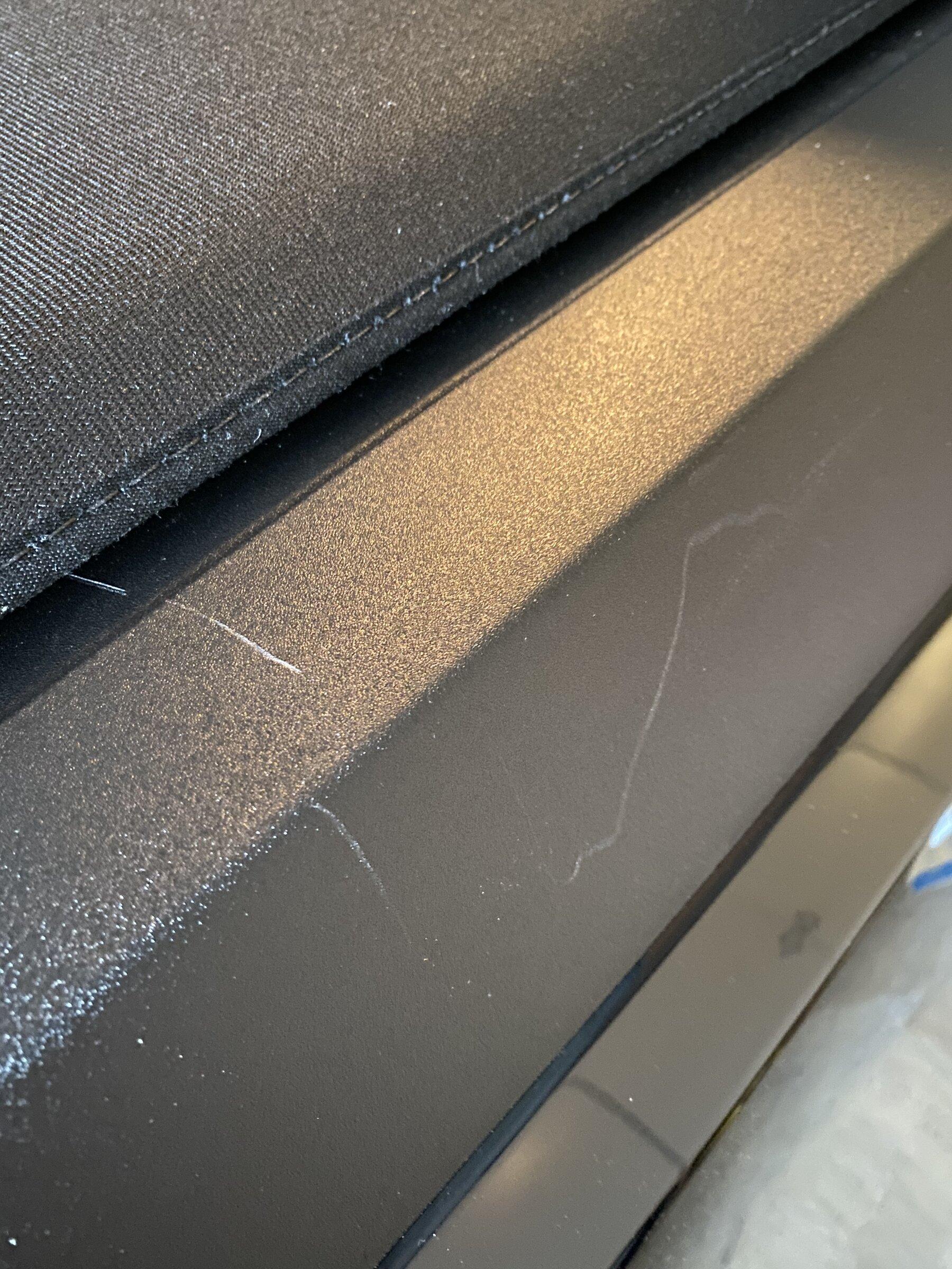

One week in and I already put some heavy scratches into the plastic around my bed. While the scratches on the side are more superficial, the scratches on the top are pretty deep. I think it happened during the installation of the bed cover. Any idea how I can get those scratches out without any bigger damage to the whole plastic trim?
Man, I feel for ya...that first scratch, especially if it's self-inflicted, can really ruin your day.
I have a new hardtop cover for the bed to install, and it didn't occur to me that I could scratch the bed trim like this...I'm thinking about ways to protect it during the process, maybe something simple like painter's tape...thanks for making me aware of the issue before it happens to me, too!

For future reference, here's what you should use to cover up scuffs like this :
SEM Texture Coat + Trim Black
https://semproducts.com/product/texture-coating#product-details
https://semproducts.com/product/trim-black/black#product-details
Procedure explained :
This isn't worth doing on a $50 part IMO, but it's worth it if you have large parts or many parts to fix
That turned out good. However, the very first step needs to be to clean the plastic with something like Prep-Sol. That paint is going to peel off in no time.
