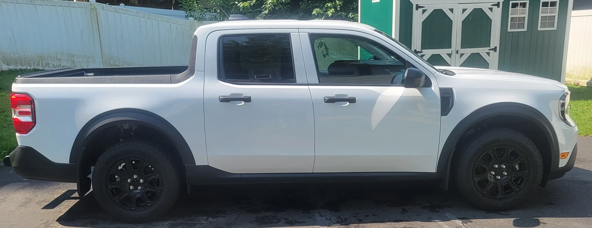

Things I learned when swapping wheels on my 2026 XL.
  • 25+ model year went to a new TPMS sensor from prior years. So any take offs that have a TPMS sensor, you will need to find out what year they came off of as you may not need to swap in your own TPMS sensor.
  • Any year Maverick wheel will swap in with the caveat as mentioned of the TPMS sensors
  • Any year Bronco Sport wheel will also swap in and they changed TPMS sensors in 2025+ also.
I eventually found a set of 2026 Bronco Sport Badlands like new take offs with TPMS sensors that was plug and play. I did have to buy a set of 14mm thread size capped lug nuts.

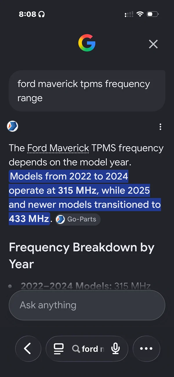

If I use the Bronco Sports wheels would the tire pressure sensors swap over or do I need new ones?
Velocity67
May 28, 2026
AZ
‘26 Maverick XL
Ford went to a different frequency in 2025 on their TPMS.

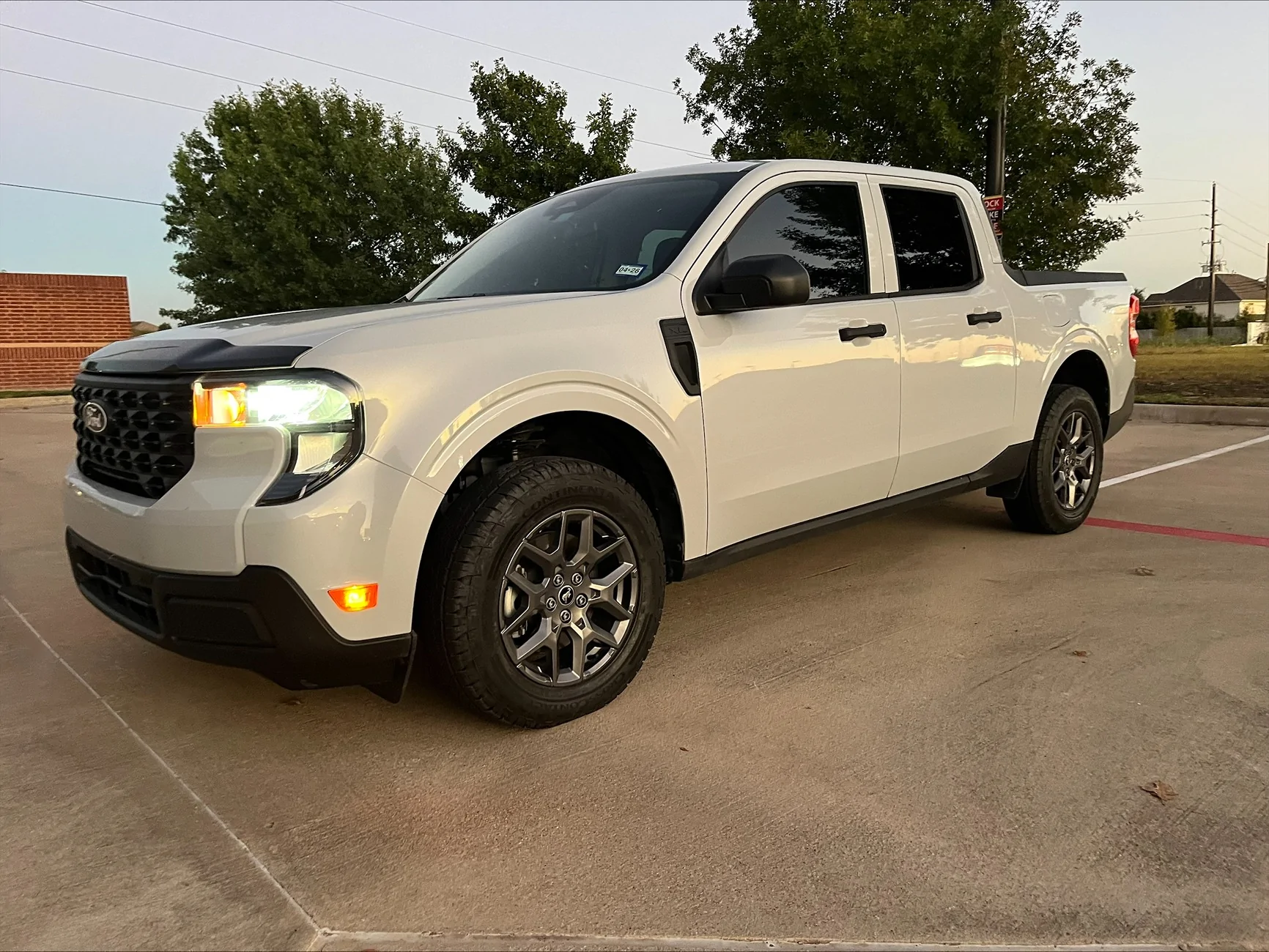

Manollo3
Mario
Apr 1, 2025
428
666
South East Texas
Jeep Wrangler, Honda Africa Twin, TW200, 2025 XL Hybrid, AWD, 4K
Just use the TPMS sensor you currently have in yours. I bought some brand-new take offs from a 2025 Ford Bronco but they did not come with the sensors. I could live with that as I only paid 500 bucks for the rims and tires. Still have the original XL rims/tires and need to swap the sensors over. It is like $ 100.00 at Tire Discount.
