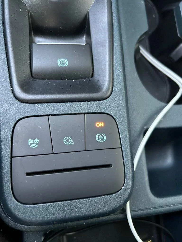

If Auto Hold is turned on, try turning it OFF. The button is on the center console, near the Parking Brake. There is also a green icon like this one, on the Instrument Cluster, to indicate if it's enabled.
Ford Maverick Surge from stopped position. Has anyone had this? Screenshot from 2024-05-01 11-07-46
More info on this feature in your User Manual.

You were 100% correct. The Truck is finally back from Ford. Ford could not figure out what was happening, we will call them tomorrow. We needed oil change and and a few other things so it had to go into the shop anyway.
I asked my wife if the "auto hold" was on, she said yes. Then I asked her to turn it off and test drive the car. The surge is gone.
Now, I know it was not a "surge" just the normal "Auto Hold" function.
Our Maverick works like a dream. Thank you so very much for this fix. My daughter loves that truck.
