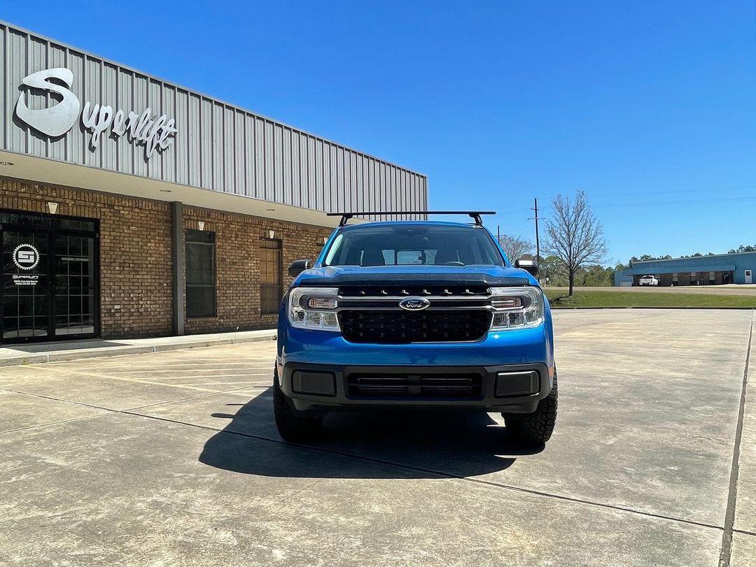

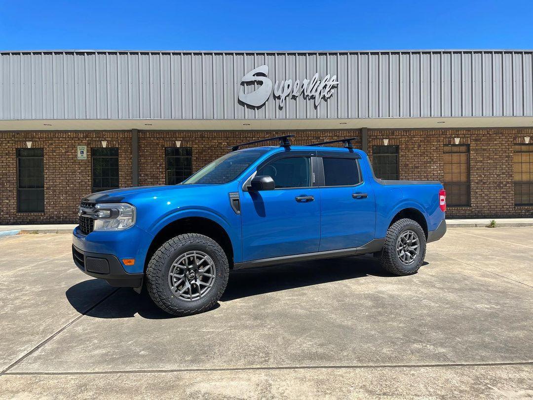

How high do you wanna get?I’ll continue to wait for the 34 inch lift

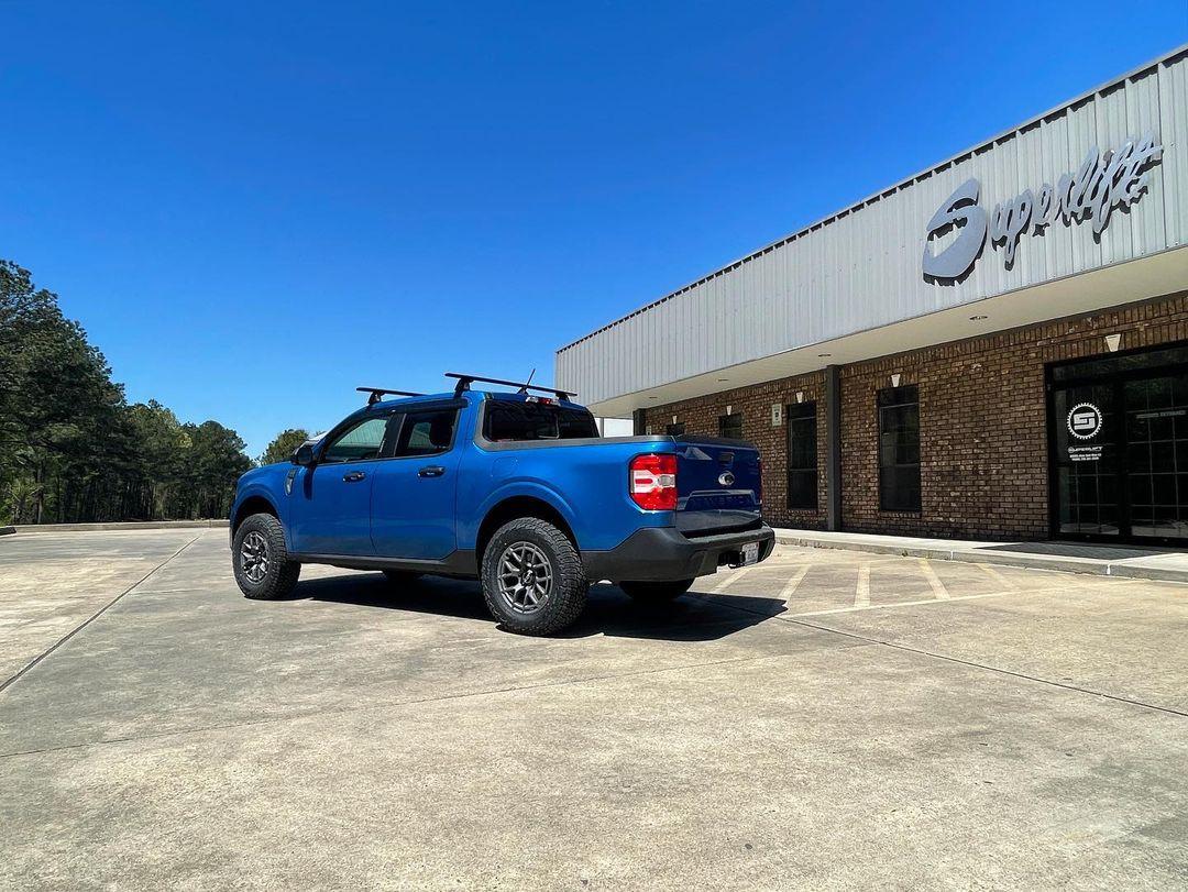

There is already a fix for that on the 2" lifts. I also plan on fabricating a better rear radius arm to combat that aswell. Im hoping Super lift has found a way to drop the front subframe and motor 0.5" that should take care of the CVs with this much lift.I noticed the lack of a full on side view. I bet that rear tire is super close to the corner of the door-side wheel well. That's already an issue with the 2in lifts and it's super ugly.
That's awesome to hear. It was one of the major hangups for me. Can't wait to see the aftermarket grow for the Mav.There is already a fix for that on the 2" lifts. I also plan on fabricating a better rear radius arm to combat that aswell. Im hoping Super lift has found a way to drop the front subframe and motor 0.5" that should take care of the CVs with this much lift.
I really hope it clears 31x10.50r17s. That would simplify my life so much.
One of the kits has a correction for that that keeps it mostly inline, cant remember which, but the real solution will be a slightly modified radius arm. Once I get mine and one OEM arms are available I will work on the stock ones and try to make a simple template people can follow to just cut, plate, and weld additional metal to it. The idea is to drop it and shift it to account for the changed position of the lower control arm and just end up with the stock position relative to each other. Since its just stamped plate and not overly complex and shapely like a A-arm often is it will be pretty simple. Someone will probably beat me to it though since Im a January order.That's awesome to hear. It was one of the major hangups for me. Can't wait to see the aftermarket grow for the Mav.
I can hear the CV’s crying through my phone, lol!
No response from them yet.Can anyone with instagram find out what size tires those are?
