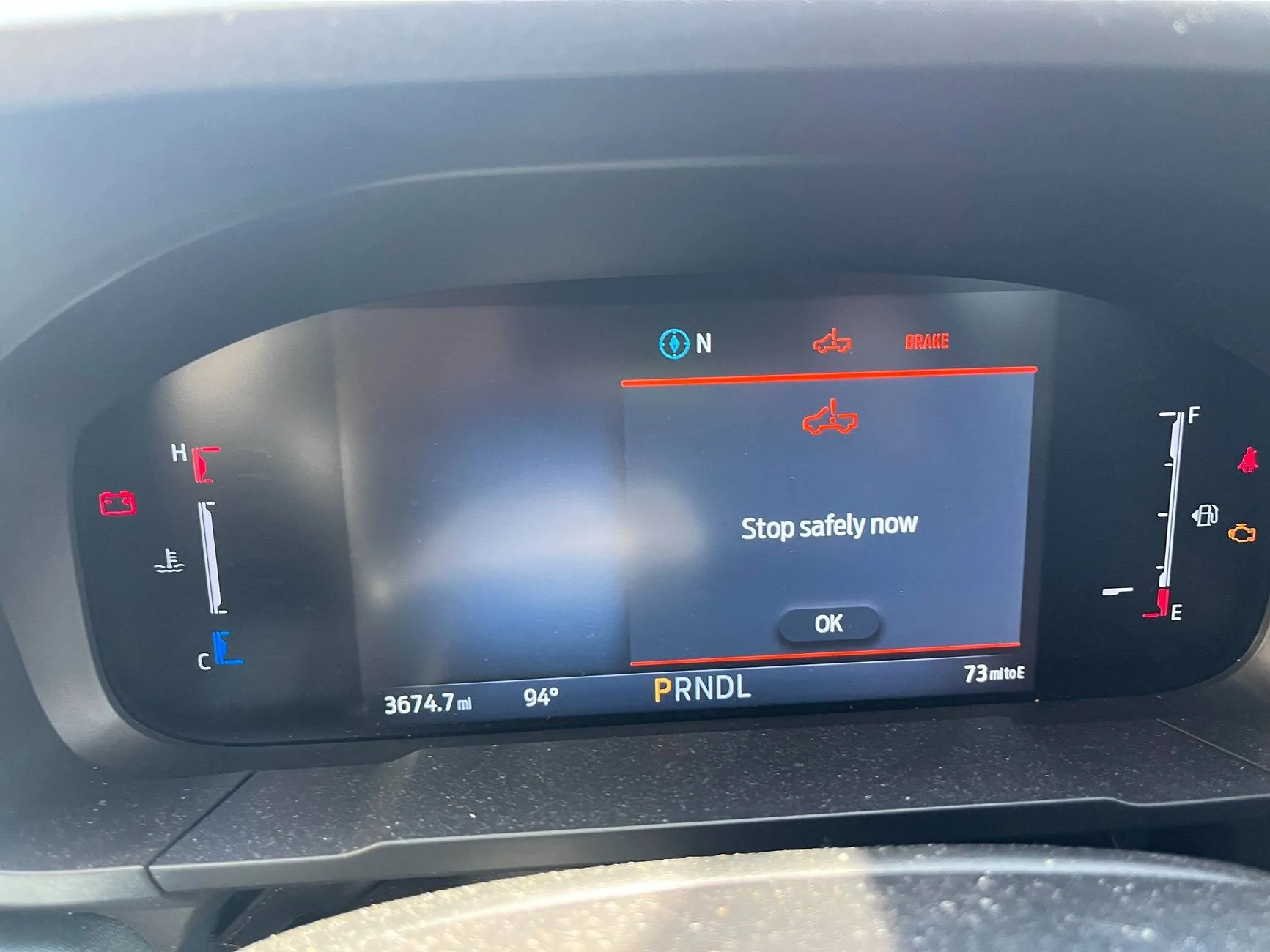

I have a 2025 Ford Maverick and get a dashboard 'Stop Safely Now' message occasionally (5 times in 4 months). When this occurs, the truck will not start. I continue to get this error code for typically 5-10 minutes and then the truck starts.
Ford Maverick 'Stop Safely Now' Dashboard Message June 2025 Ford Maverick Error Cod
The dealership has looked at it 3 times and hasn't been able to determine the cause. Has anyone else gotten this error? Thanks

I got that message once when driving on an interstate in my 24 Lariat. It happened as my passenger was fussing with some controls. I believe that he either touched the on/off switch, or maybe moved the gear shifter. I pulled over and then the truck started right up.
Did you get any resolution to this issue? I was attempting the TPMS relearn process using the brake and ignition switch and am now locked out with this message. I pulled the battery terminal and will see if that resets it. I am guessing it is brake related. MY24 Hybrid XL.
UPDATE; Battery disconnect did reset the issue. All good again except TPMS still not working.
