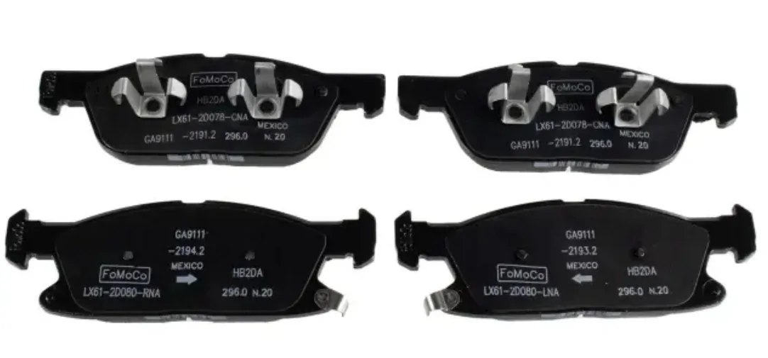

The front pads that fit the Euro Ford Focus MK4 ST 2019-2022 are the ones that fit our Lobo.
Also OEM Ford BRF1908 are correct for the 2025 Lobo (w/enhanced brakes) and 2021-2025 Lincoln Corsair Grand Touring. Interesting that Lobo brake engineers chose a pad material from the Lincoln parts bin for a Lincoln hybrid. That tells me they were maximizing quiet and low dust over performance.

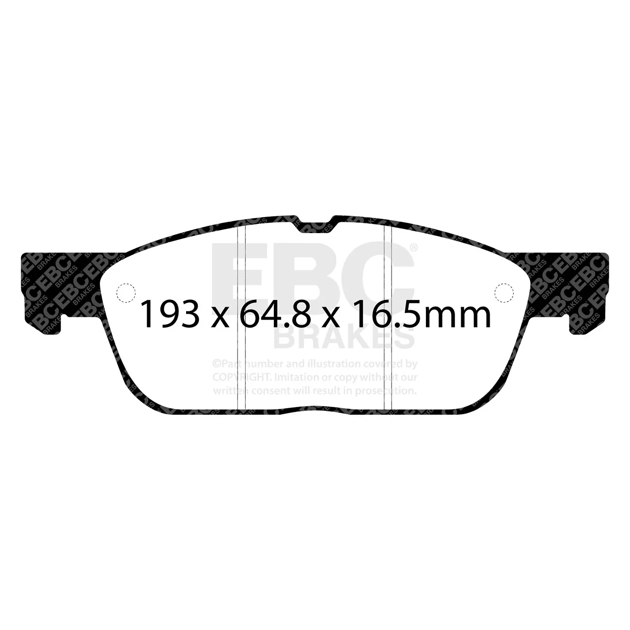

EBC Yellowstuff DP42383R 193.0mm x 64.8mm x 16.5mm eBay $200 + Int'l shipping.
EBC Bluestuff DP52383NDX 193.0mm x 64.8mm x 16.5mm eBay $210 + Int'l shipping.
I purchased the Bluestuff DP52383NDX from a UK eBay retailer. It took them almost a month to clear customs and arrive. I can verify they are the correct size. My micrometer says they are actually a little over 17mm thick.

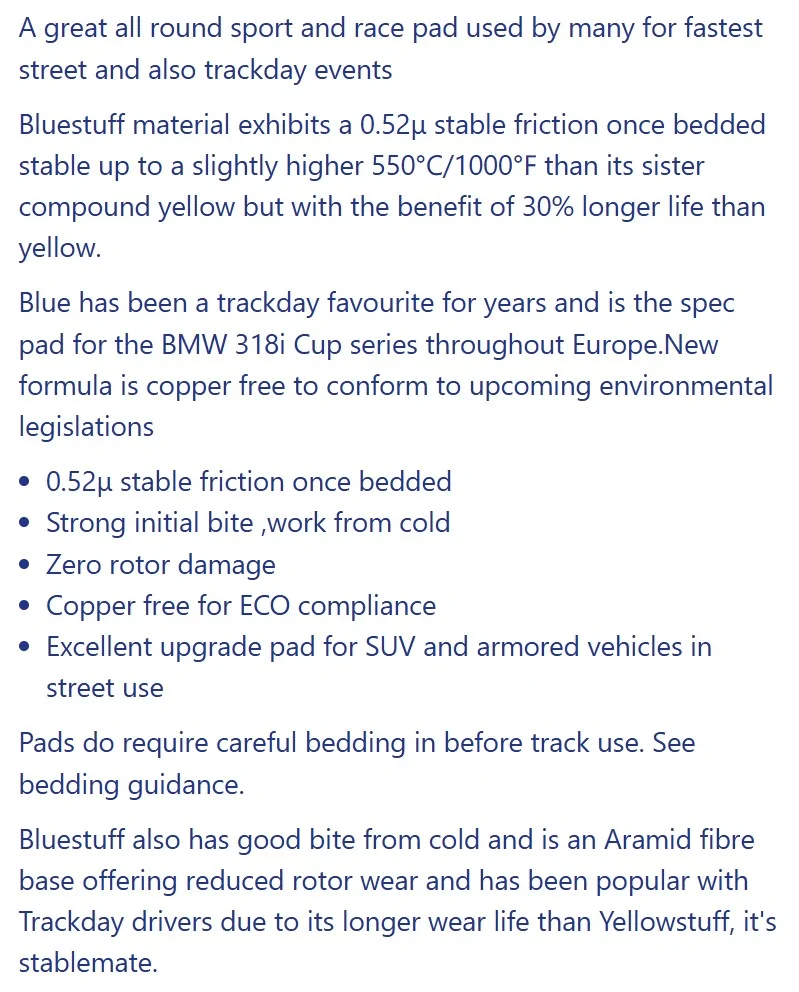

About EBC Pads:

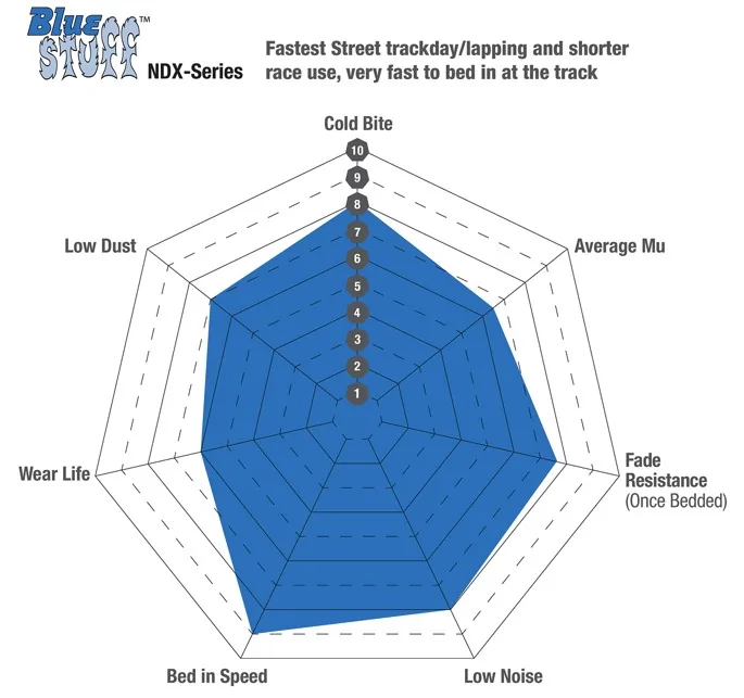

EBC Bluestuff: Highest-performing road-legal material
20% longer life than YellowStuff
Faster Bed in Speed than Yellowstuff
Friction = 0.45 Temp range = 0-625°C
Bluestuff is the spec pad for Euro BMW Cup races.

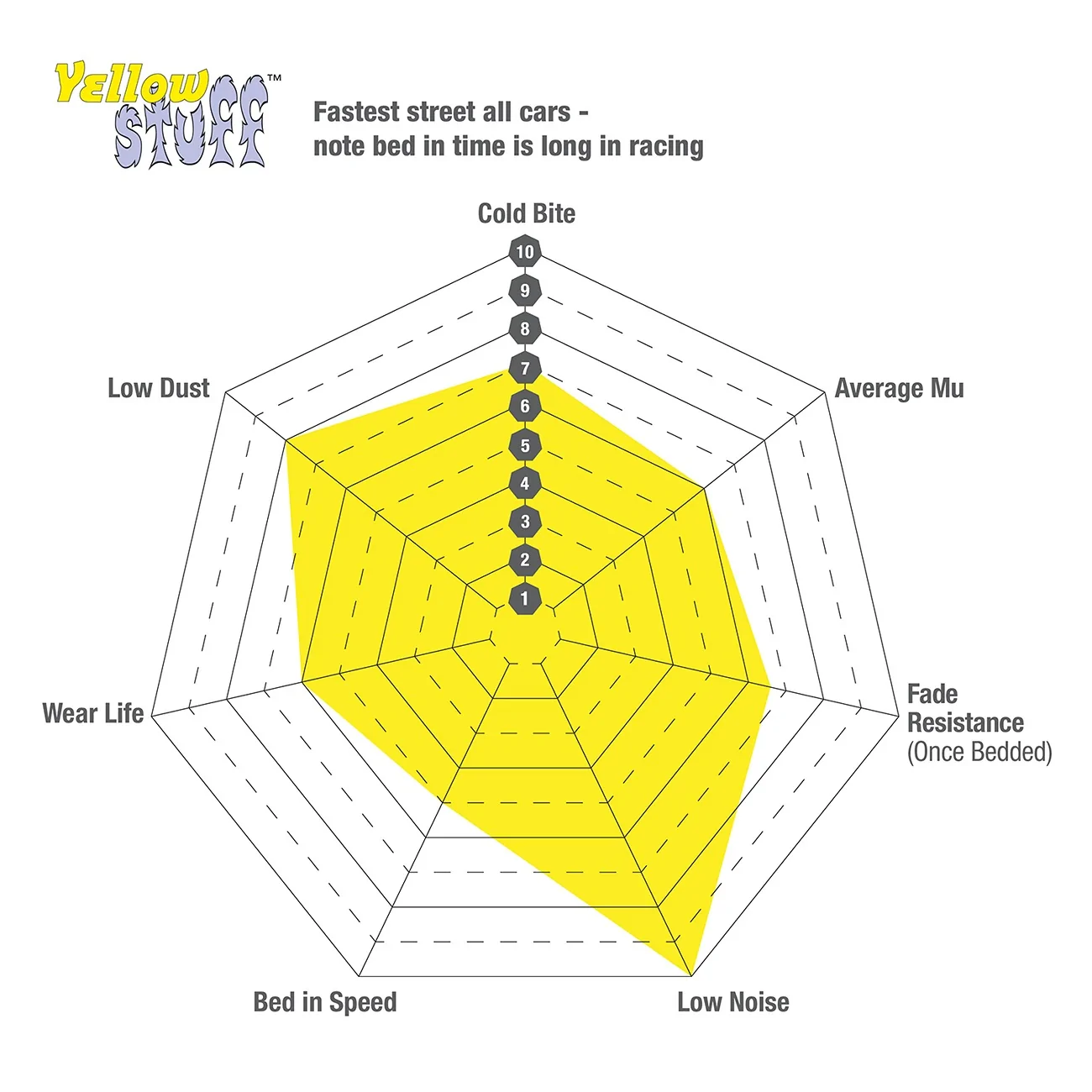

EBC Yellowstuff: Flagship fast road and light track material
Progressive braking with excellent pedal feel
Friction = 0.42 Temp range = 0-500°C

We'll see how the ABS copes with the EBC Bluestuff front pads and OEM rear pads. I may have to put Yellowstuff pads on the rear. No plans on swapping for performance rotors yet.
Ford Maverick Sport & Track Lobo Brake Pads & Rotors Bluestuff Spider small
Ford Maverick Sport & Track Lobo Brake Pads & Rotors EBC Bluestuff DP52383NDX Description
Ford Maverick Sport & Track Lobo Brake Pads & Rotors EBC Brake Pads
Ford Maverick Sport & Track Lobo Brake Pads & Rotors OEM Ford Part BRF1908
Ford Maverick Sport & Track Lobo Brake Pads & Rotors EBC Bluestuff DP52383NDX Dimensions
Ford Maverick Sport & Track Lobo Brake Pads & Rotors EBC Yellowstuff DP42383R Spider Graph
