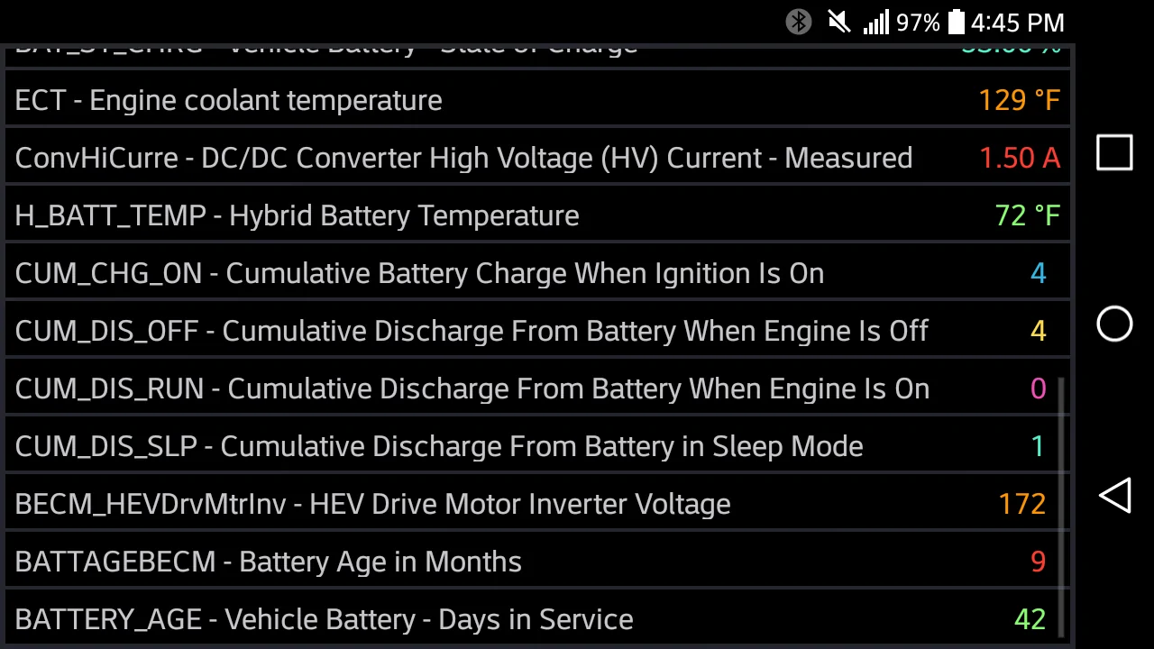

I wouldn't worry about the BMS logging your charging - there is nothing to log it too.
So just use what's easy to do.
There are only 4 categories of tracking for the BMS - there is only one for charging.
Therefore external charging is never tracked to update any figures to do anything with.
The next BMS Relearn it does, will see the full battery. Hopefully.
I've tested this on 2 full recharges - the Ah's were never seen.
Below pic was 42 days after a BS Reset after a full charge, which did nothing but Zero out the figures related.
I did another full charge right before this screenshot, because the system log clicked over to slightly more discharge than charge, which would maybe explain the falling SOC and Voltage readings after a full recharge 42 days prior.

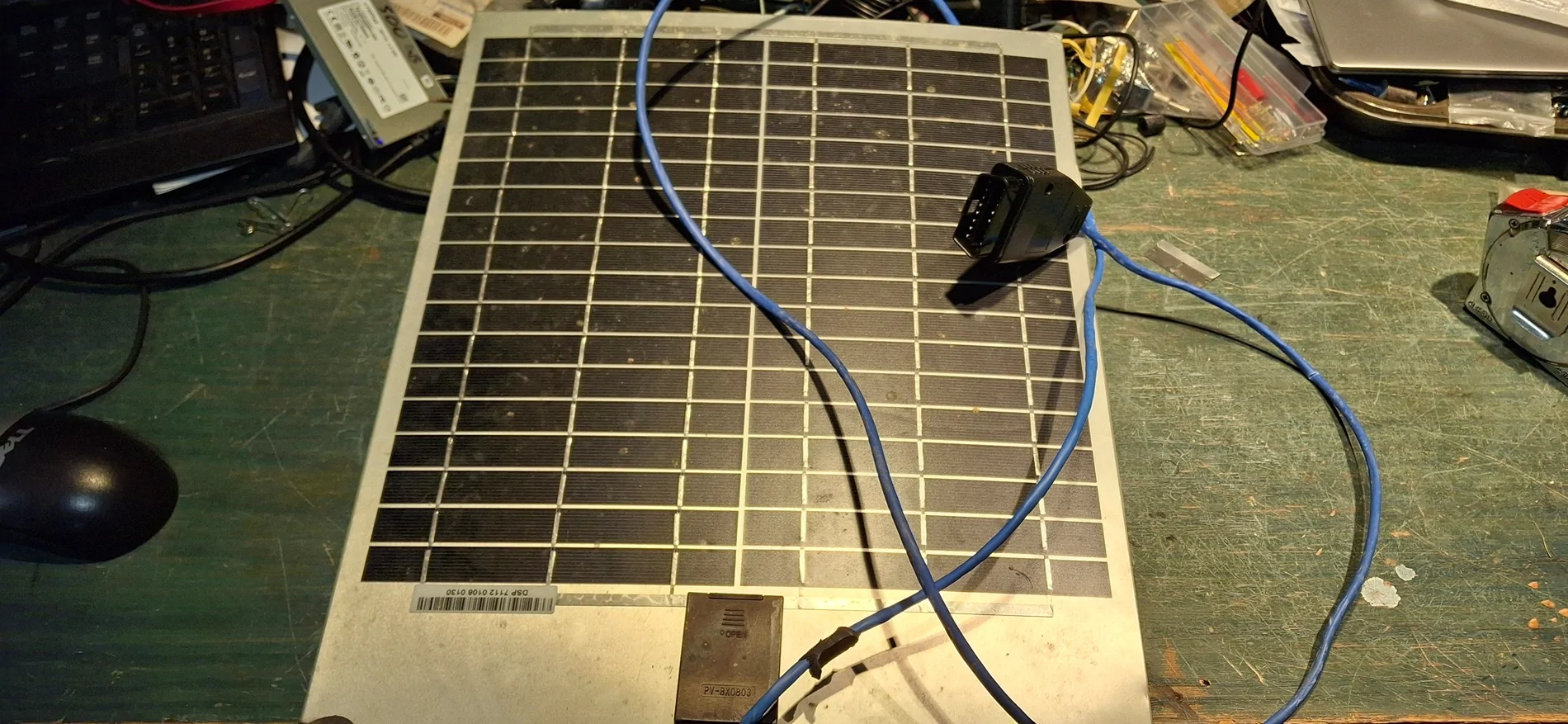

A few years ago I made 3 of them when I worked at a dealer, batteries were going dead when they installed tracking devices so I came up with this.
15W solar panel with an OBD2 connector connected with cheap cat5 cable.
Worked great but the dealer was too cheap to buy in bulk.
Each one was about $30 to put together but in their ultimate wisdom they thought buying batteries was cheaper than buying a few hundred panels
