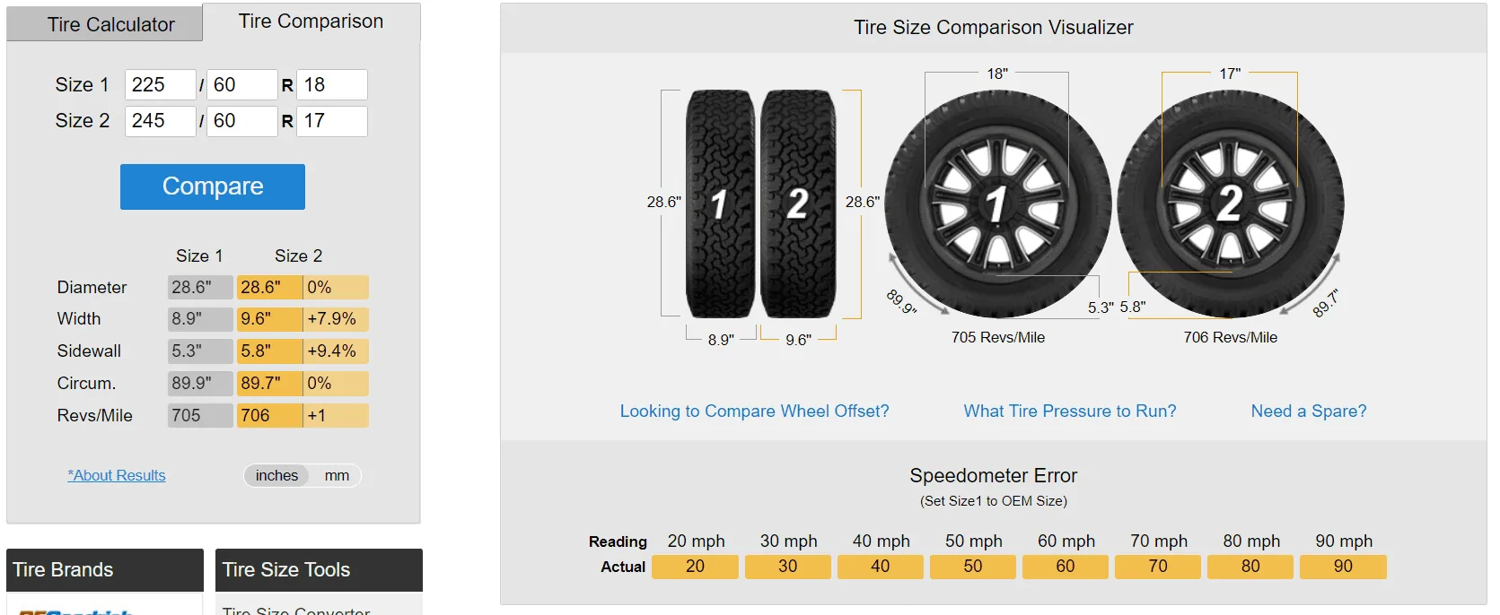

225/60/18 is the same height as 245/65/17. Width doesn't attribute as much to something like this as you are assuming unless it's on an offset that puts the tire further under the wheel well, and that rarely happens. It's still pretty centered all things considered. Half an inch isn't going to be the make or break all in radius' when slush is that bad. It's likely going to happen anyways.

I never had that problem on the Maverick but I did on my Escape. We have not had much snow this year but I have driven through the thick of it. I also have 245/65R17's on the Maverick. My Escape had stock tires on 19's and it was terrible to the point where I had to stop at the car wash almost daily sometimes during winter. Ice would also build up on the underbody and caused a flapping of those composite panels that shield the underbody. Something must've broken those plastic retainer clips and it was a nightmare to fix. I didn't order a new part but I did mend it and it became clear the design was very poorly thought over. I also had the same issue on a previous Subaru Crosstrek. So it's really got nothing to do with the tire size. Now if you went up a level that you could not even turn the wheels... then duh. But there is more than enough space for 245's on the Mavericks. Anything beyond that is overkill.
Sometimes slush is just that level of sticky and it happens for most vehicles on the road.
